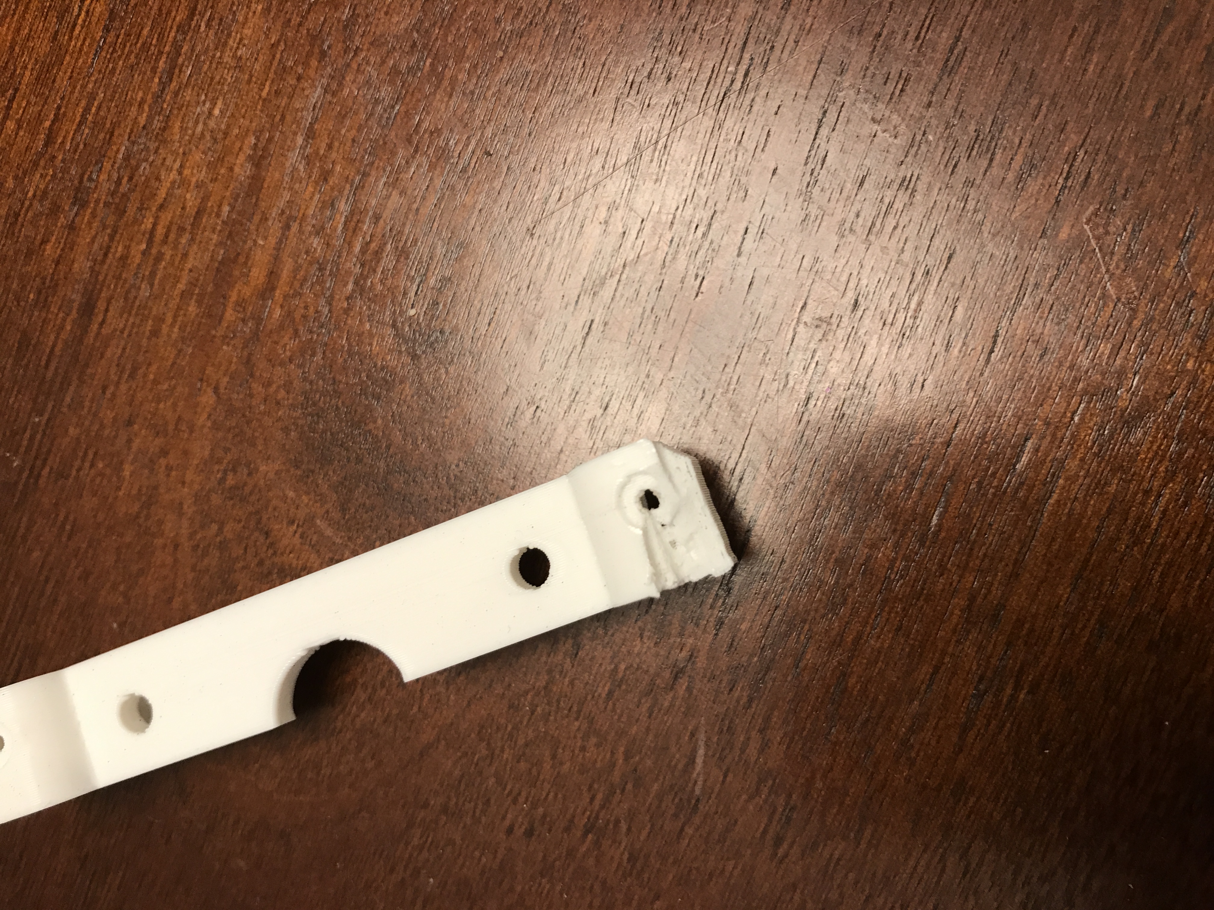

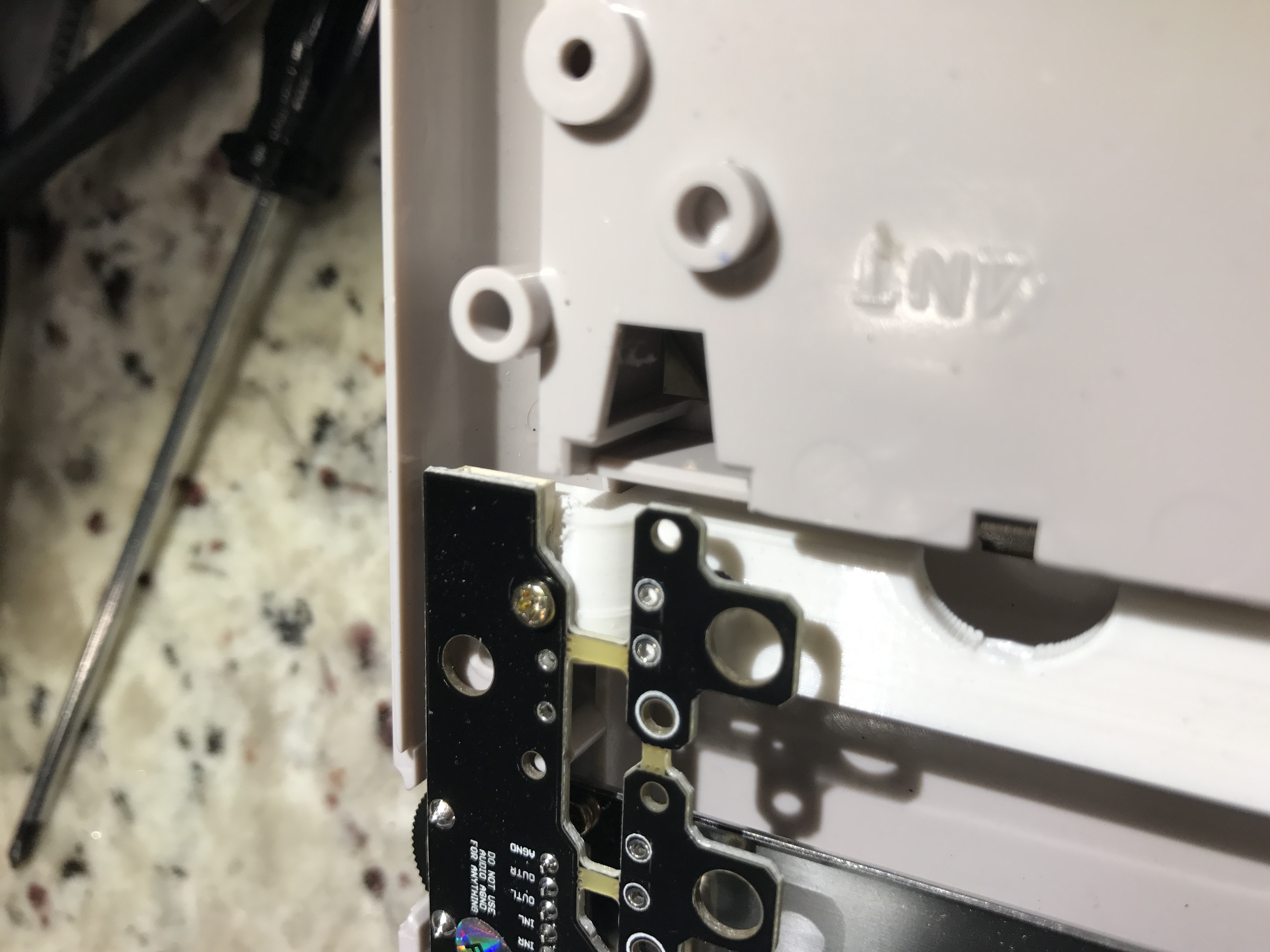

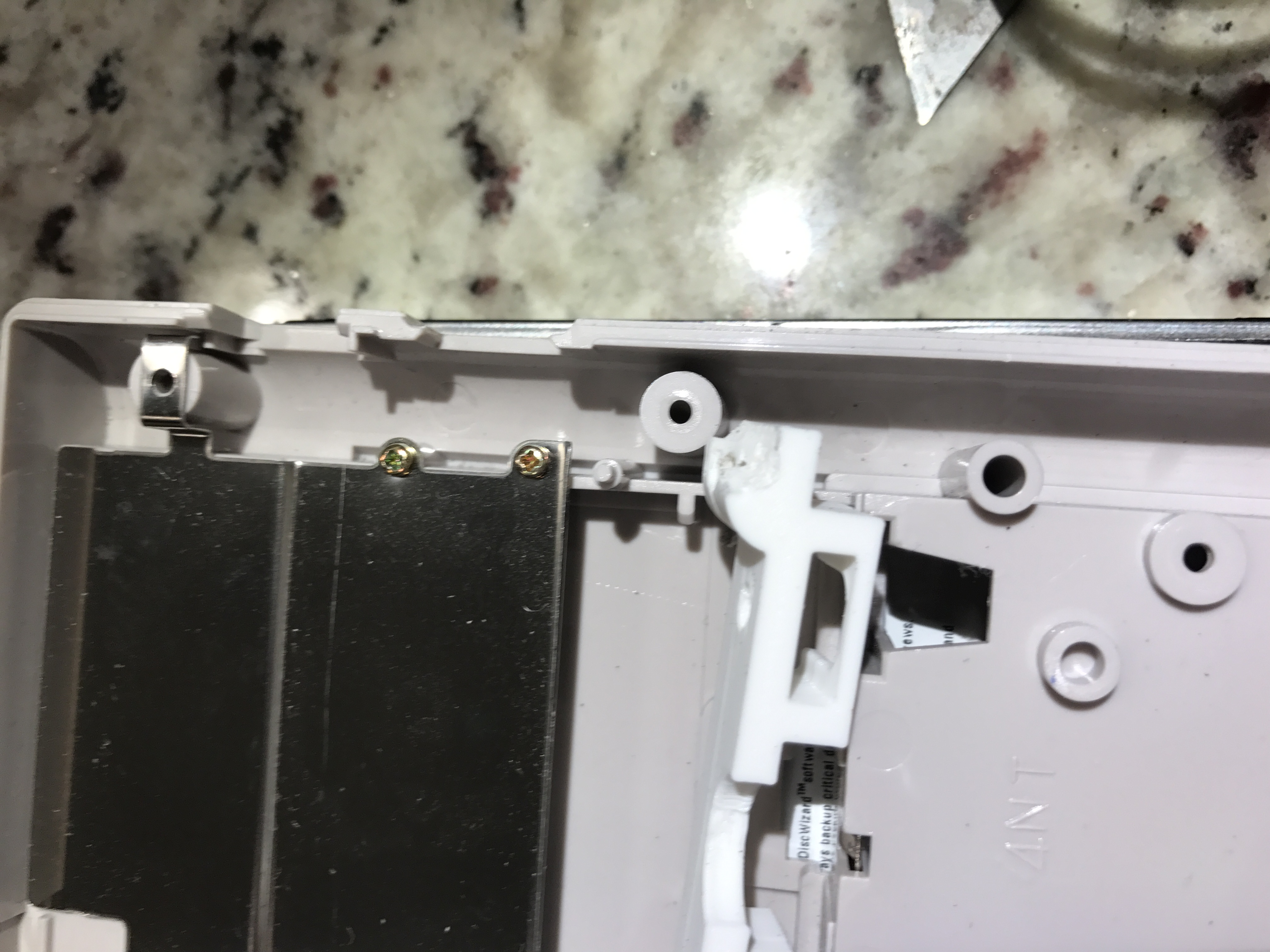

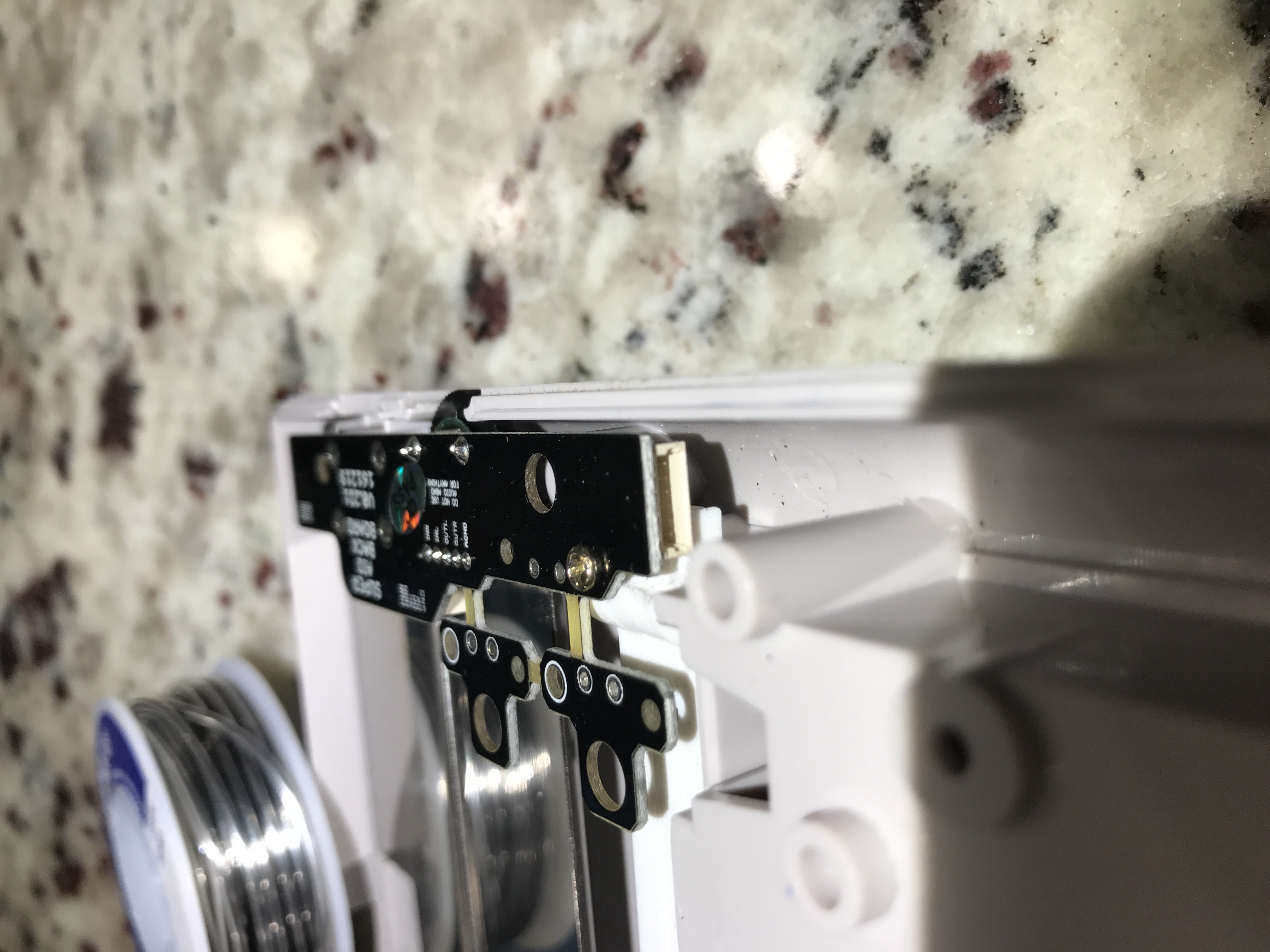

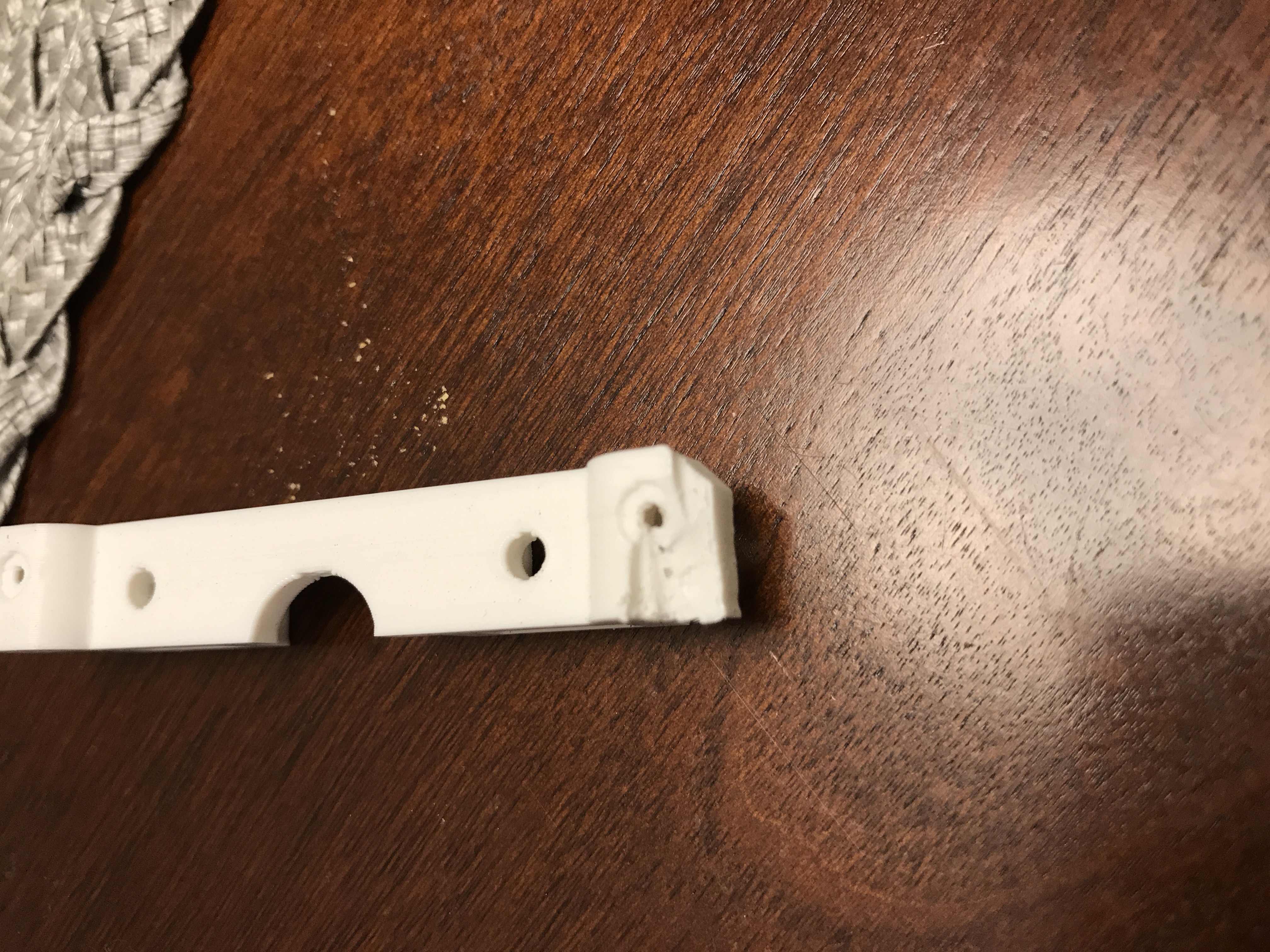

ok, so I finally had a few minutes to start playing with your bracket and Kite's SAIO back board... As it stands, the spacers will ideally not be installed, however, there is a plug at the bottom of the board that is in the way with your bracket. I had to modify the bracket a little to make it fit, but once I did it seems to work ok. Here are the pics for reference (great bracket, btw. Hopefully to get it fully installed this weekend!):
Backboard plug that's in the way
Using my dremel, I removed a bit of the plastic from the bracket (sorry, hard to show in the pic). Note, I only removed the portion that the plug touched, not all the way across, so the board could rest on it.
Installed and seeming to work fine:
erik_gee
Posts: 356
Location: United States
Has thanked: 137 times
Been thanked: 193 times
Re: [For Sale] L and R button Bracket
Post by erik_gee » Sat Aug 05, 2017 3:38 pm
jsawhite wrote:
Sat Aug 05, 2017 2:32 pm
Thank you for letting us know! Could you post some more photos of the spot you modified so I can get a better look? Also, the part you dremeled, is the screw hole still usable ?

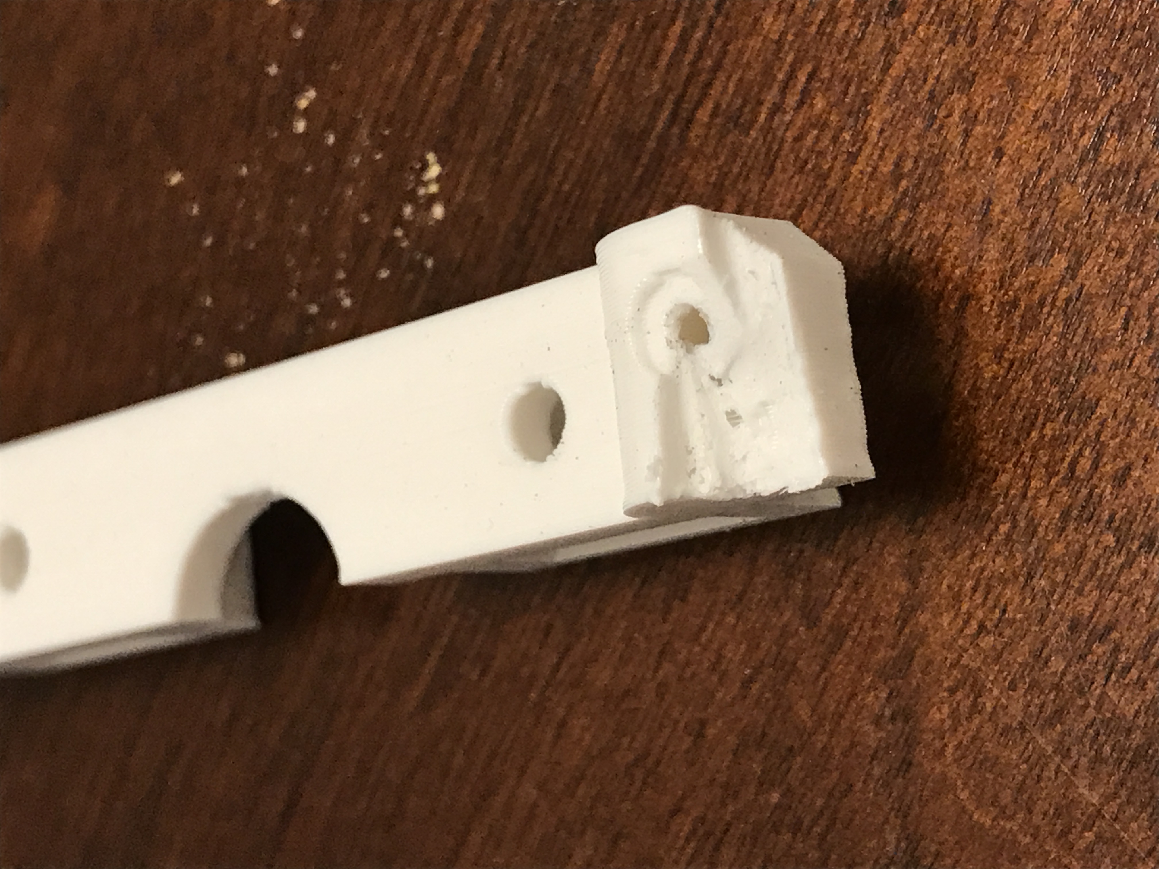

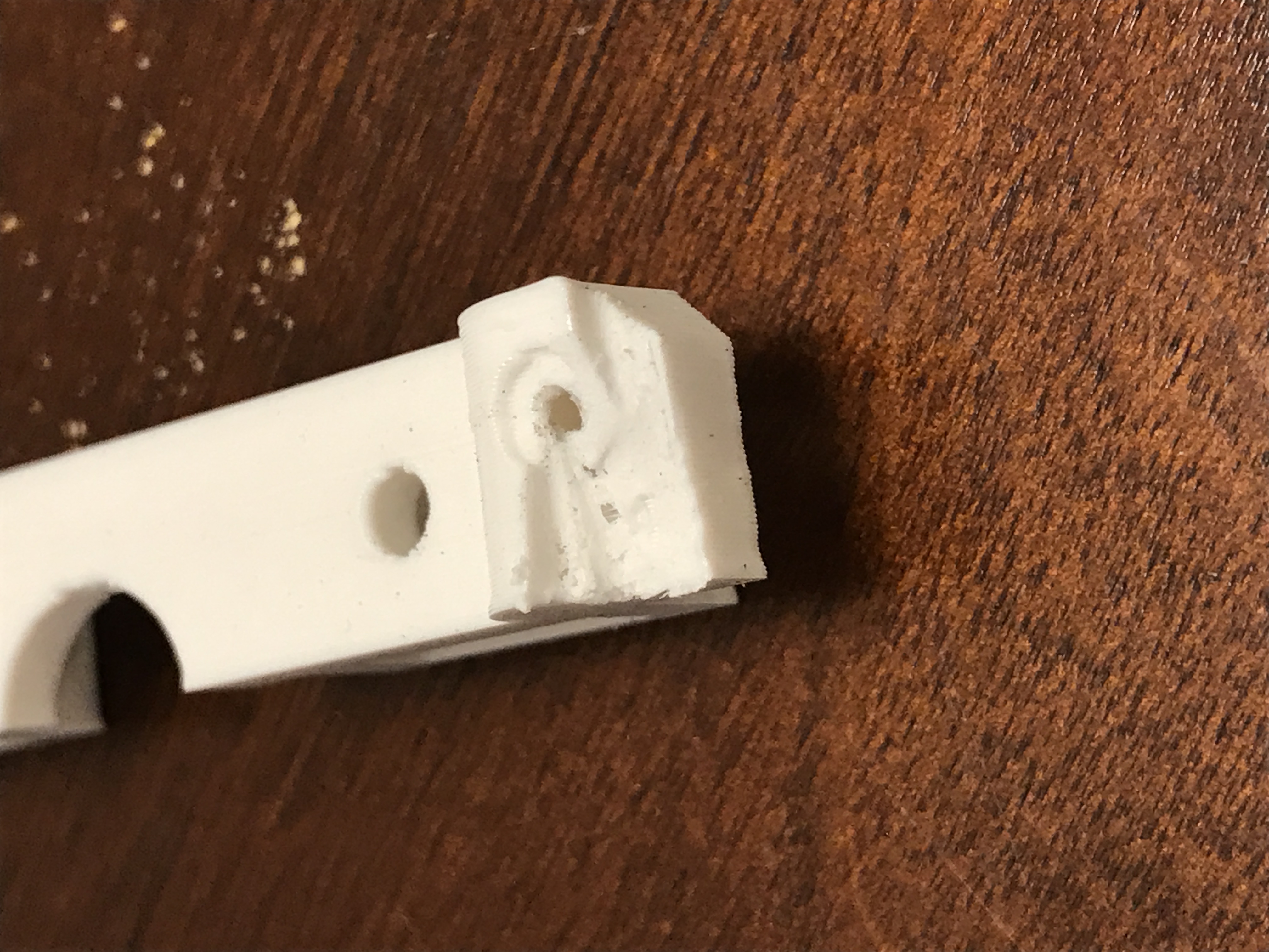

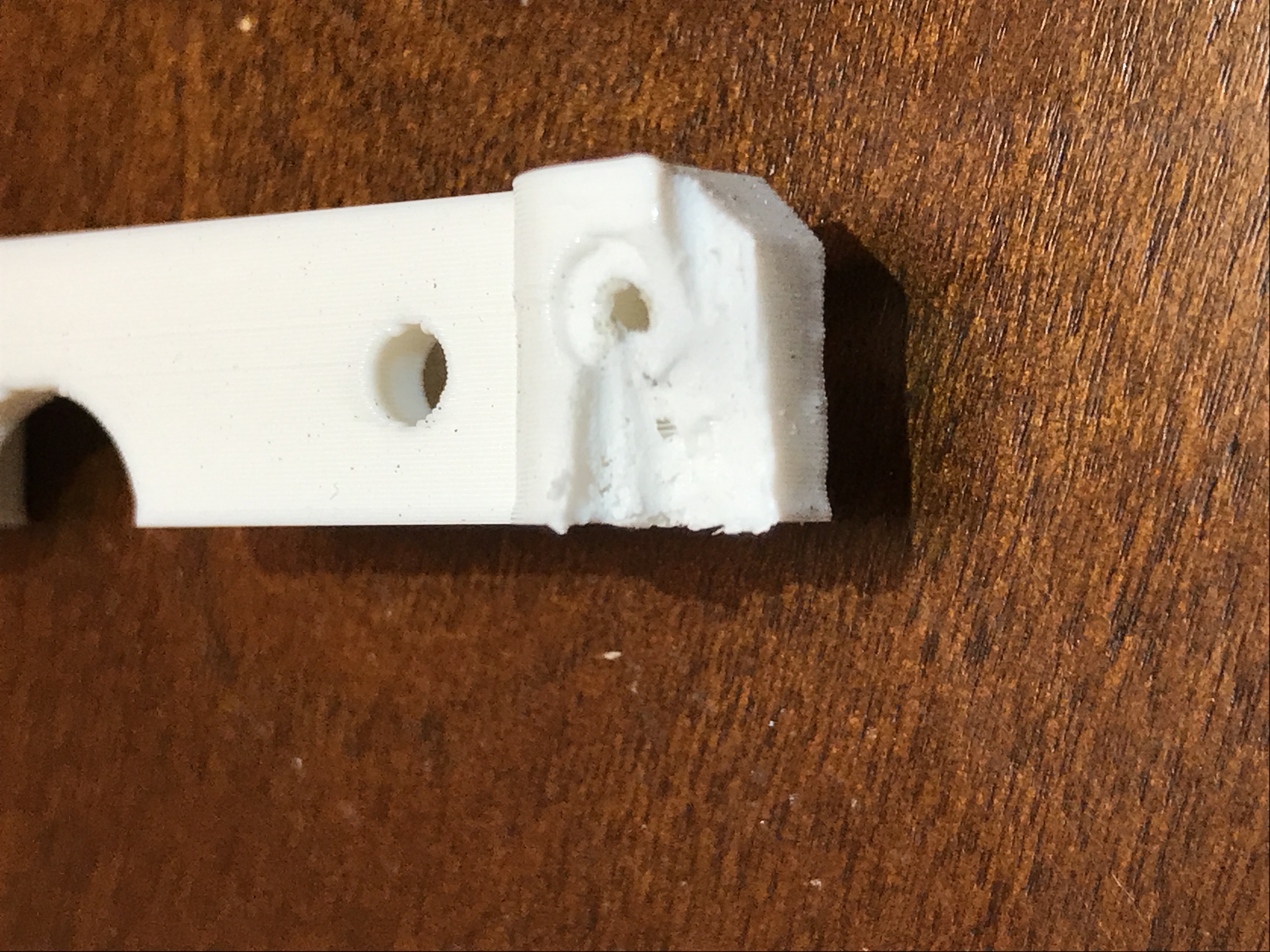

jsawhite
Posts: 31
Joined: Fri Aug 26, 2016 5:45 am
Location: Lutz, FL
Has thanked: 23 times
Post by jsawhite » Sat Aug 05, 2017 5:40 pm
Sure!! Hopefully it helps others out! I took some more pictures. Hopefully that helps. I know it's not pretty, but it was quick and dirty and works, so...
Oh and yes, the screw hole still works fine.

Post by erik_gee » Sat Aug 05, 2017 6:05 pm
20170805_232940621_iOS.jpg20170805_232956585_iOS.jpg20170805_233007507_iOS.jpg20170805_233009876_iOS.jpg20170805_233108520_iOS.jpg
I'm gonna shoot you a pm. Gonna try to resolve this issue for future orders
