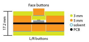

So the the 3mm is the thickness of the top half and 5mm is a he bottom, is that correct?
No, the top and bottom use 3mm and 5mm together, here's a side view:
side view acrylic2.png (6.41 KiB) Viewed 9242 times
I'm sorry if the pics I used on Ponoko were misleading.

With this extra Ponoko information, I would be interested in a kit. I hope they are made available before the offer expires. Also, even though we are sadly backwards and generally don't use metric, I wouldn't be surprised if the laser cutters can take metric. I do a lot of 3D printing and everything is in mm, as is a lot of other things dealing with electronics and mechanical items.
I also emailed them to see if they have 3 and 5mm acrylic in stock. Will you also have to adjust your files/toolpaths to standard instead of metric? That seems like the bigger issue to me.

For the metric to imperial conversion, it only affects the thickness of the acrylic, the design files are just vectors so aren't affected.
There's a page on the Ponoko website that details the thicknesses in both metric and imperial https://www.ponoko.com/make-and-sell/sh ... ylic-clear
That page explains that the thickness can vary (even within the same sheet in my experience), but I've laid out the parts in the design file so that everything is close to the other parts that need to be the same thickness.
The 3mm sheet is equivalent to the 0.118 sheet.
I've suggested using the 0.220" sheet in place of the 5mm sheet, it's a bit thicker but will ensure there's enough clearance (it'll only be 1mm thicker overall).
