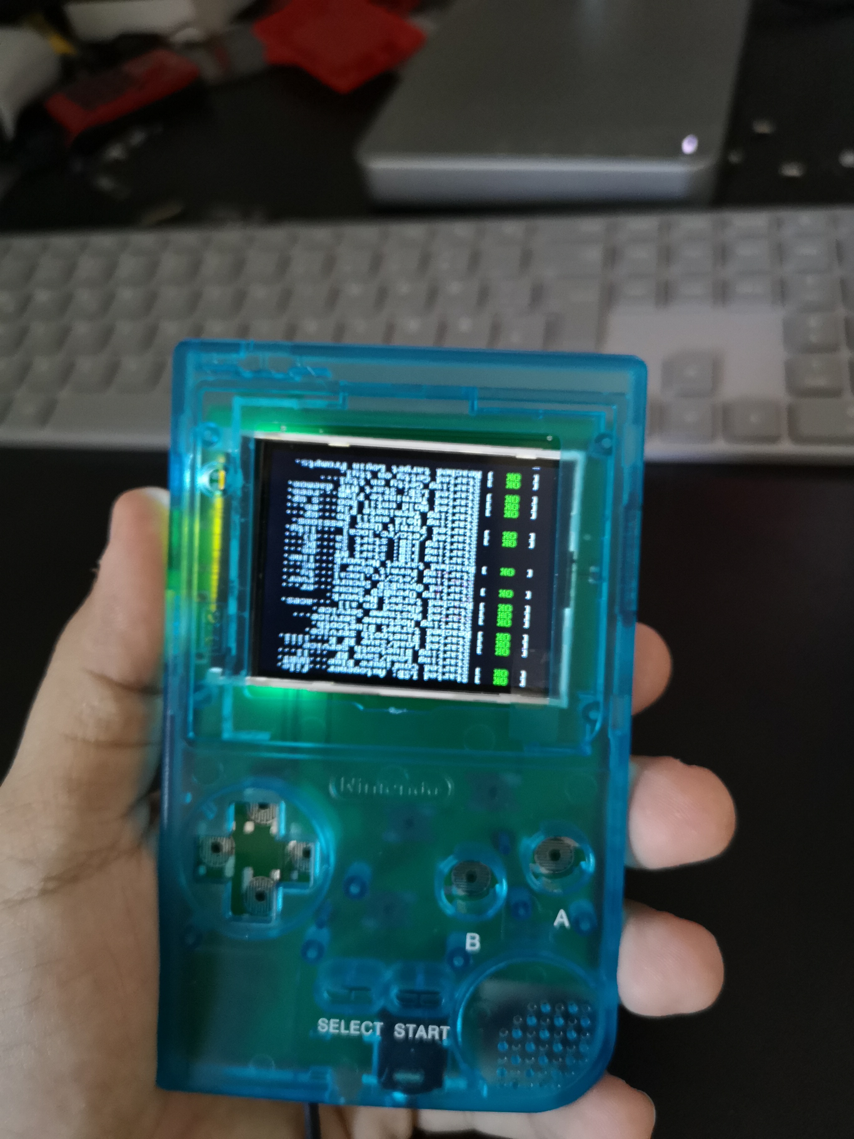

Post by xfx9500 » Sun Jun 03, 2018 11:50 am
i made on of your awesome boards myself :)
but when i power it up with your image is the screen upside down :(

Pre Build 6 buttons Image is Coming ?
Add "display_rotate=2" to your boot config file. That should fix your screen issue.
