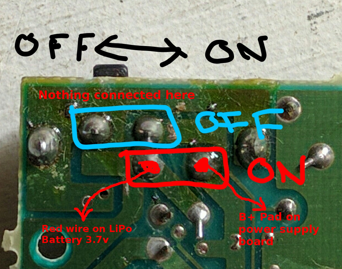

Just bought a few of these as cheaper options to powerboost, i just have a few questions please, firstly
when wiring the full size external usb (not micro) will I now just power this from the usb hub not direct from this like with the powerboost set up?
When adding an on off switch I put the switch inbetween the v+ and power strip, It works but the on position is off and the off position is on how do I correct this?
Thanks

Post by Psy128 » Wed Aug 31, 2016 5:27 pm
Lpoolm wrote:Just bought a few of these as cheaper options to powerboost, i just have a few questions please, firstly
Thanks
On this one my one I switched the battery off but you can still use it the same way to turn the load on and off (v+)
