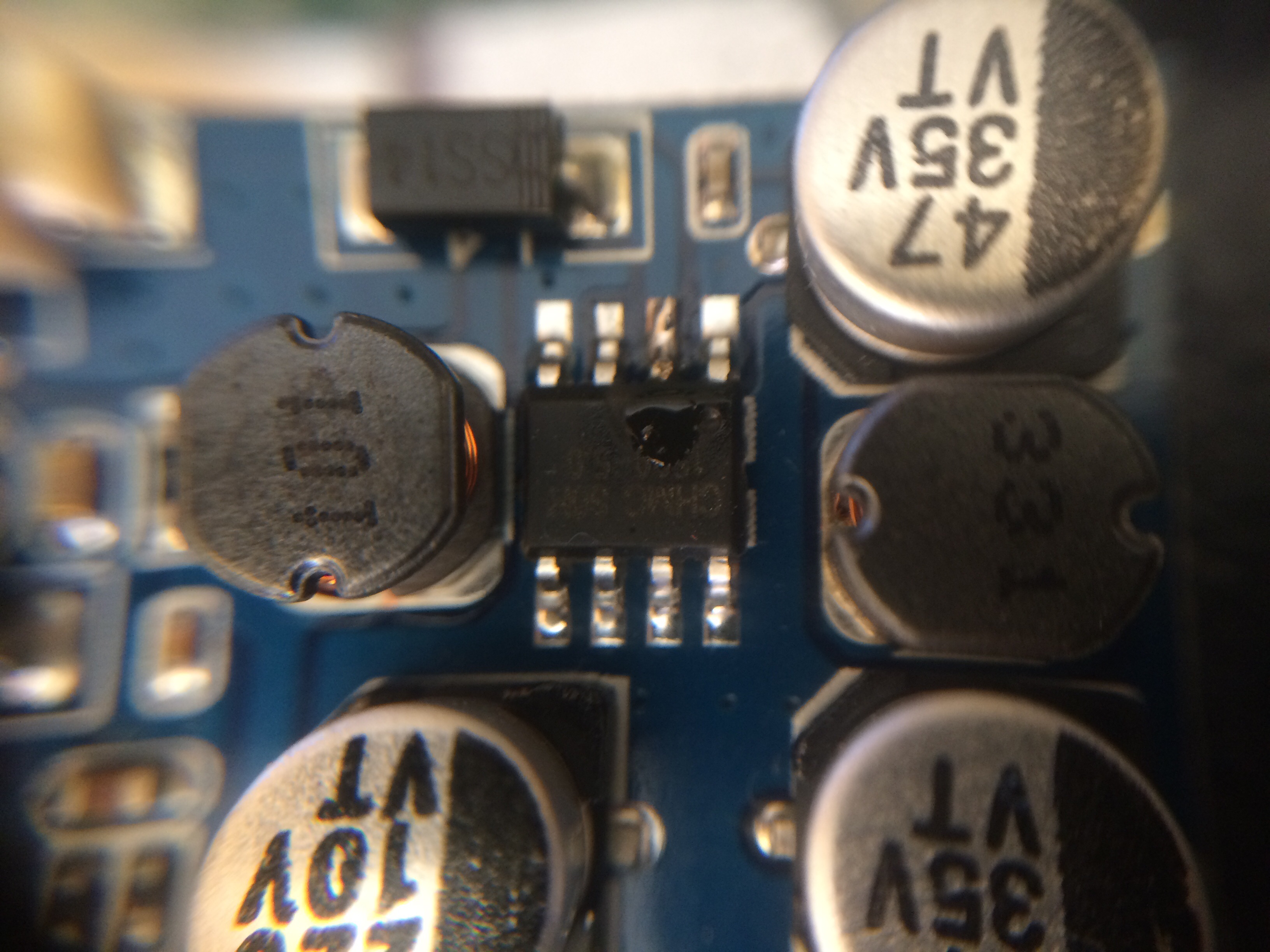

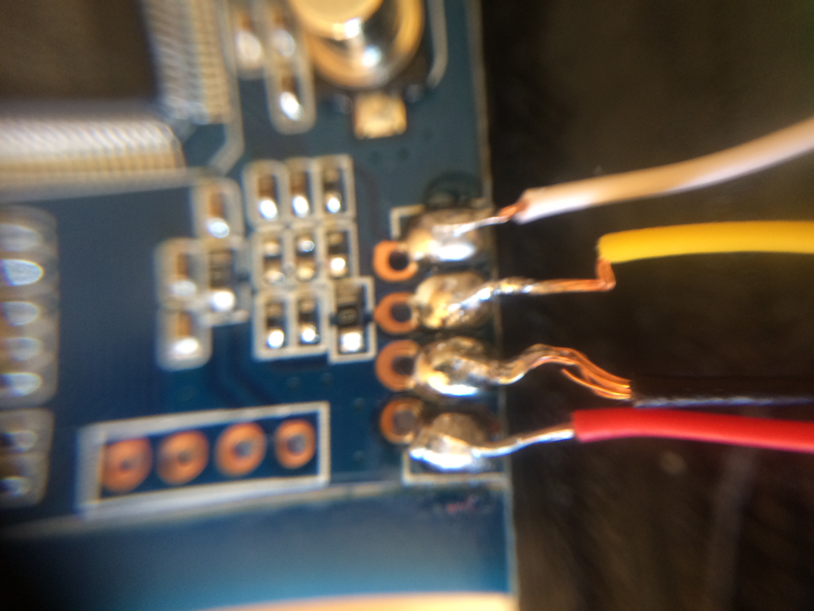

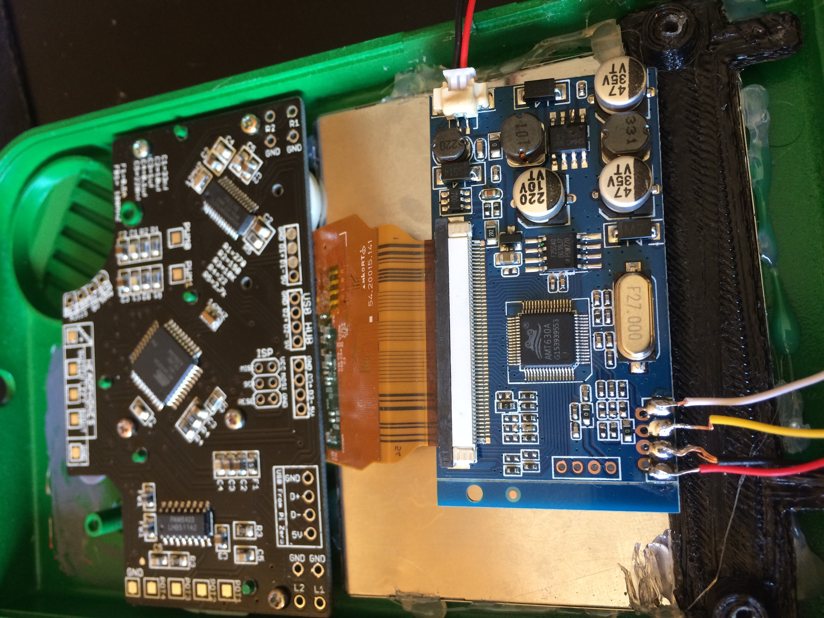

Hi Guys, I hace a V7 Display Variant. I tried the display few weeks ago and it works well but display was show a little flickering and I made a Jumper From red cable to chmc soh chip. And now is not working, I fried the display?
I removed the Jumper and resoldered all cables and still not working. RPI0 works fine connected to HDMI on another TV.
Any advice? Thanks

Based on your wiring I'd say something might have shorted out. Too much bare wire with no insulation on it that could have come in contact with other wires. Remove all wires and all the solder and try again with neater insulated wires. Maybe you'll get lucky and you didn't short anything out.

KaiKona808 wrote:@Rog585
I have the same screen as you. I am no expert so just sharing info from how I was advised in wiring my board for this same screen.
From the video driver board:
AV source (yellow wire): connect to TV on Pi (where you have it now)
GND (black): connect to TV ground on Pi - where you have the orange wire going (Note: you have it wired to two places on your Pi. Remove the one you have to the USB ground).
5v (red): connect to 5v on powerboost (though you can wire to a 5v on the Pi to test, but recommend for the long run wire to 5v on powerboost)
Also trim those leads. You can easily see the 5v jumper wire at risk of touching other parts easily.
It took me a few tries of reading and testing and this is what worked for me.
Thanks for your advice, I haven't had chance to try it yet but will soon and report back!

Grimmjow wrote:Hi Guys, I hace a V7 Display Variant. I tried the display few weeks ago and it works well but display was show a little flickering and I made a Jumper From red cable to chmc soh chip. And now is not working, I fried the display?
Any advice? Thanks
P.D: Sorry for my English, I'm from Spain.
Basicamente lo que te han dicho. Quita los cables y vuelve a soldarlos, tienes demasiado cable expuesto, que podria generar un corto.
Por otro lado, en la foto ampliada del chip, parece que hay algo liquido. ¿Es flux? ¿O se ha derretido el chip?
Tengo la misma placa, y con el cable como lo habias puesto deberia funcionar.
Any advice? Thanks
He resoldado todo y nada, sigue sin funcionar. Lo del chip no es flux, imagino que lo toque con el soldador. Antes tenia uno de esos cutres gordos, ahora tengo un JBC 14st y ya mejor.
He vuelto a pedir una pantalla a ver si con suerte me llega una V7.
Gracias igualmente.

Grimmjow wrote: He resoldado todo y nada, sigue sin funcionar. Lo del chip no es flux, imagino que lo toque con el soldador. Antes tenia uno de esos cutres gordos, ahora tengo un JBC 14st y ya mejor.
Gracias igualmente.
Entonces es posible que hayas quemado ese chip. No tires aun la toalla, y prueba a desoldar y quitar el chip totalmente. Realmente el chip no es necesario, y despues de quitarlo, habria que poner el cable puente otra vez. Quizas tengas suerte, y funcioné.
De todas formas, estas pantallas no son muy caras, asique tampoco supone una gran perdida. Yo llevo ya 5 pantallas compradas :lol: Dos de ellas funcionando, cada una para una GameBoy distinta, una con pantalla rota (tu misma version de placa), otra que fue la primera que compré que desguace totalmente (puedes verlo en el seguimiento de mi proyecto), y otra mas que dejo de funcionarme misteriosamente.
