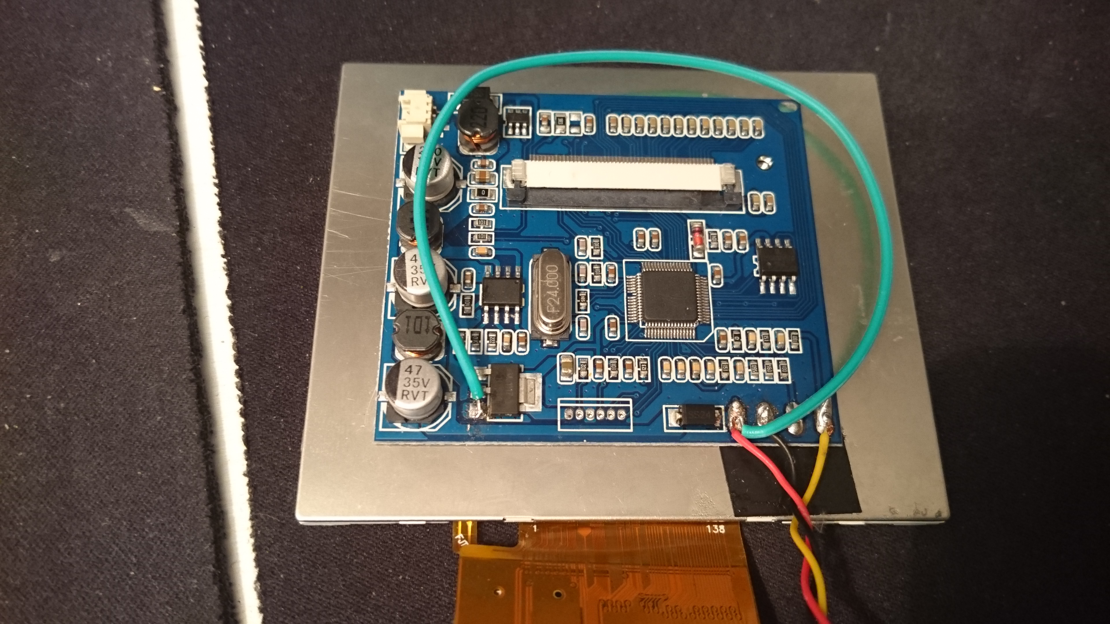

Actually, the wiki could use an update there. While it technically works unmodified, there's a LOT of phasing without that jumper wire.Zero wrote:@damian

Running this screen on 5v with this mod.
Leg on regulator is lifted from pcb and is only in contact with jumperwire.
If leg was connected to both pcb and jumperwire screen was very unstable.

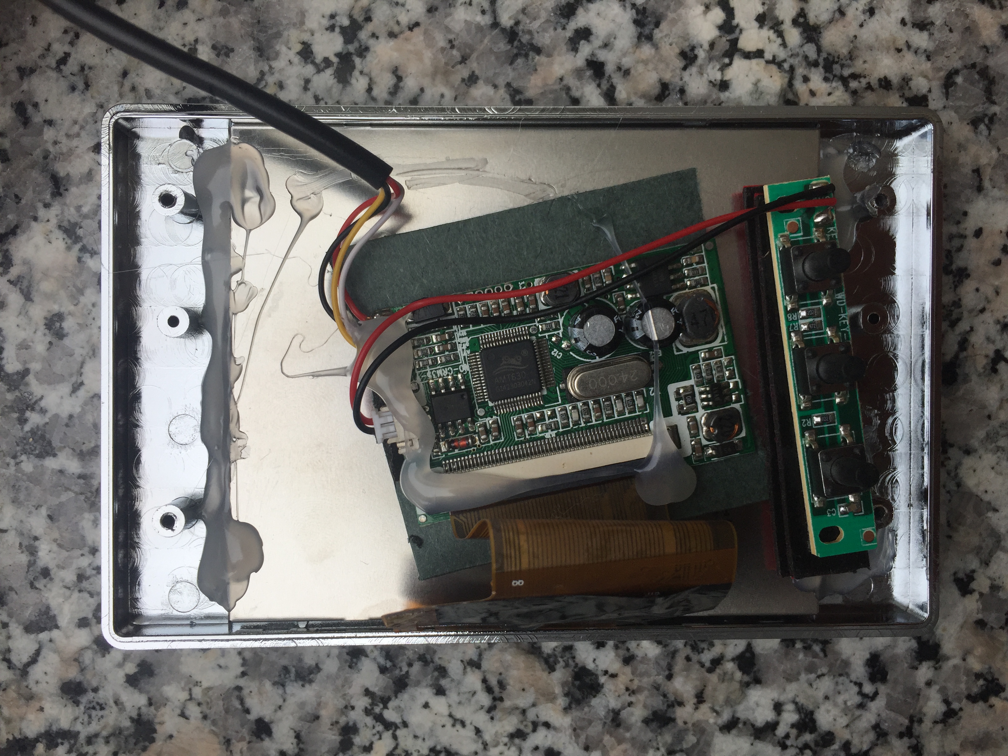

Just got that screen : http://ebay.de/itm/DC12V-3-5-TFT-LCD-Co ... EST_OFFERS
It says its resolution is 640x480. I don't know if it's right or not. Don't know yet if it works on 5V. I'll check that as soon as I can and reply on this post.

I have some details on that display over in my build. Works with a Pi0, but unfortunately is too large to fit int a DMG shell.SP00N- wrote:It's hard to find something that is good. I don't want to buy stuff that is wrong or not usable or could be better. Or maybe im overdoing it and shouldn't be sp pickyHelder wrote: I highly doubt it's that resolution but if it let us know as I'd like to pick one up and being 3 inch screen is also appealing to me as well..

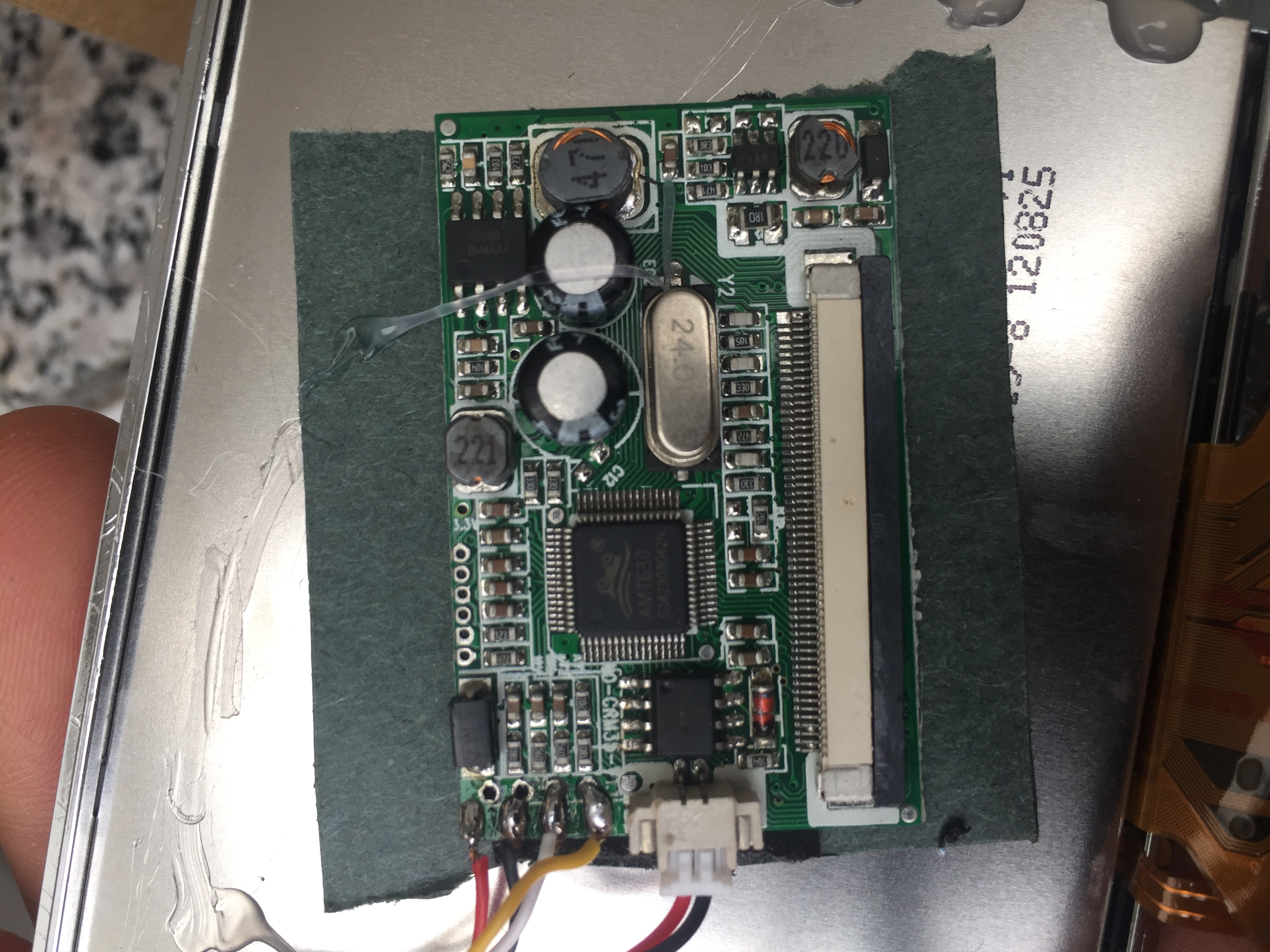

So, this display isn't exactly ideal for a GBZ. The board is pretty big. I'll try to Dremel it down, but the left side might be a challenge. Those through-holes appear to bridge multiple components on the PCB. And I haven't even tried it on 5V yet... (EDIT: It appears to use the same chipset as the Adafruit display that wermy used in his first build guide -- so it should work if I can make it fit)RxBrad wrote:Not entirely satisfied with the V7 BW screen that most people are ending up with (gets too hot and temporarily causes random white pixels). I'm rolling the dice on the "Audiovox ACAM350 3.5" Color TFT LCD Back Up Camera Car Monitor- SJ704" for 13 bucks. The housing is different than the BWs, and I've actually heard of the brand.

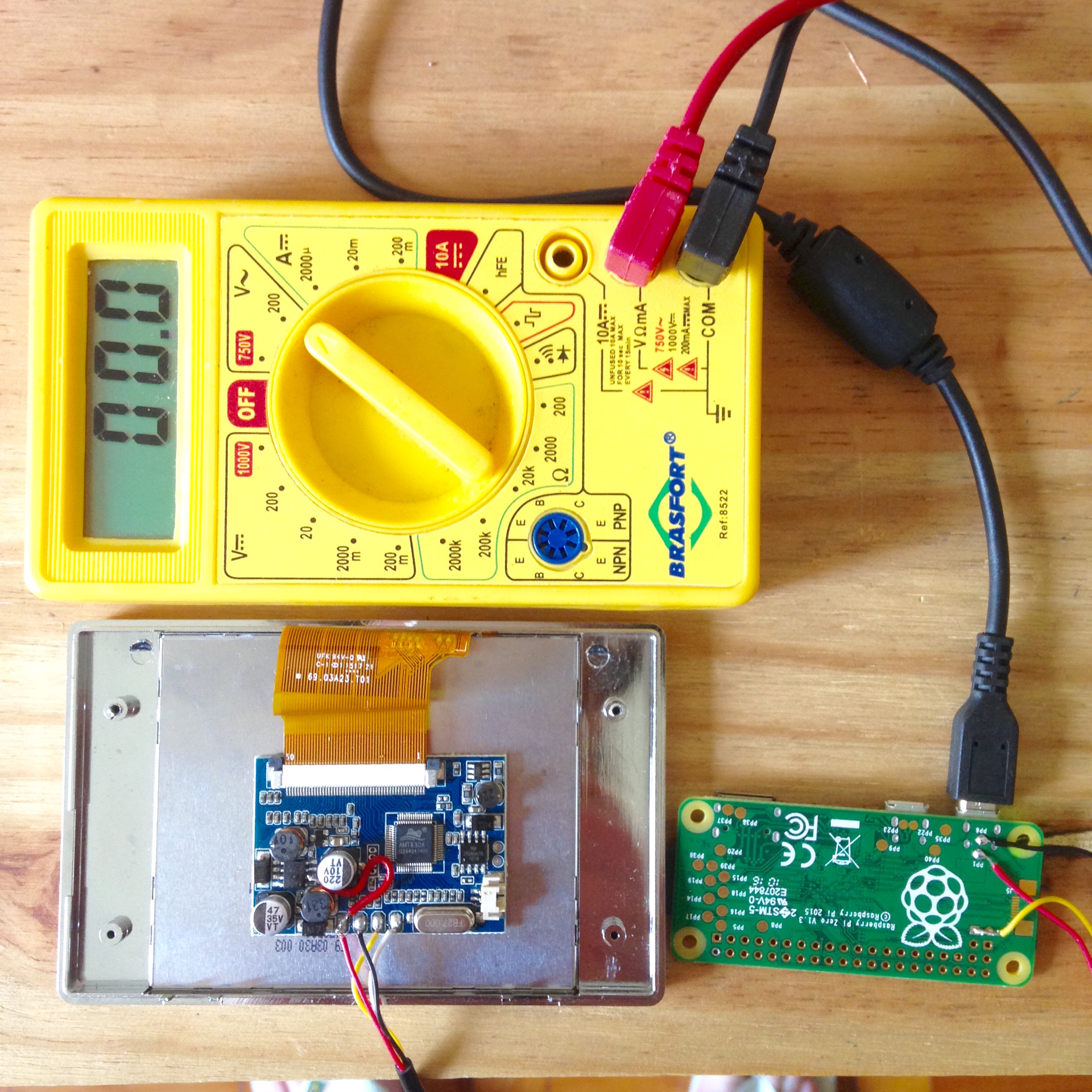

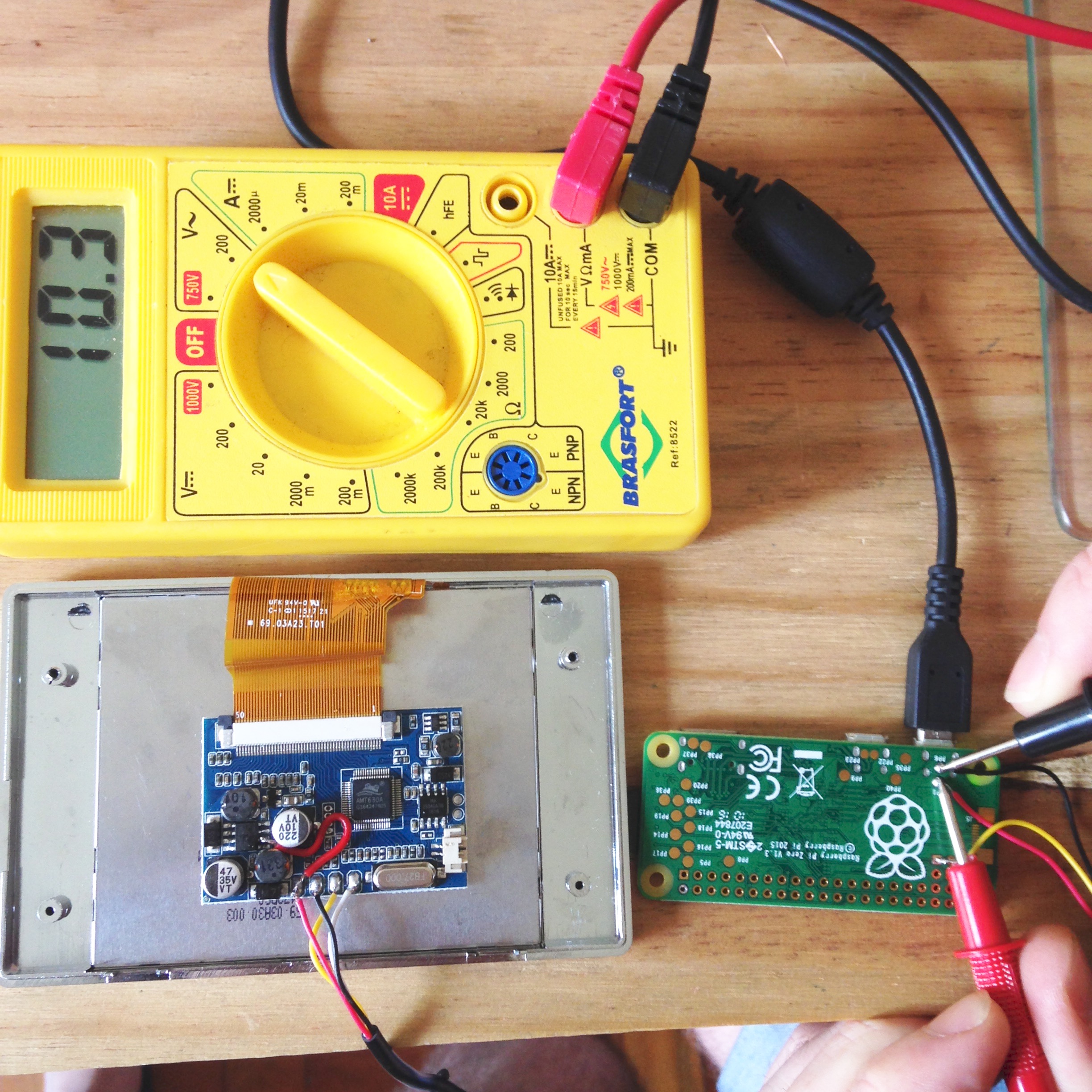

I've got the same board as yours but no "life sinal" whatsoever, even with the mod =(
I did a lot of research with no success with that.
Can someone help me?
Thanks a lot
