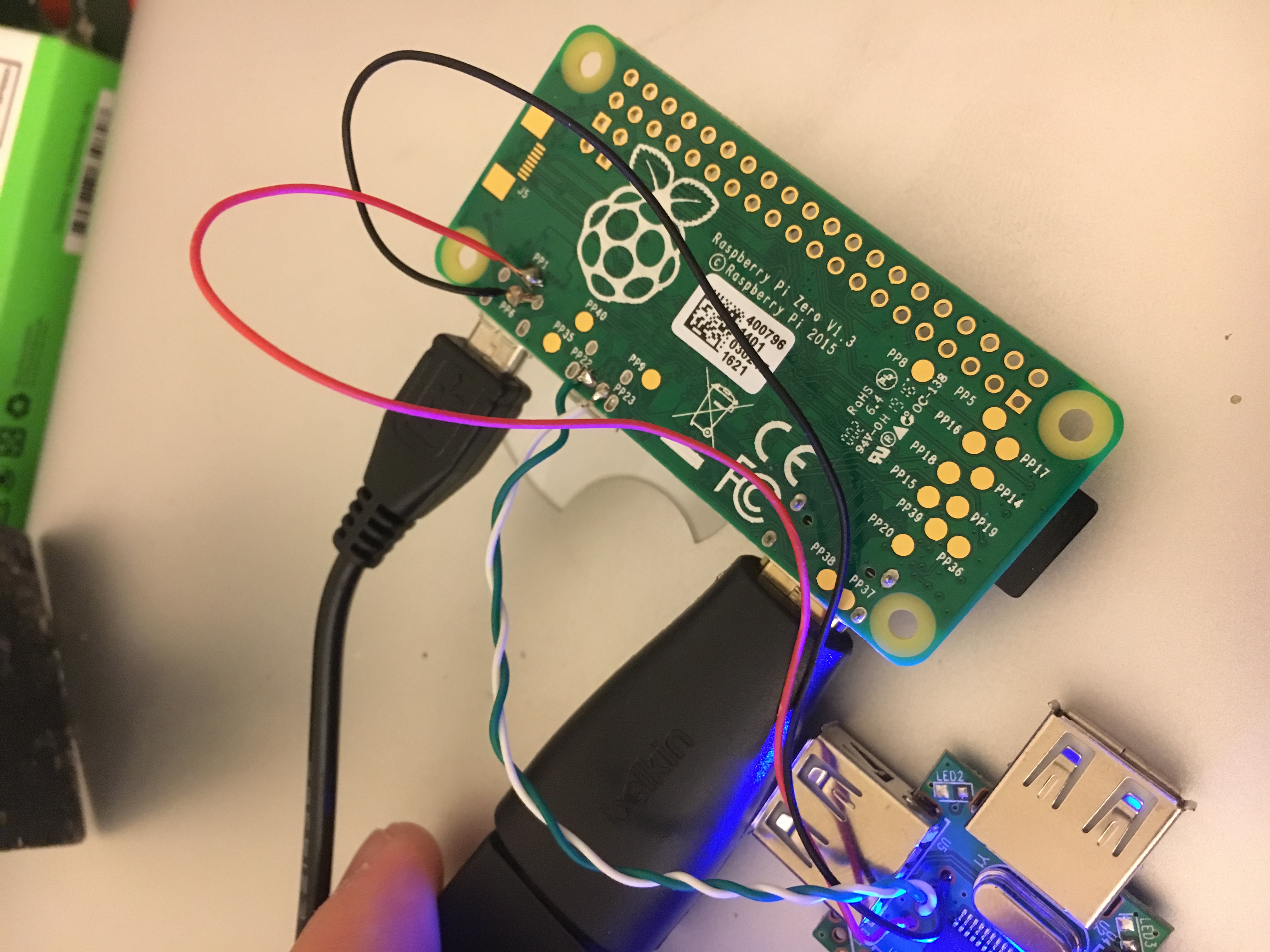

I've checked around the forums and I feel like I have tried everything. I just can't seem to get the Pi to recognize a keyboard. I've tried the Targus from the video, and a small 4 port USB 2.0 hub from ihome that I picked up at a store in town.
Both of them power on, so I know it's getting juice from the power pads. I can power up an external hdd with them both.
When I plug in a keyboard though, it just never seems to recognize it. I tried a mouse, but it seemed to glitch out the pi and restart it. I noticed the laser inside the mouse blinks slightly at first and doesn't really come back on after a few seconds.
Here's a pic of my setup. I'm just beginning to solder (first timer really), so it's not pretty, but the wires are in tight
I tried the wire twist, and I soldered the ground and second pin on the other side of the micro USB port on the pi as suggested elsewhere. No luck. I'm feeling rather stuck and I'm hoping I have a breakthrough soon. Any input is helpful!! My apologies if this reads weird, I'm typing it on my phone.

Re: USB hub help!
I had usb issues as well. My issue was a very small trace amount of solder was bridged between the D- and the mounting hold for the usb port on the other side of the Pi.
I SWORE there was nothing in between, but got out the soldering wick, and cleaned all those pads and around that area real good.
Sure enough, fixed my issue.

Re: USB hub help!
WoodMill wrote:I had usb issues as well. My issue was a very small trace amount of solder was bridged between the D- and the mounting hold for the usb port on the other side of the Pi.
There might be something to this. I think I see a small bridge of solder. I will try removing it, thanks!

Re: USB hub help!
Well I used the de-soldering braid on the D+ D- and resoldered to no avail with the iHome hub. I decided as a last effort that I would try the Targus hub and braid the wires, which I hadn't done before...and it worked! I wish I knew exactly what the problem before was, but I am going to blame it on a bridged solder connection. I just hope it works after everything else is set up in the end.
At least I know that my Pi can read the keyboard. I guess the lesson is to not give up
Thanks so much everybody! I appreciate everyones help.
