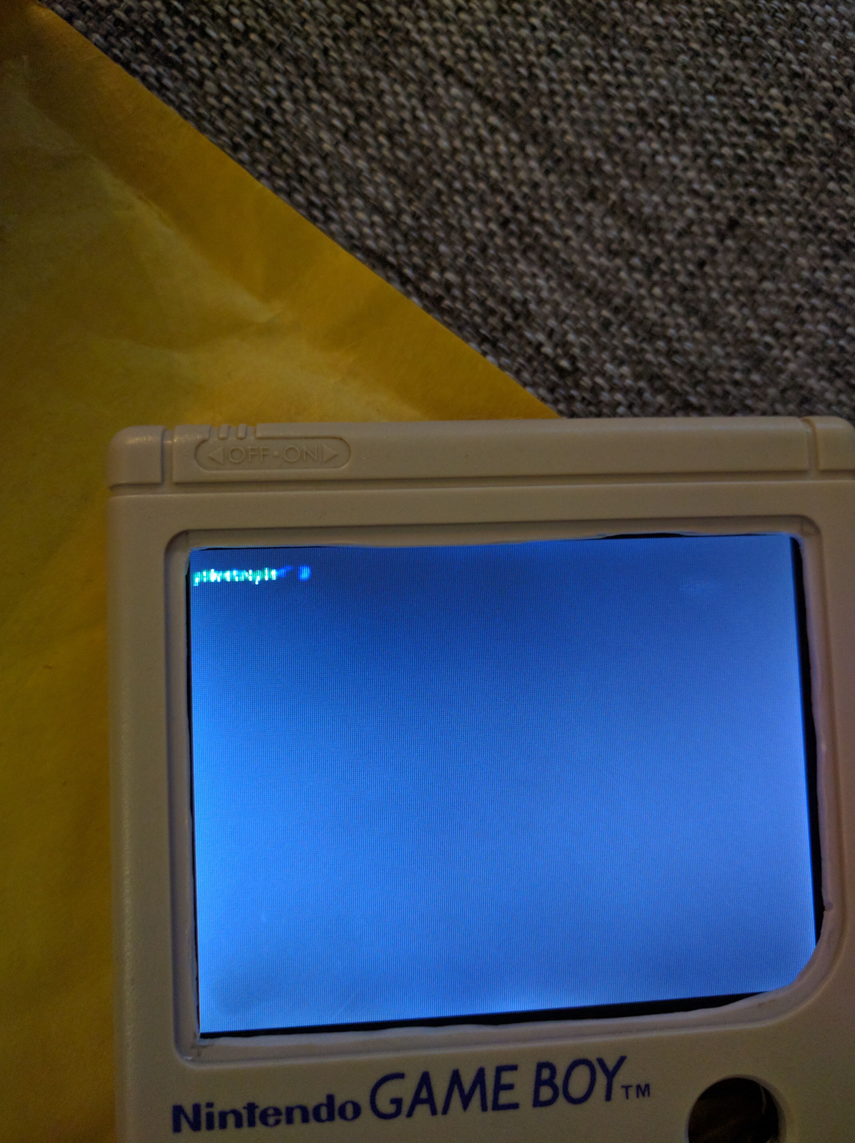

Wondering if its suposed to be bad resolution om the text from pizero (retropie). Is that fixable in the configurations/settings?
Tried to add a Picture, Hope it will work. Impossible to Read. And I went to F4 menu and it was unreadable. Restarted emulationstation and then went to F4 agan. Then this Short text came up.
(Building a Gameboy Zero from Wermys instructions)

Re: Bad screen resolution (adafruit)
Check this post :
http://www.sudomod.com/forum/viewtopic. ... 294#p13783
Thank you for the link!ABH wrote:Check this post :
The instructions helped me to make it work
A followup question, is it possible to have HDMI resolution when HDMI is plugged in. While having the "lower" resolution when not plugged in? Without changeing the config every time?
