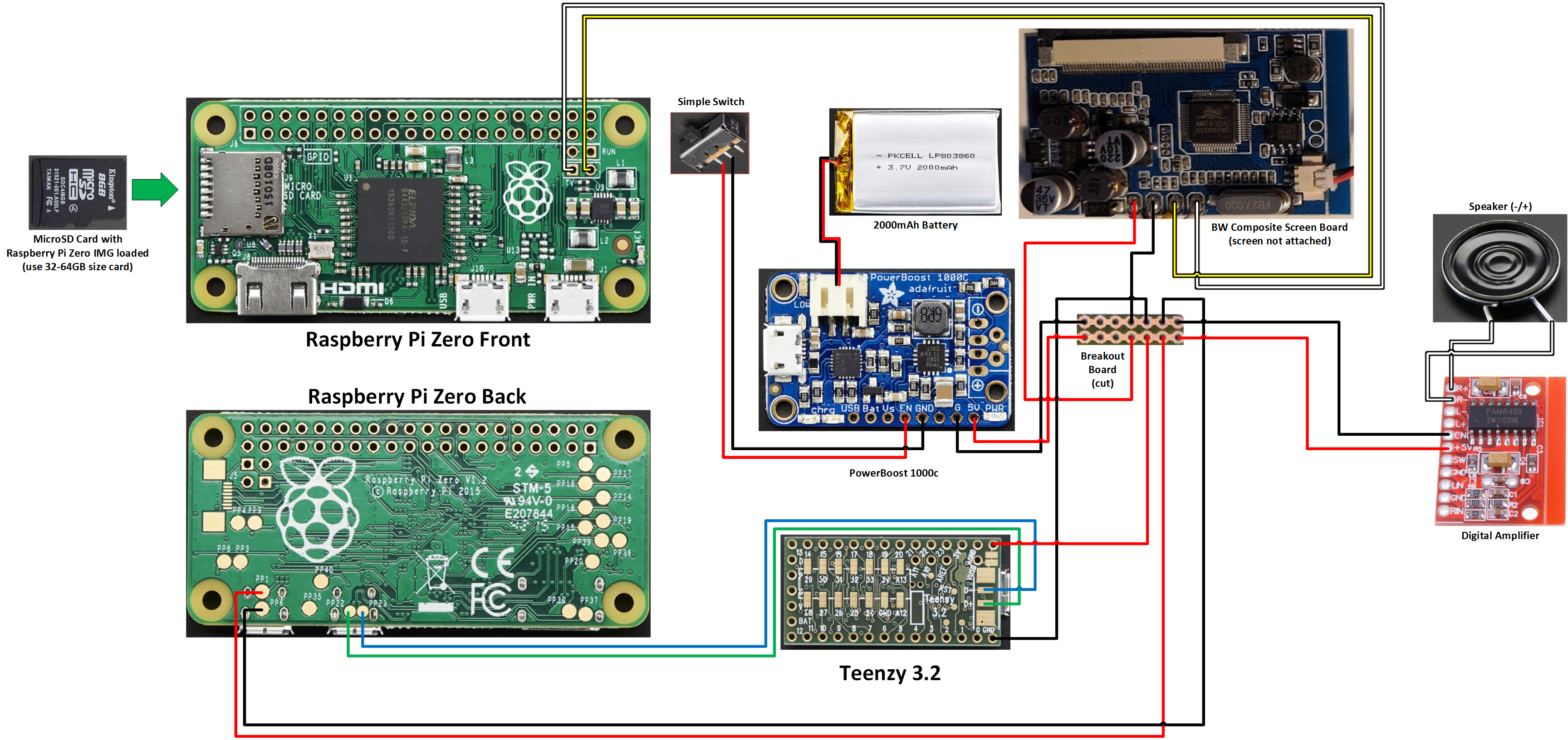

Wondering if you could help me out with a problem. I put everything together like this: removed
When I turn the pi0 on via the switch, the screen comes on and the pi0 boots into retropie. Not getting anything from the teensy though. I was going to do the USB hub later so I connected it like the picture. Do I have anything incorrect? Also, not sure if I have sound yet.

I think I have my Green and Blue cables solder incorrectly to the Teenzy 3.2. I am going to swap them and see if I get a different result.
I am also going to change the power and ground from my BW composite screen board and connect it straight to the powerboost 1000c too.

Ok. swapping the Green and Blue worked. But some keys do not work... Will connect to my PC to test that. I do not have sound at all. But I can move that to another thread. At least I know the Teenzy works.

Well only three keys work on the teensy 3.2. Before I connected them to the pi0 they worked via USB to my PC.
Any suggestions?

I found the issue. My controller board was not leveled at all. I readjusted and all the keys work now.
