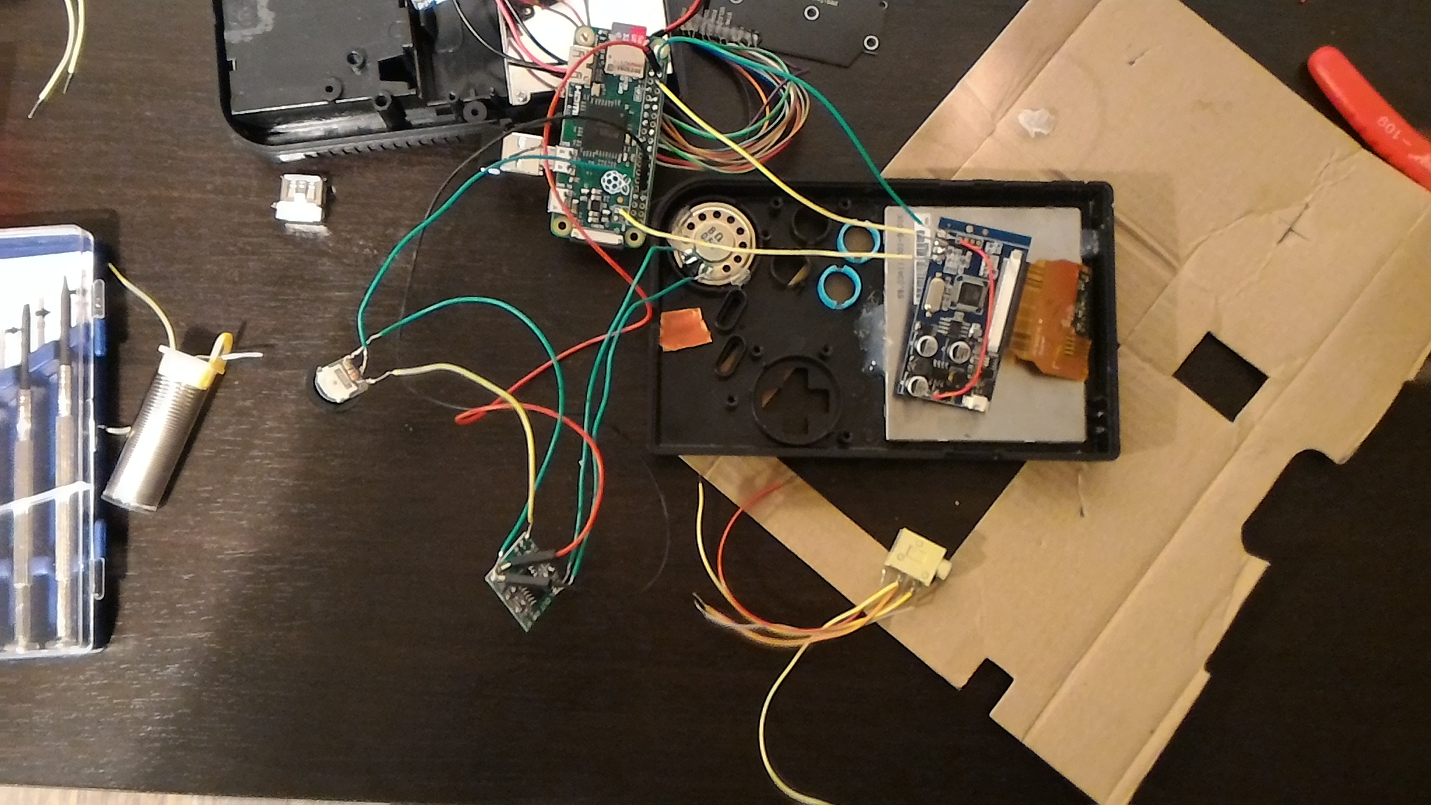

Post some pics of the setup so we can get a clearer idea :mrgreen:
Valadone
Posts: 53
Re: How to connect the audio output from the pi0 ?
Post by Valadone » Tue Apr 04, 2017 5:17 am
I'll take a photo of my setup this afternoon.

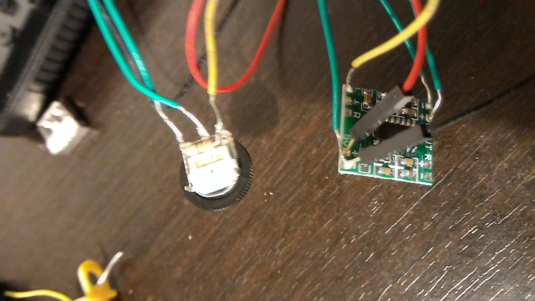

I found this tuto on 'make' but i don't know where to solder the wires on my female jack :/
http://makezine.com/projects/make-24/add-volume-jack/
I soldered a 220ohm resistor between first and third pin to grow up the resistance and it's not bad. The sound is clearer with it.
potentiometer wheel wire : left pin GND - middle pin audio in - right pin audio out
I did a lot of test and soldered everywhere. All some good but i have to solder the female audio jack now.
I think i'll soldered the audio in to left/right in and audio out to left/right out and the last to the GND. Is that correct or not for a mono speaker ?
And i have a tiny little last issue, i want to rotate my display but i don't know where to put this command in the config.txt file = > display_rotate=2 (for 180°). I tried 2 times but the OS don't want to boot after that ... One time at the beginning of the file and the second time at the end and on each try i fuck it --'
Thanks :)

Post by Lphillimore » Tue Apr 04, 2017 8:55 pm
So to confirm...audio works with this current setup?
You're just trying to add in the headphone jack?
Personally i would use a 5 pin volume pot.
2x PWM Outputs from pi would go to the 2x channel inputs on voulme pot.
2x volume pot outputs to the Amp inputs.
Voulme pot ground to PCB shared ground.
Then amp + and - to speaker.
I would then retest before adding the headphone jack into the mix.
Essentially if you see @wermy second build guide he uses the same headphone jack and advises what each pin is.
As for screen rotate, download the config file from @helder AIO Support thread in Lounge and simply add the rotate line as a new line at the bottom. This works for me.
