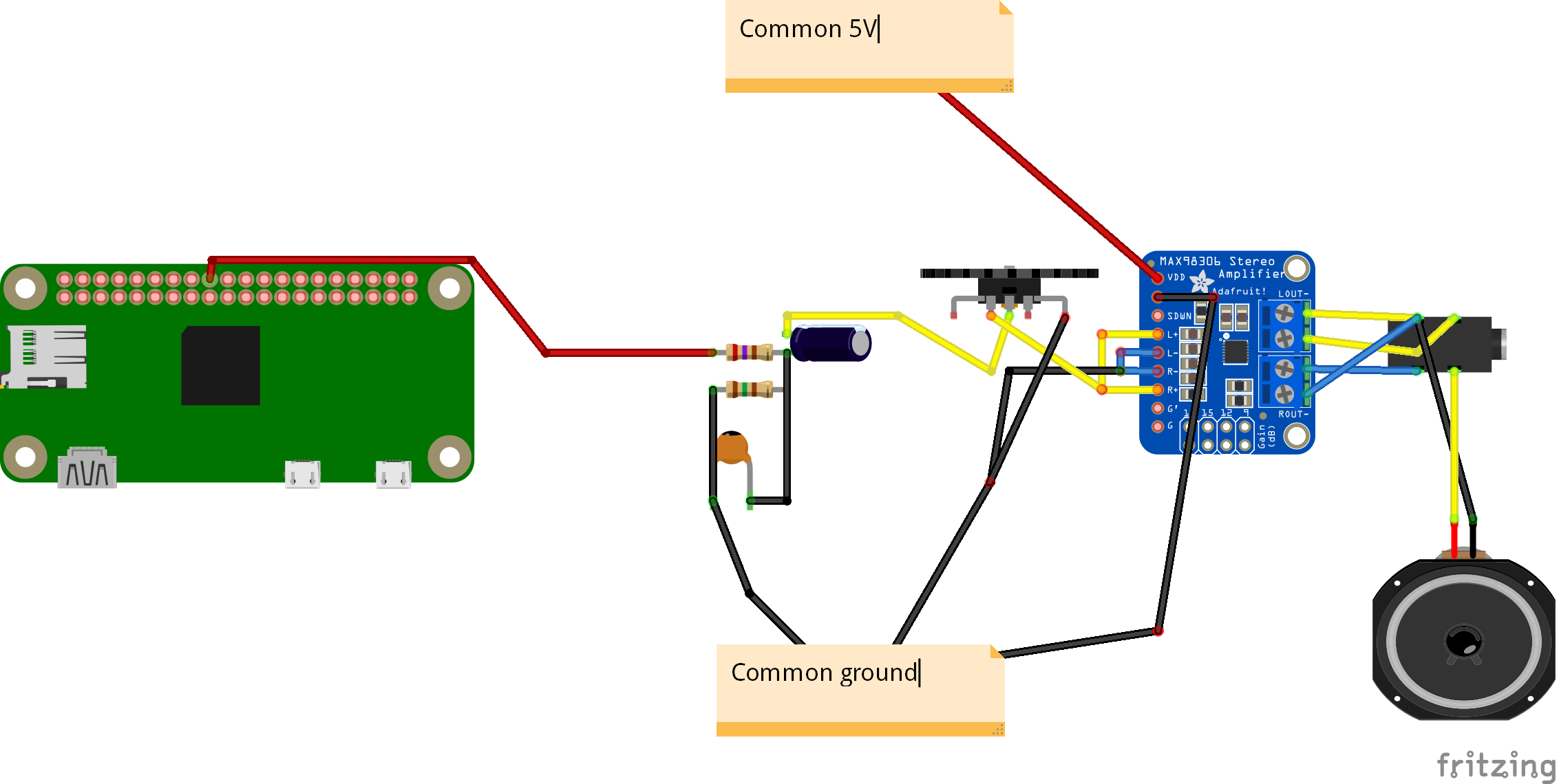

the sound wont work... now let me explain my wiring(pi to amp)
-I am doing only mono, this is why only one half of the low pass filter
-yellow wire out of low pass filter goes to the potentiometer
-I accidently bought a stereo amp, this is why I bridged the connection that comes out of the potentiometer to L+ and R+
-same goes for R- and L- which are connected to ground
amp out:
L- & R- = headphone ground
L+ =Left in
R+=Right in
Speaker + = Left out
Speaker - = Headphone ground
what am I doing wrong?

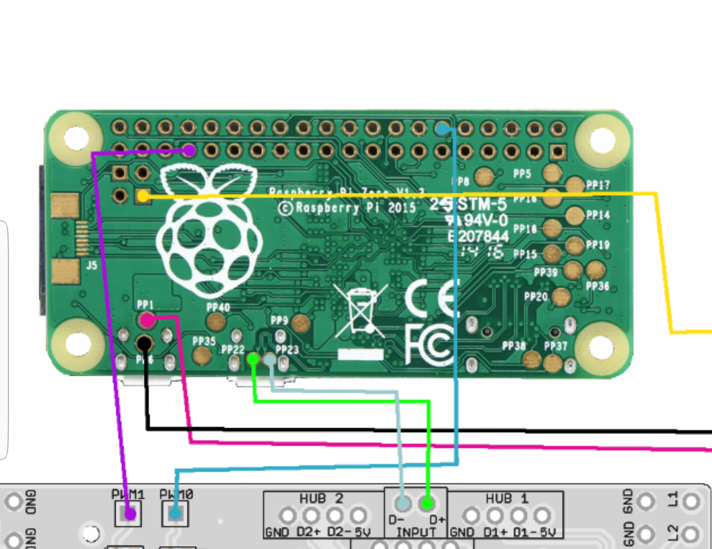

That doesn't look like the right PWM pin you're using on the Pi.
PWM audio on the Pi uses pins 13 and 18 by default and as per config change.
See purple and blue as below.

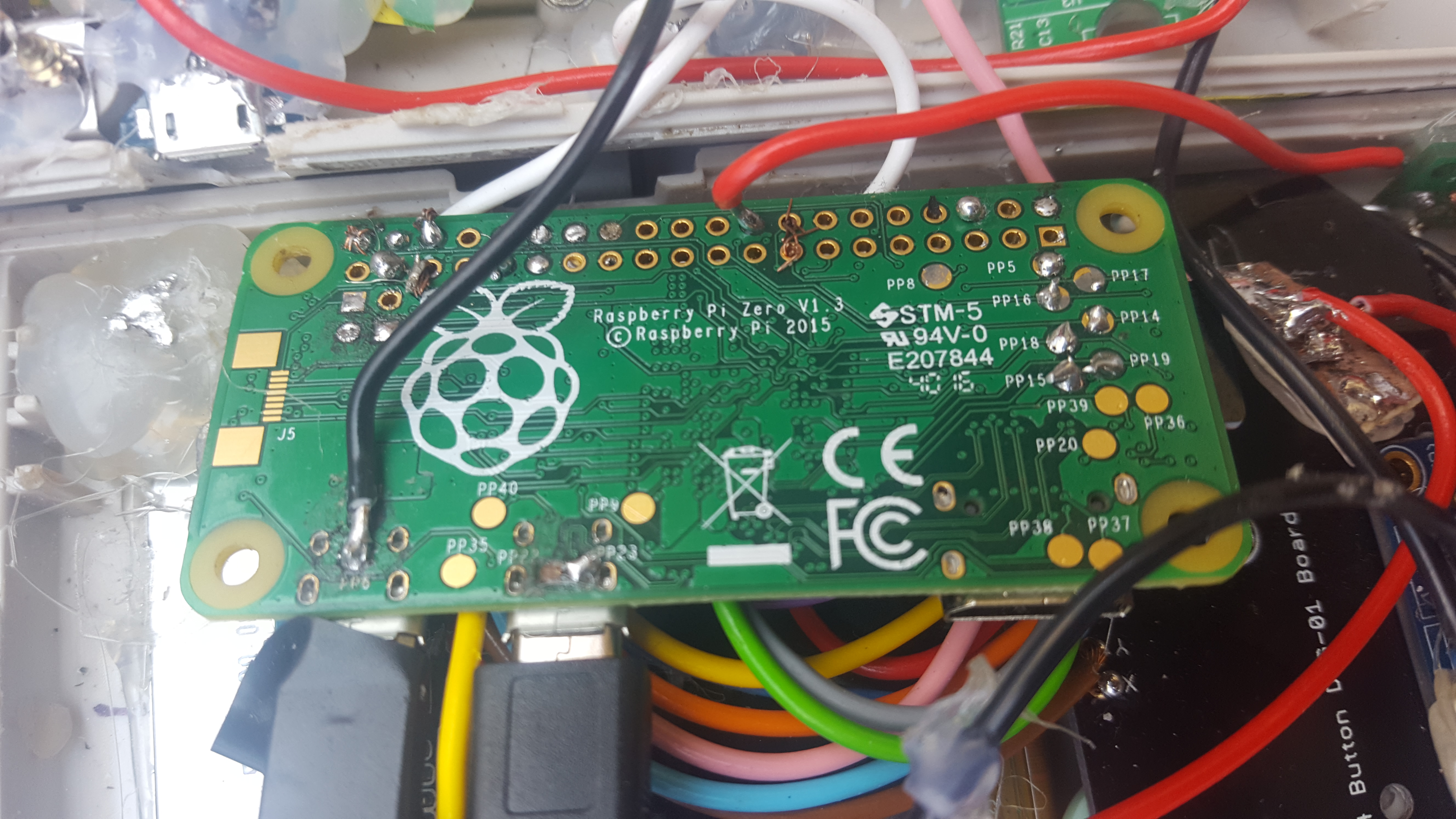

this is my wiring on the rpi red cable is pin 18 i think or have I counted wrong?

yeah your in pin 24
just dont forget to mirror it, as the diagram is from the top, and your photo is from the bottom
