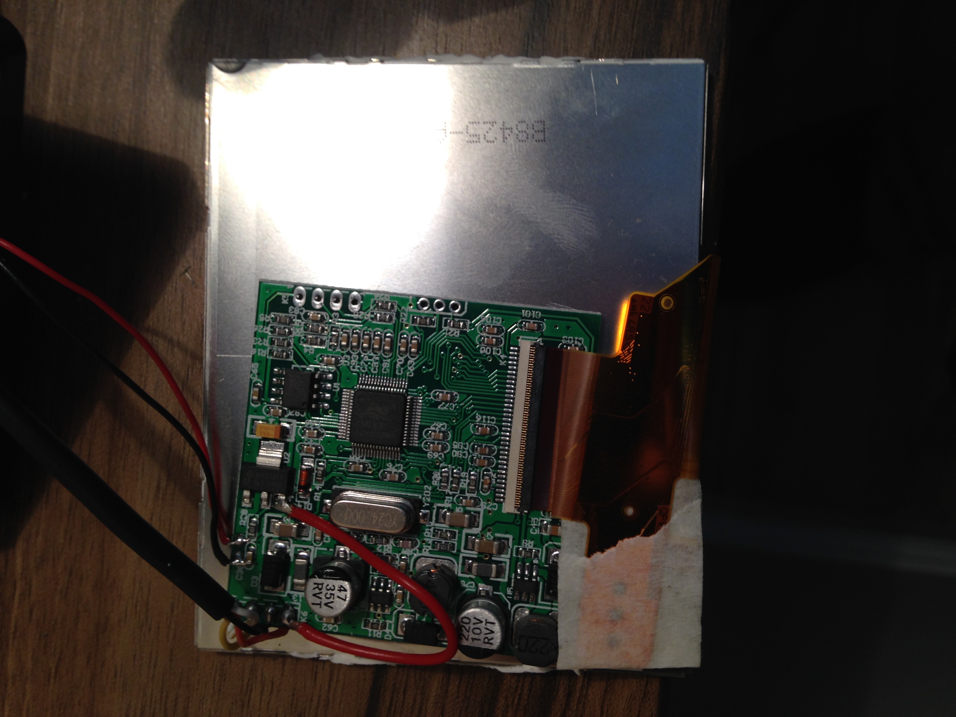

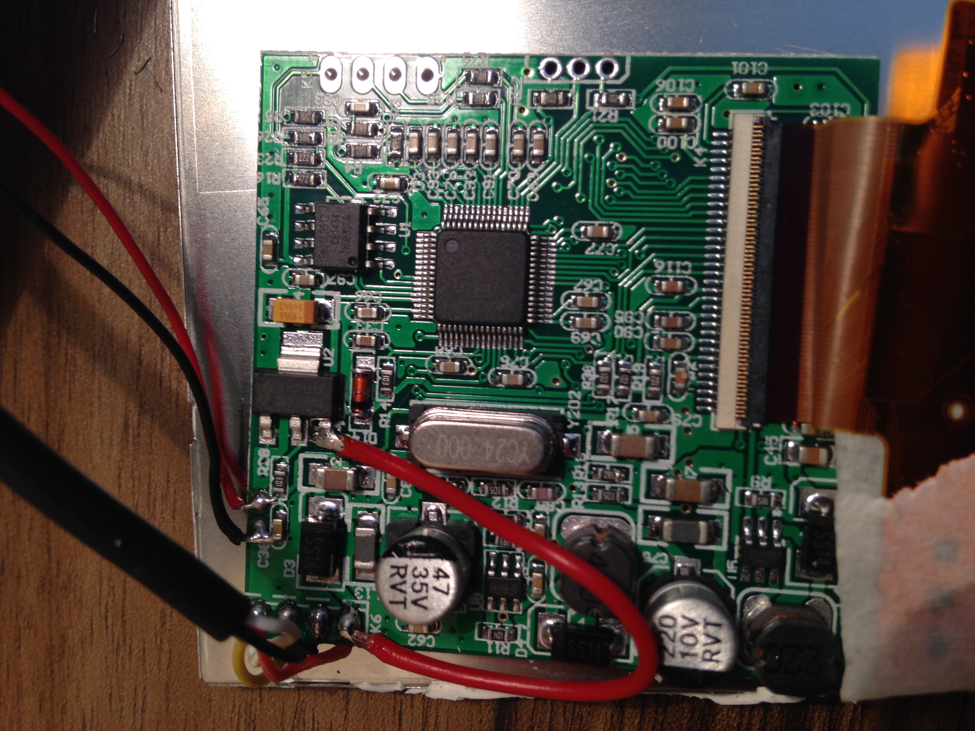

Hey guys!
Got a BW display on amazon.com from a seller called GoodWill Sky. Shipped from Hong Kong, $15.98 with free worldwide delivery. The motherboard is not like any other I've seen here. Also, it doesn't work with 5V so I had to modify it (red wire from 5V to a 3rd pin on AMS1117 chip).
The display is based on AMT630 Video Display Controller from ARKMICRO (http://www.datasheetspdf.com/PDF/AMT630/840049/9).
It has AMS1117 12v -> 3.3v (3 pin) voltage regulator to run all the logic (http://www.advanced-monolithic.com/pdf/ds1117.pdf).
Be careful not to remove a 8 pin chip there, it's a flash memory chip (marked Pm25LD512) presumably for built in graphics. It's the only 8 pin chip on that board so that's a distinguishing feature.
Also, the case didn't have any screws, instead holding together on plastic clips. The control board is on a separate PCB.
Hope that helps!

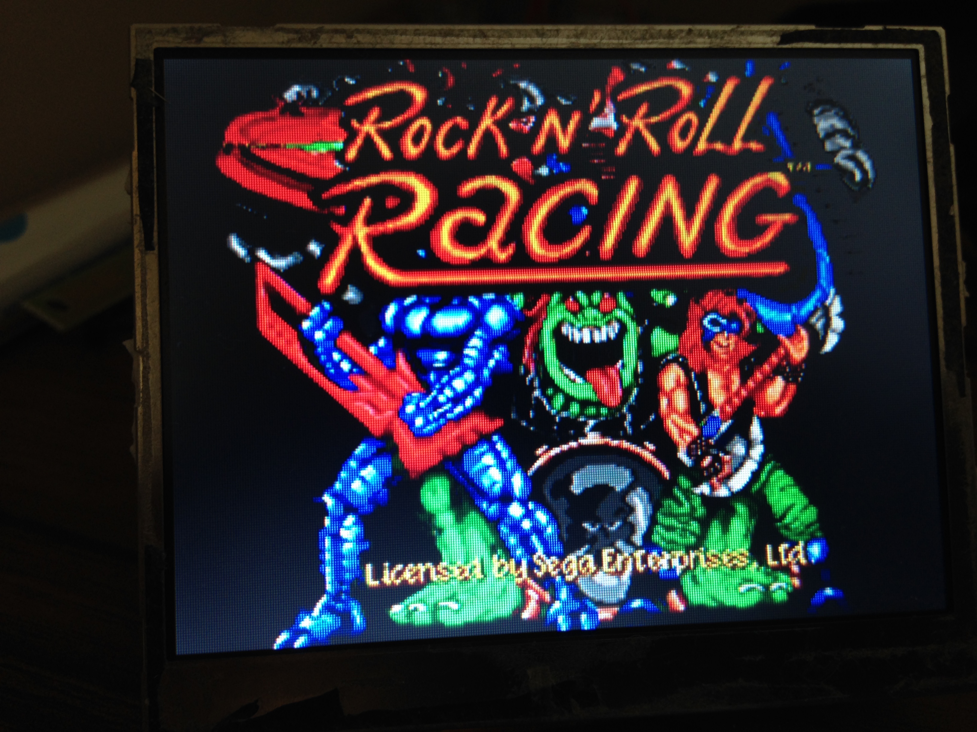

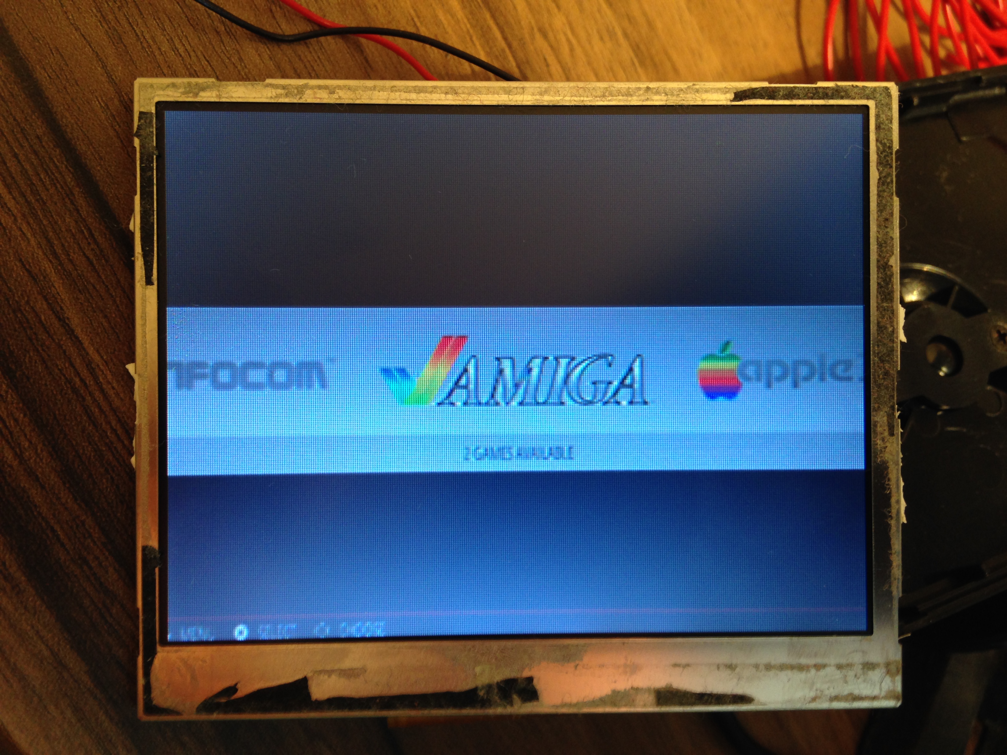

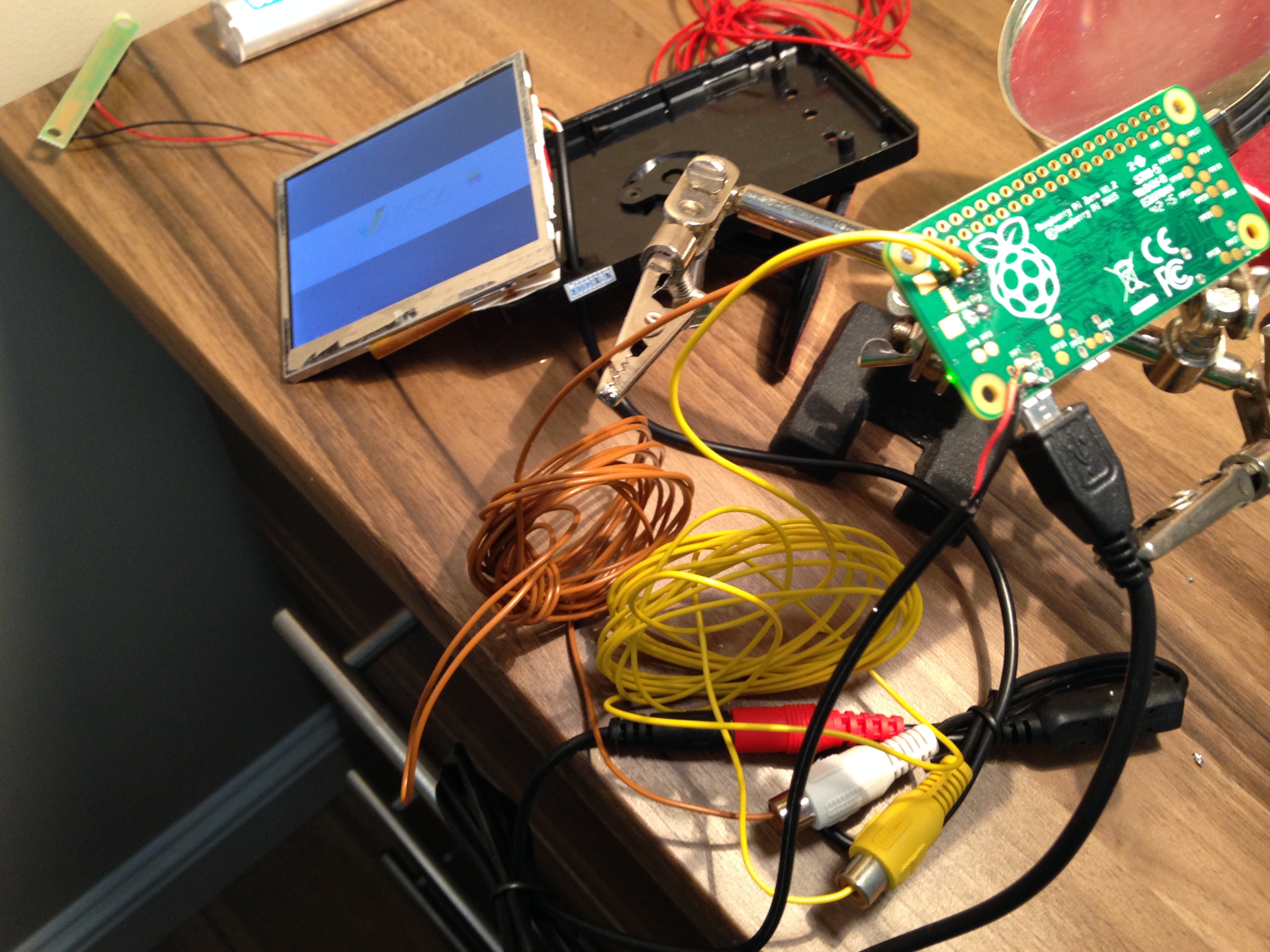

Hello I have this BW screen and I have made some modifications to it and it runs on 5v. I have made a drawing in paint of my wiring
Please correct me if my wiring is wrong or if there is a better alternative, I just tried this.
