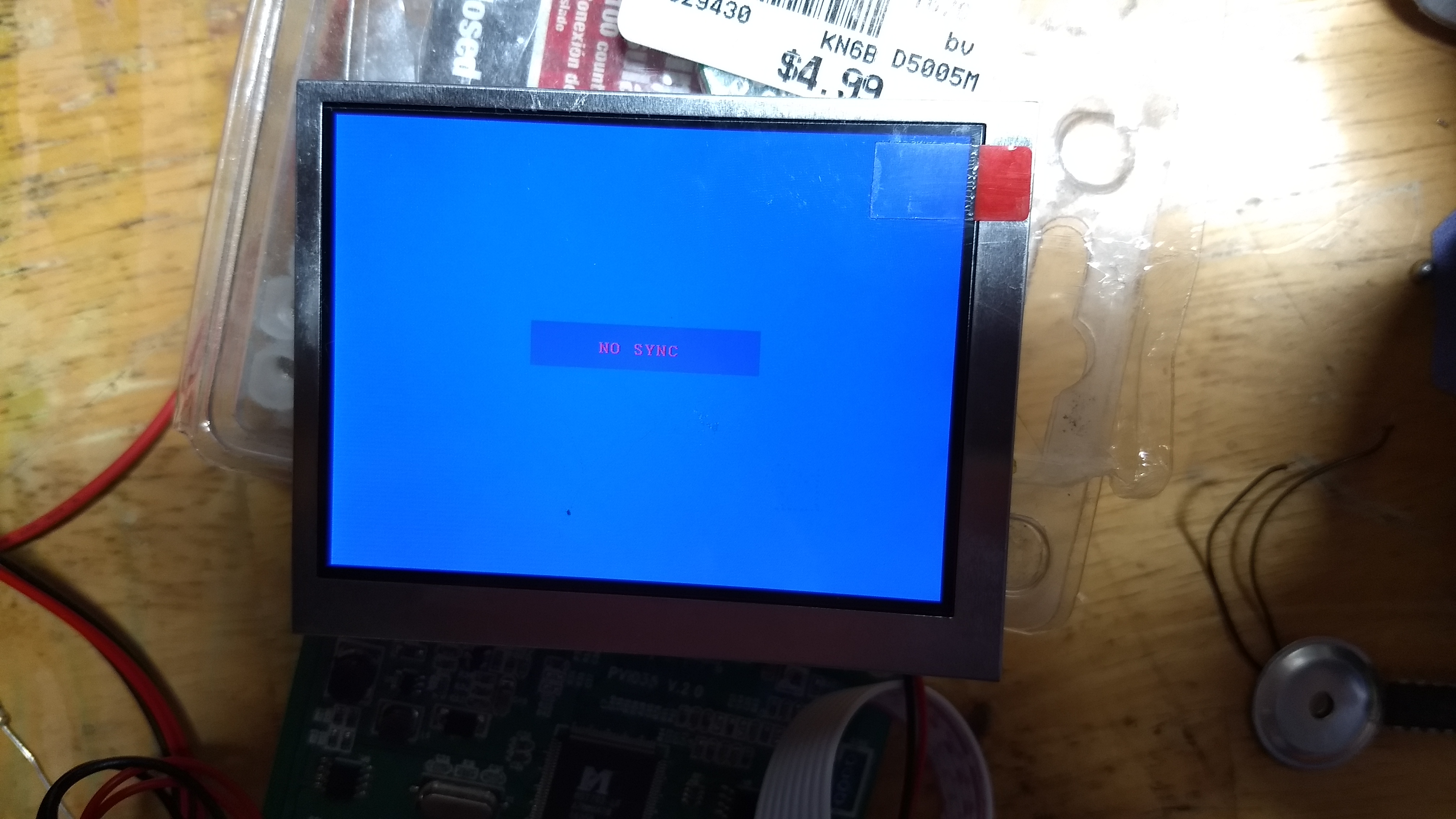

Hi guys. Hoping someone might have run into this and be able to help me out.
I got this screen and board in today. I plugged it into my zero with a hdmi to vga converter and it works great. I got to playing around in the menu system of the screen and adjusted the horizontal adjustment. The display went blue and reads [NO SYNC] now. I tried to get back into the settings to change the horizontal adjustment back to 50 but the option for the adjustments are not on the menu any longer. I can switch from av to vga, rotate the screen, adjust brightness etc. but I can not find a way to undo what I did. I hoped that disconnecting power to the board would reset it but no such luck. Has anyone else had this issue?

Hex wrote:
Fri Oct 13, 2017 5:21 pm
@Yahmez post some photos
Here is the NO SYNC error when the input is VGA.
Here is the screen menu where there used to be adjustments for horizontal and vertical adjustments.
