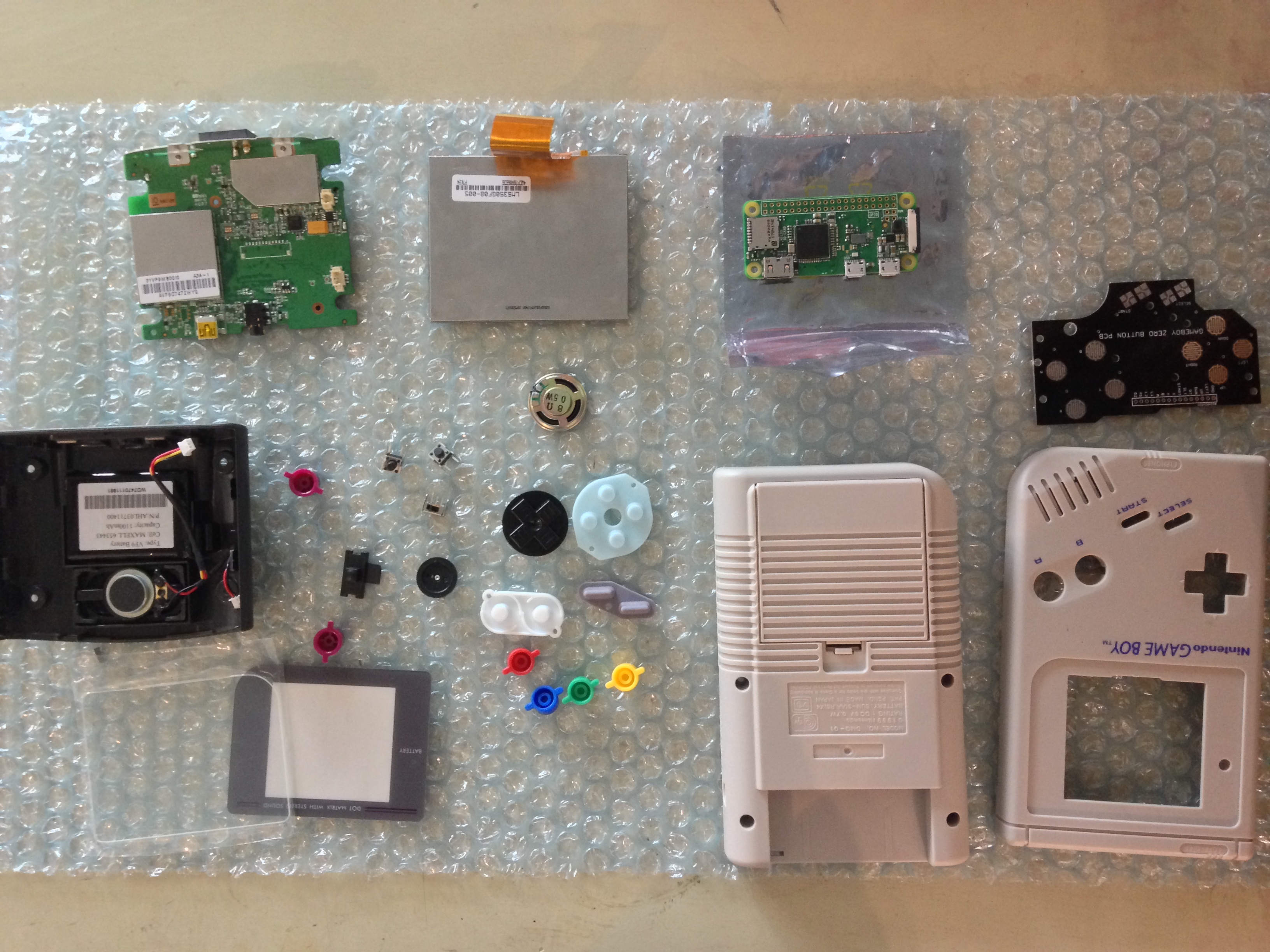

Hello guys,

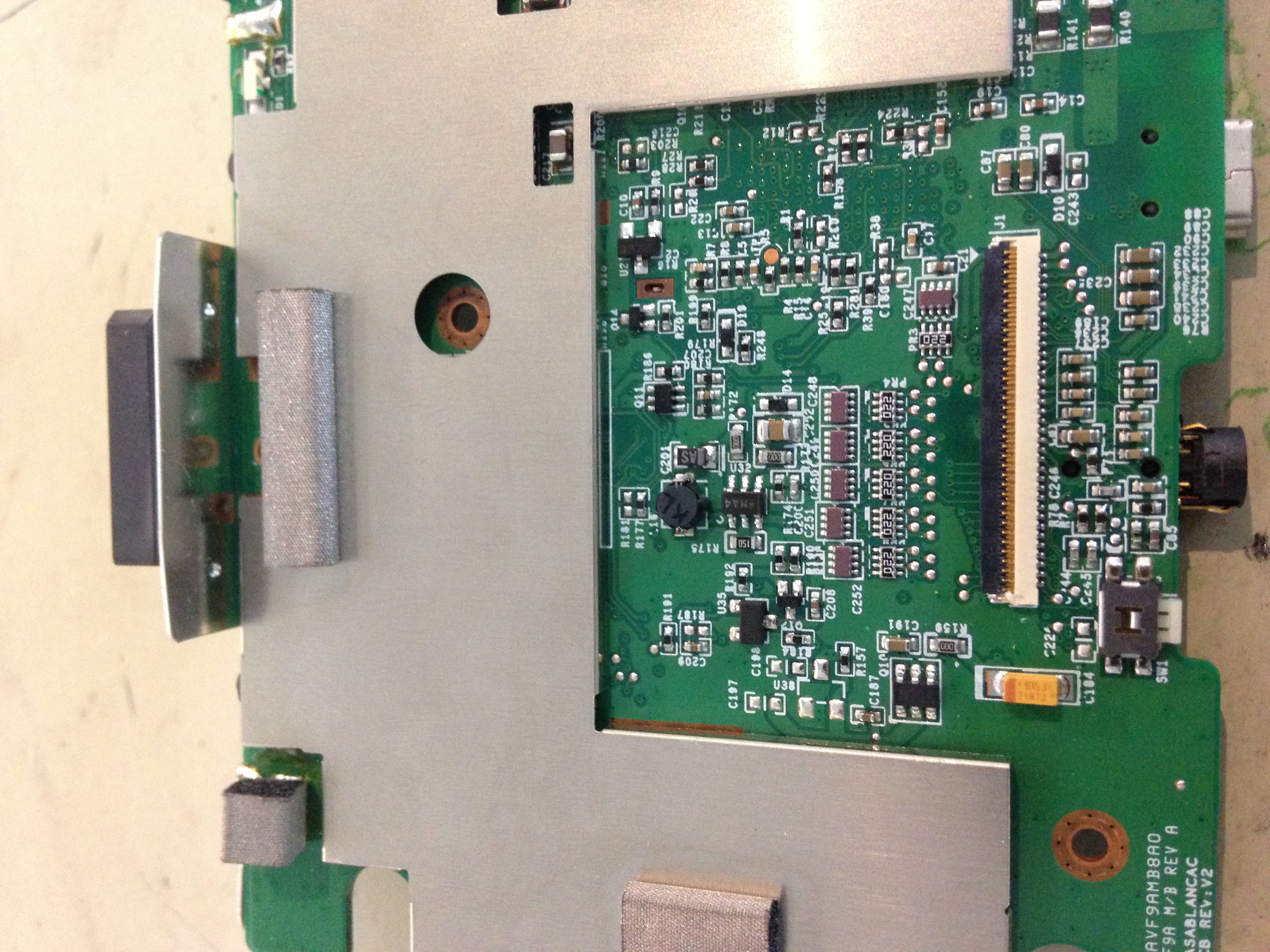

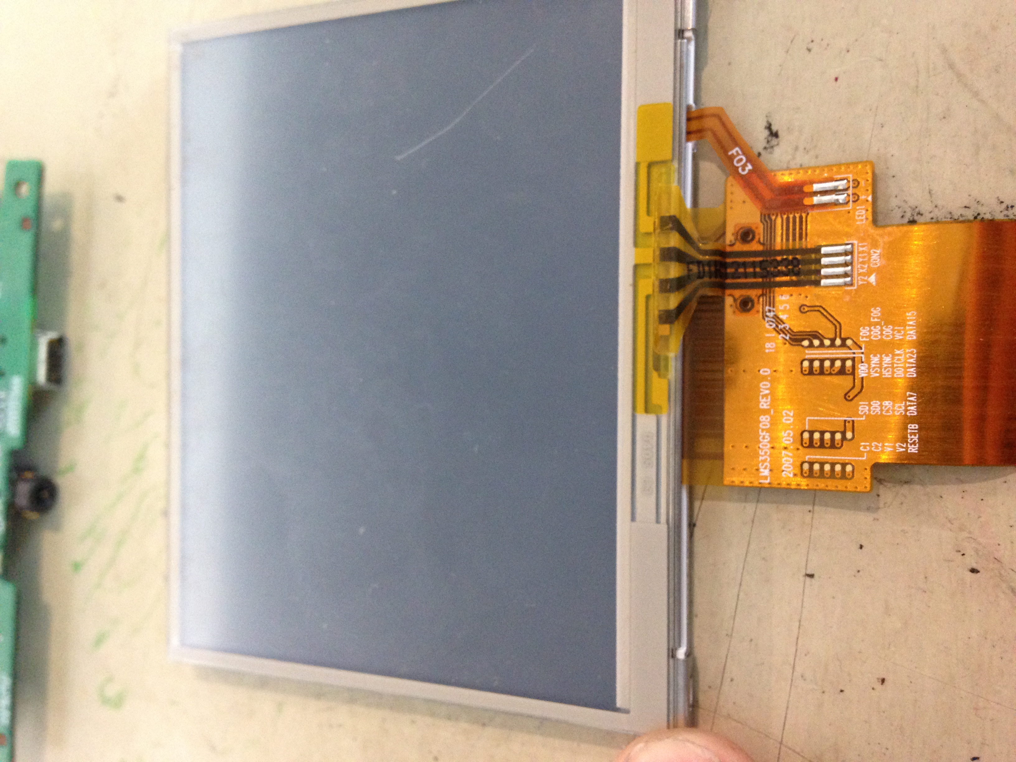

i have bought some stuff from Dinsyarcade.com and have a old screen from a "Tomtom One Edition 3".
I have no idea how to attach the screen to the Raspberry board.
Neither i know how to charge the external battery. Do i need one of those "Powerbooster" boards? Or can i just attach the battery to the raspberry directly and charge it then over the onboard power input?
What i want to do with my build:
- Have a speaker and a 3,5 headphone jack and a volume wheel
- play the games on the big TV (probably just with the miniHDMI port on the Pie itself)
- Play on the go in the original "Game Boy" case
Here is a pic of all the parts i have so far.
Thanks in advance.
Best regards
Kim

Yes you will need a charging module, applying direct current without a BMS (battery management system) will 100% lead to battery burn/explosion/blow... and 100% not charge it !

You also cannot use that LCD unless you want to make your own PCB for it, you'll need to buy a new one (3.5" reversing screen)

The first two pics i posted is the PCB from the screen. But how do i know which contacts i need for AV and sound?

You cannot use that LCD, you need one that can take composite input, which that one can't (because it is a TomTom device, not a video player screen)Namelesshero wrote: ↑Mon Sep 18, 2017 2:48 amThe first two pics i posted is the PCB from the screen. But how do i know which contacts i need for AV and sound?

I found some pieces that i would order.
Could somebody explain whats the difference between the below charging modules?

Your first link is a module that will charge a battery, it will not output 5V to power the system, you will need a separate booster for that. Something like this:Namelesshero wrote: ↑Wed Sep 20, 2017 7:02 amI found some pieces that i would order.
Charging module:
http://www.ebay.com.au/itm/10x-5V-Mini- ... SwA3dYRUvR
https://www.adafruit.com/product/1944
http://www.ebay.ca/itm/5V-USB-Output-DC ... 2749.l2649
The second link will charge a battery and output 5V to power your system, although, you are better off buying a powerboost 1000 charger, and not the 500.
What I would buy is this, it's cheaper and does the same thing as the adafruit powerboost, i have successfully used 4 of these and have plans to use a few more:
https://www.banggood.com/37V-Liion-Batt ... 37201311DI
