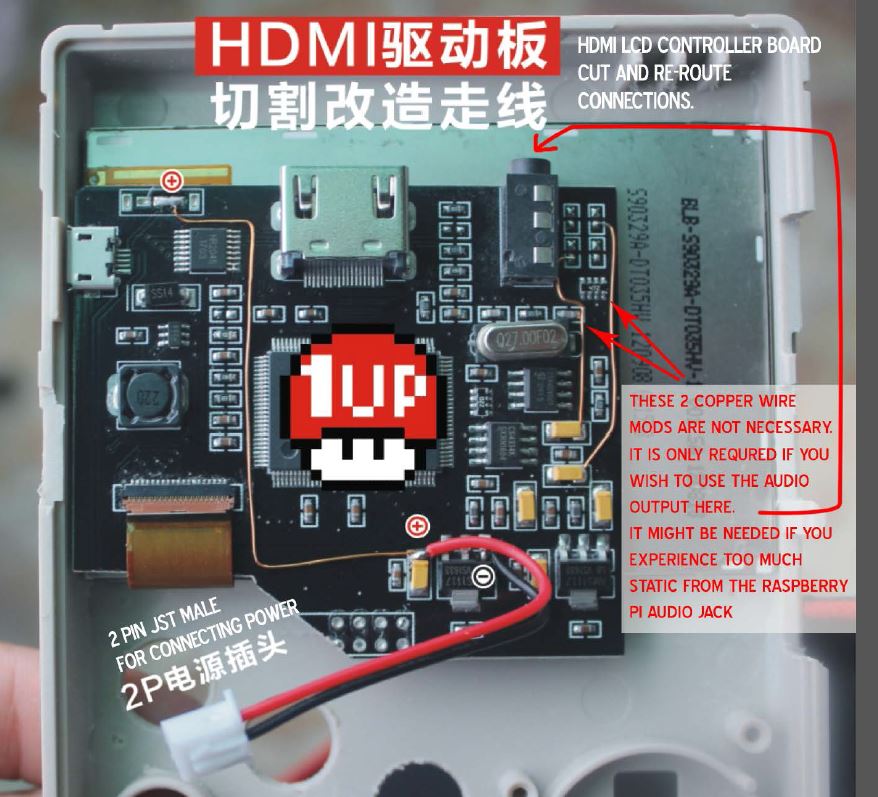

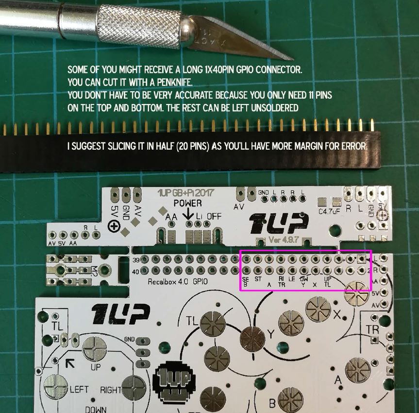

Hi everyone, I've meddled with this kit for abit and gotten alot of feedback regarding the guide. Basically there's alot of things the guide wasn't so clear, and even I am not that clear in the beginning. I didn't get right the first time and I'm back to right some wrongs with this new guide. As you know 1up is a chinese company and culturally, they aren't very western thinking. They have been bootstrapping constantly and some of you buying from them will realize they'll give you items that's different from their guide.
I have been bitten quite a bit with some of these issues, so I did a community edition guide for all of you guys who are having problems and also help with understanding what you're actually doing.
The guide will keep on improving as more tips and tricks come up.
https://www.dropbox.com/s/hldjtmignz73h ... 1.pdf?dl=0
next version will have wiring regarding the voltage drop when you use AA batteries to power the board.
Here's some insert previews for people who have the slightly older guide.
