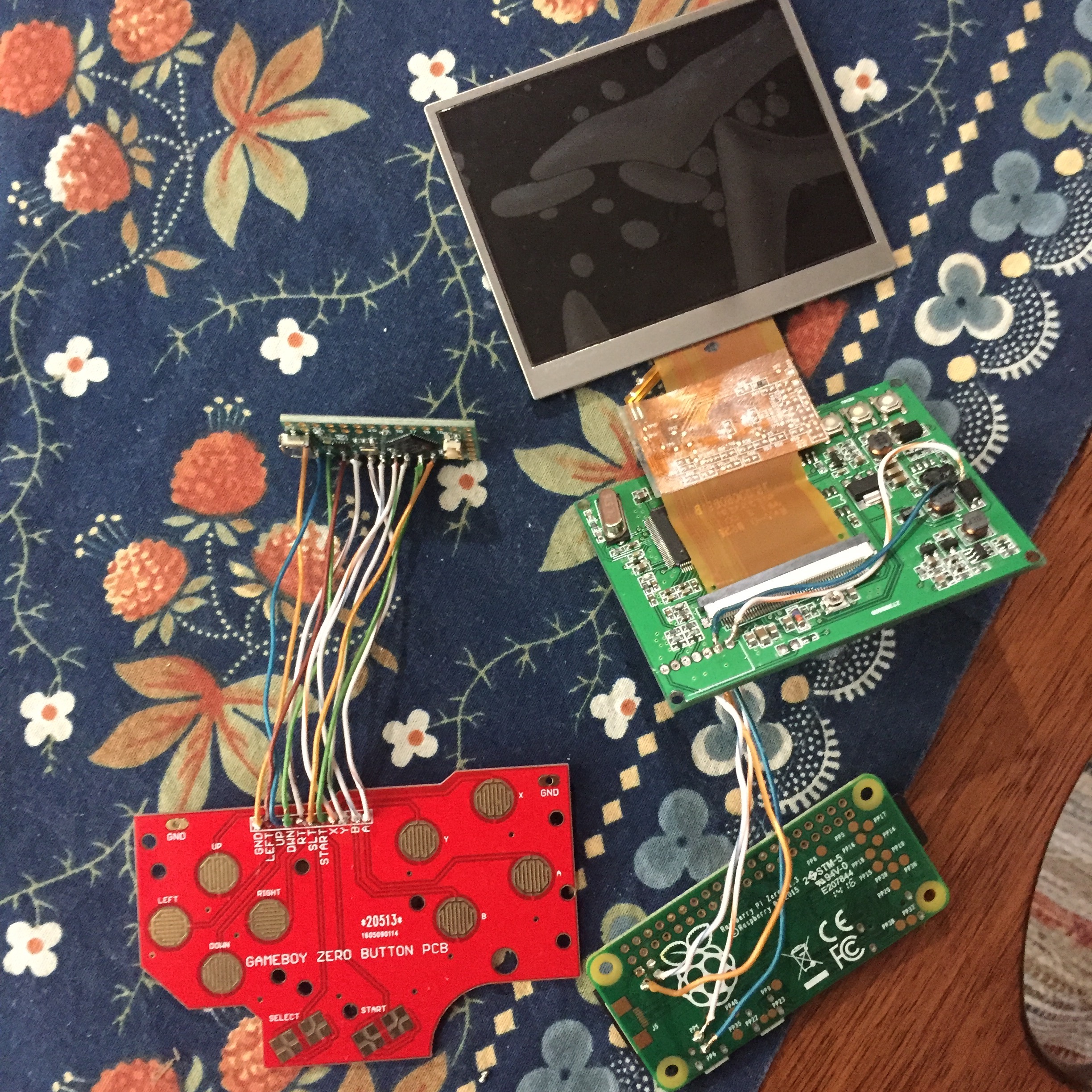

where am I drawing a blank on connecting the PiZ to the Teensy?
Right now I have
Screen Board -> PiZ
PCB Button Board -> Teensy

This is what I have currently

Aren't you supposed to connect them vias USB?

after you have programmed the teensy you need to add 4 wires under the teensy connector to the pi usb (pads under the OTG connector) and wire the 5v from the pi or from a power supply (power board) :) have a look in the show-off area or the guides, (or just check my first gameboy mod in my sig)
