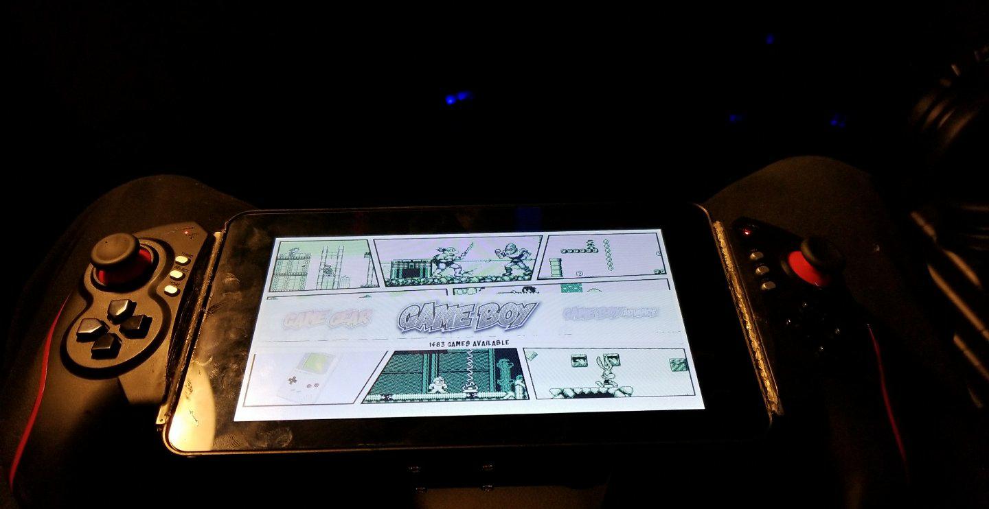

This is the monster I'm building it's my first build of a retropie. The battery monitor isnt needed but will make it easier/safer for shutdown and prolonged use to prevent random shutdowns and possible corruptions.
- received_2229406553752153.jpeg (86.12 KiB) Viewed 8679 times

Nice.....cainkirisgai wrote: ↑Sun Jan 21, 2018 1:53 amThis is the monster I'm building it's my first build of a retropie. The battery monitor isnt needed but will make it easier/safer for shutdown and prolonged use to prevent random shutdowns and possible corruptions.
looks like it could be a really cool build.....
theres been a couple of members that have talked about doing something like this....
so it will be nice to see one completed....

It's all functional using a Bluetooth controller, I mounted 2 8ohm 3 Watt speakers on the back and installed a small fan on the bottom to keep it cool as it was giving me the overheat warning. Installed a push button on the side for quick on/off along with 2 push buttons on top for volume controls wired to the adafruit audio bonnet. And using a pb1000c and pb1000b to connect a 3800mAh battery to it. Again this battery mod isn't vital but I feel it would complete the build as then I can tell when to charge it. Only thing I feel I need to do after getting this to work would be to make my own case to slim/flatten out the back, it still feels pretty light but I've been contemplating removing the USB inputs along with the Ethernet port to slim it down more to allow me to put the boards and battery inside it. So again thanks for all the help and advice, I'm hoping now that I got some sleep and time I can look at the layout u provided with a clearer mind and not over think it heh heh.
