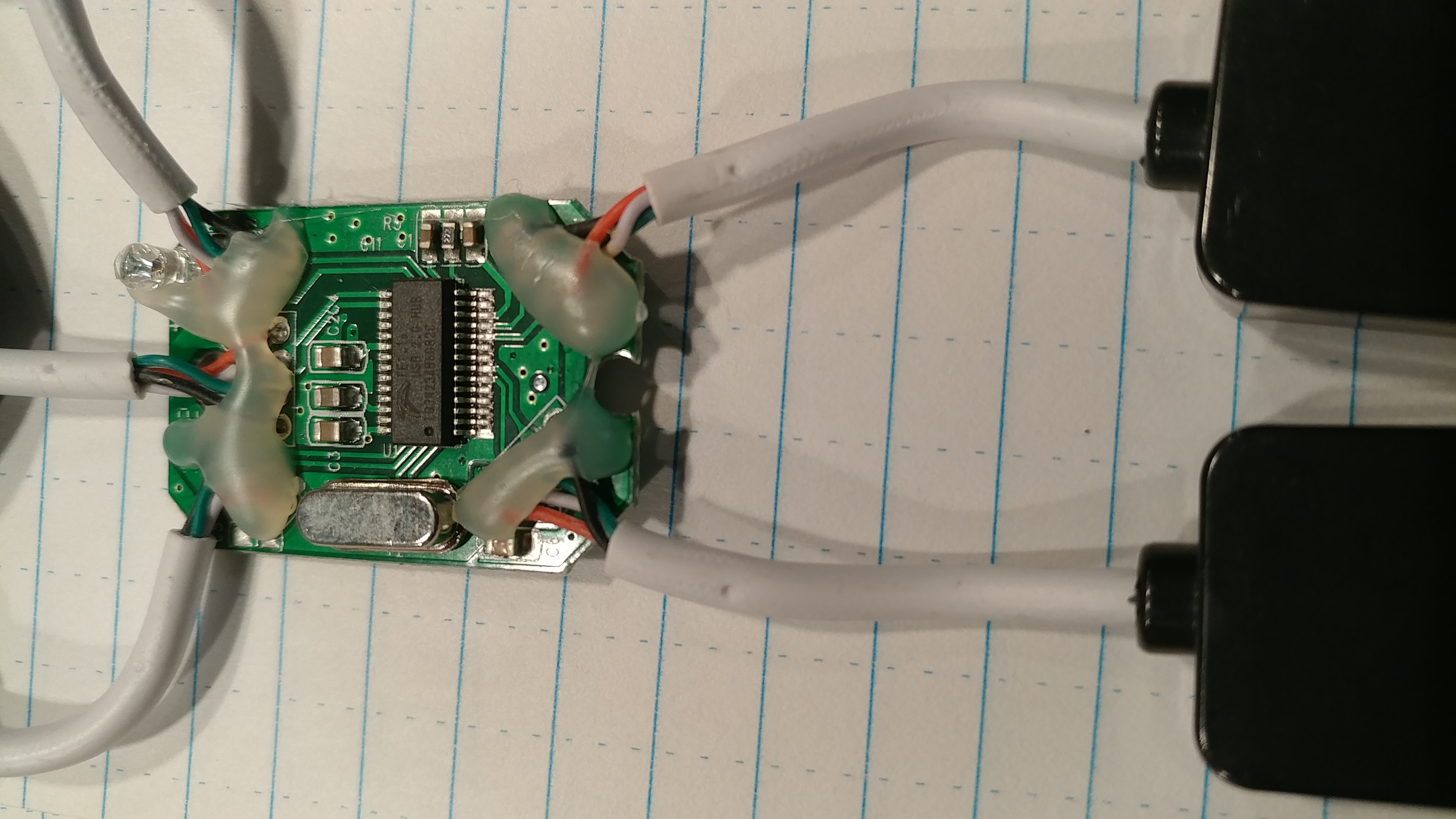

I have these for both my gameboy zero build and my nes controller build and so far both are suffering from the same issue.
1) plug the hub into the pie, everything works like it should, runs two controllers and a keyboard no problem.
2) strip it and wire it up to my pi with the teensy hooked up to port 1. Power the hub and teensy lc from the power strip. Run port two to my full size usb port and power it from the power strip.
3) only detect my teensy lc controller, nothing is detected on my second port (regardless of what is plugged in, and all of the devices worked before).
4) bridge the otg connector (pins 4 and 5). Still won't recognize additional devices.
Lusb shows a 4 port hub connected with only the teensy lc connected.............
Still trying to sort out why it won't work.

I should also note I forced USB 1.0 and I still have no success. I am fairly new to the programming end of things. Any pointers would be greatly appreciated.
Results of LSUSB
^[[Aroot@retropieaaa:~# sudo lsusb
Bus 001 Device 003: ID 16c0:0482 Van Ooijen Technische Informatica Teensyduino Keyboard+Mouse+Joystick
Bus 001 Device 002: ID 1a40:0101 Terminus Technology Inc. 4-Port HUB
Bus 001 Device 001: ID 1d6b:0002 Linux Foundation 2.0 root hub
root@retropieaaa:~#

[    2.269020] usb 1-1.2: new full-speed USB device number 4 using dwc_otg
[    2.368984] usb 1-1.2: device descriptor read/64, error -71
[    2.406401] systemd[1]: Cannot add dependency job for unit regenerate_ssh_hos         t_keys.service, ignoring: Unit regenerate_ssh_host_keys.service failed to load:          No such file or directory.
[    2.413594] systemd[1]: Starting Forward Password Requests to Wall Directory          Watch.
[    2.414530] systemd[1]: Started Forward Password Requests to Wall Directory W         atch.
[    2.414754] systemd[1]: Starting Remote File Systems (Pre).
[    2.591123] usb 1-1.2: device descriptor read/64, error -71
[    2.808996] usb 1-1.2: new full-speed USB device number 5 using dwc_otg
[    2.872822] fuse init (API version 7.26)
[    2.909001] usb 1-1.2: device descriptor read/64, error -71
[    3.129011] usb 1-1.2: device descriptor read/64, error -71
[    3.348985] usb 1-1.2: new full-speed USB device number 6 using dwc_otg
[    3.788969] usb 1-1.2: device not accepting address 6, error -71
[    3.888969] usb 1-1.2: new full-speed USB device number 7 using dwc_otg
[    4.328994] usb 1-1.2: device not accepting address 7, error -71
[    4.329248] usb 1-1-port2: unable to enumerate USB device

Pics of the hub and the install.

Post by garthster » Sun Feb 11, 2018 8:34 am
Appjunkee,
Have you had a chance to splice the hub into you SNES controller?
The one I used for NES controller build was tested as you described and worked fine on my test pi (all pors functioned with a keyboard and three gamepads). As soon as I hard wired it to my pi, only one port will work, same as my gameboy zero build. I also tried bridging the otg pins and forcing USB 1 to no avail. Similar error messages to the ones I posted.
I am curious to see if you have the same issue.

Yes i had the same problem from what i read this usb hubs are super sensitive to heat. Im going to buy a few more and see if I find one with all the ports working again. Then I will solder to the wires in stead of the actual board to see if the heat is what fried the chip. I wont have time to go buy more till later this week if not the weekend.

Post by garthster » Tue Feb 13, 2018 7:34 am
I tried again.
I left my teensy attached to port one as it was working.
I changed from port 2 to port 4 for my sub out connection and now it works ??!!!!!??.
Not gonna worry to much about this, the two ports I need are working now with this very cheap solution.
