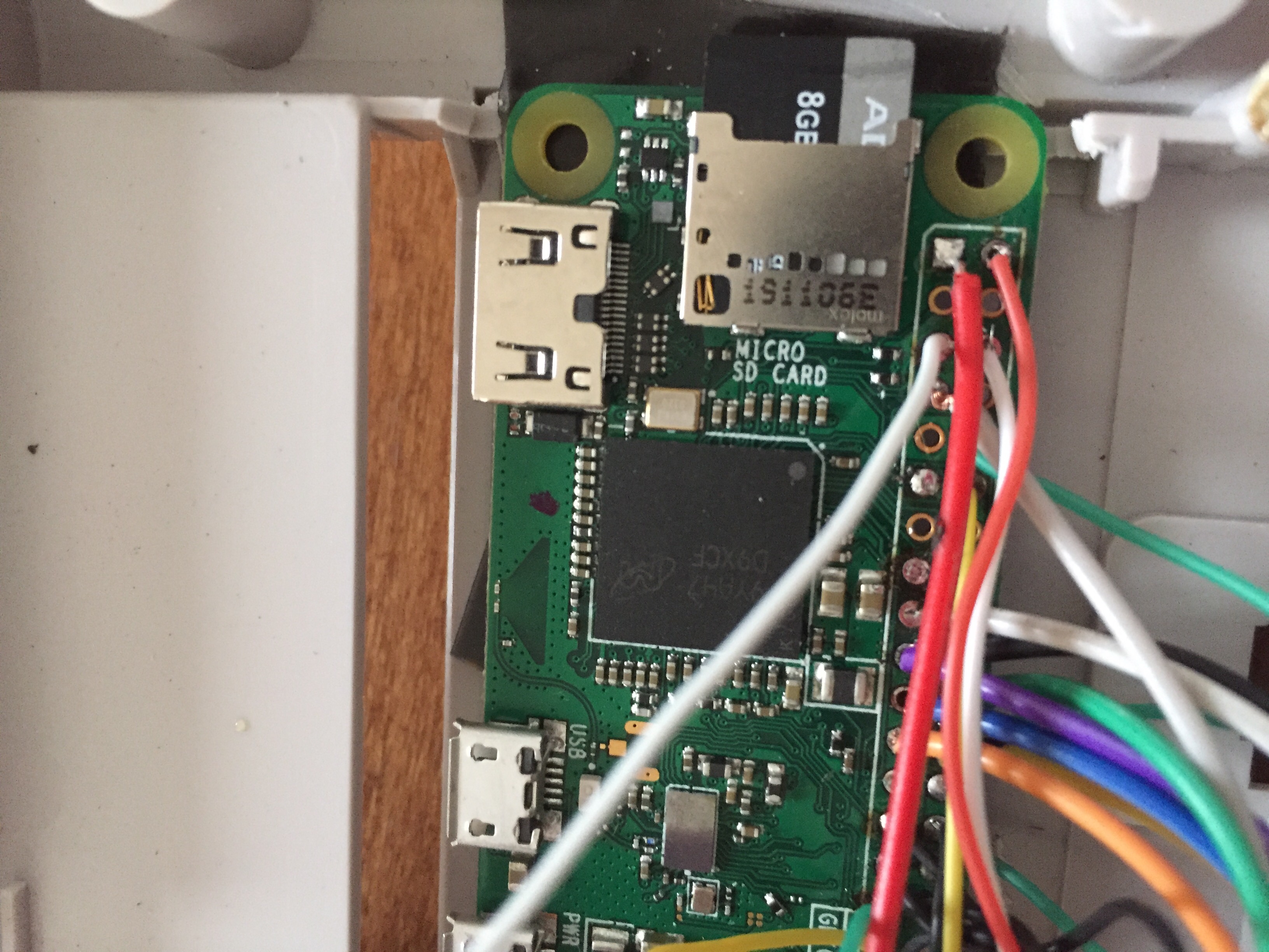

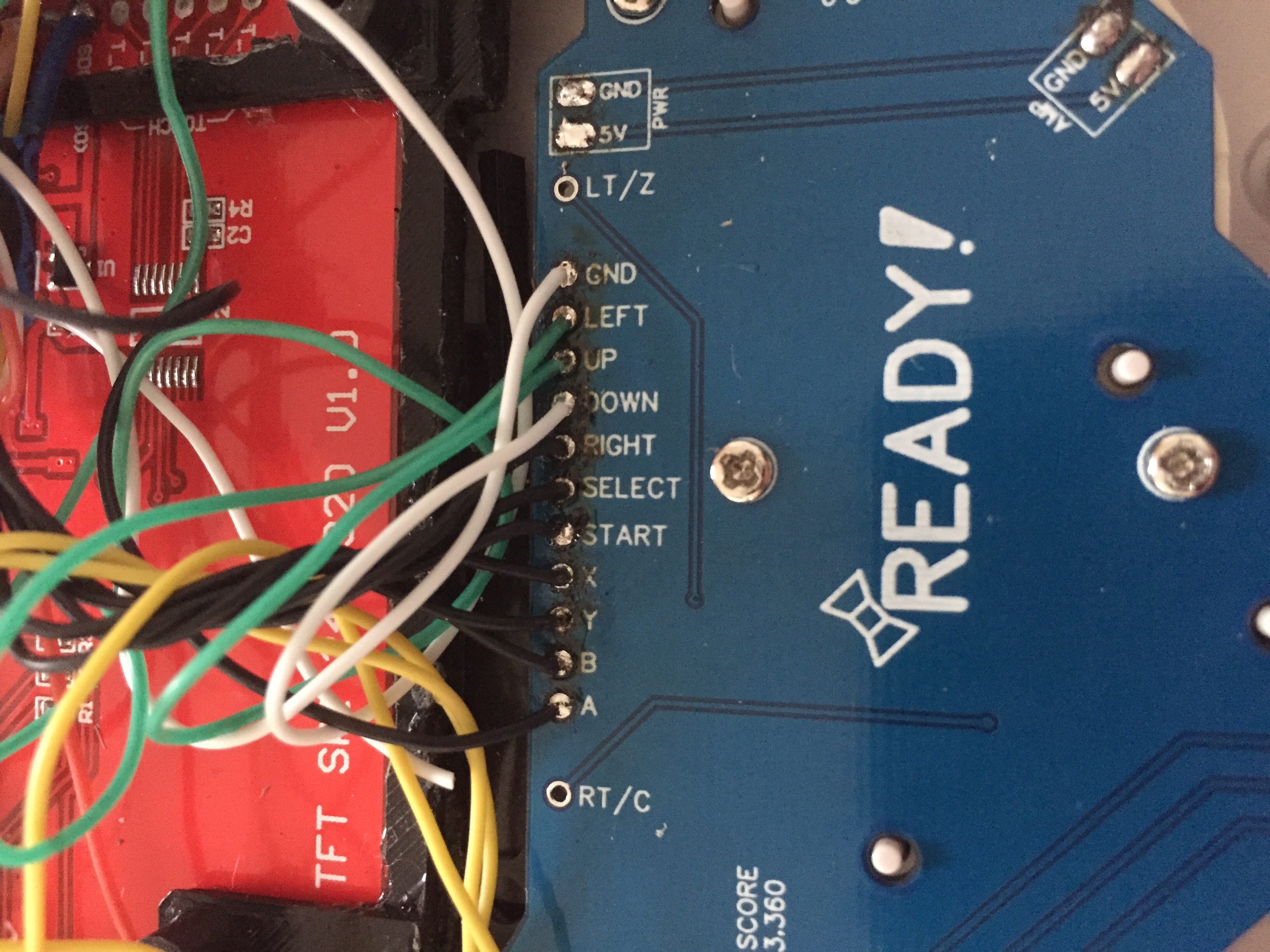

So I’ve finished my first build and it’s worked quite well for the most part up until now. The down dpad no longer works and when I press select it makes everything extremely laggy, buttons mushy, and degrades overall performance. I’ve checked continuity, used alcohol on the pads, switched GPIO’s and wires I am royalty stumped here. All help is appreciated :)
The one on GPIO 3 is down.

So I’ve finished my first build and it’s worked quite well for the most part up until now. The down dpad no longer works and when I press select it makes everything extremely laggy, buttons mushy, and degrades overall performance. I’ve checked continuity, used alcohol on the pads, switched GPIO’s and wires I am royalty stumped here. All help is appreciated :) 20571AE4-5672-48AF-B2D1-B0476976067A.jpeg636C9827-20B5-4622-BB56-5605644FBC68.jpeg
Are you running your audio through the button board? I’ve seen that ground cause issues on the buttons like that. Rerouting that ground directly to the headphones fixed mine.

What headphones? I have the ground as of now going to my power assist, are you saying to have it go to the headphone jack or speaker portion or what?

there's a spot on the button board to the left that allows you to route the l/r sound and ground to the headphone jack and the speaker. i've just found that running the ground wire outside of the board helps with button input issues like you describe.

So I’ve done that and now the button works, YAY! However it’s pretty mushy now.
