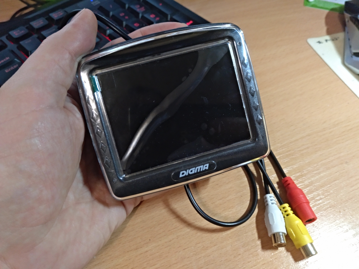

SergioPoverony
Posts: 9
Joined: Mon Jun 17, 2019 5:17 am
Post by SergioPoverony » Sun Nov 03, 2019 1:58 am
China monitor selling in Russia - Digma name, i think more this.

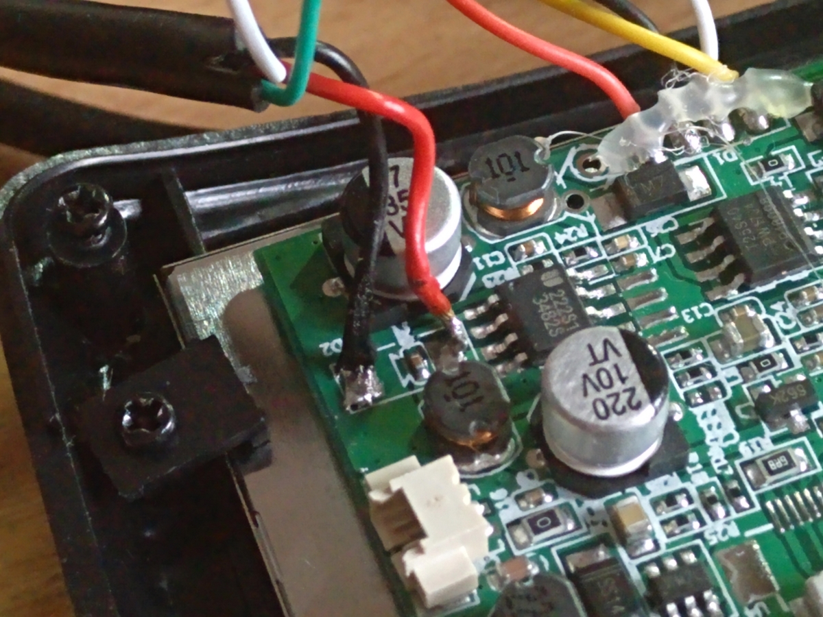

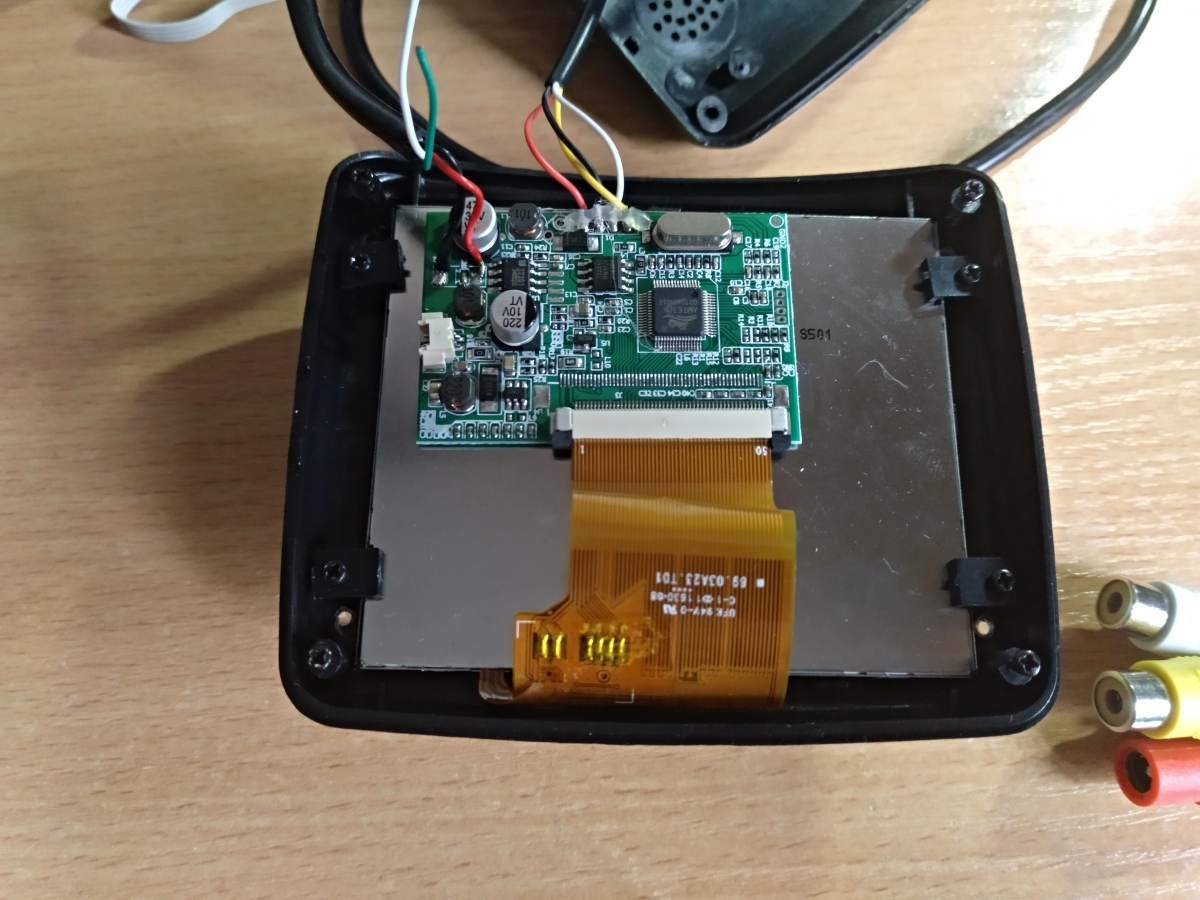

Sorry for the late update. I've had things to do and just now got to this..
These quotes from the eBay reviews are accurate. There are two JRC 2360A regulators on the board, the one closest to the outside of the circuit has ~5V coming out of pin 2. I assume this feeds into the rest of the circuitry, so this should be 5V moddable if my one assumption is right. If you screw up the cable and need a new one, a 4 pin JST 1.25mm spacing cable will fit in there as long as you shave down one of the retaining nubs a little bit.
