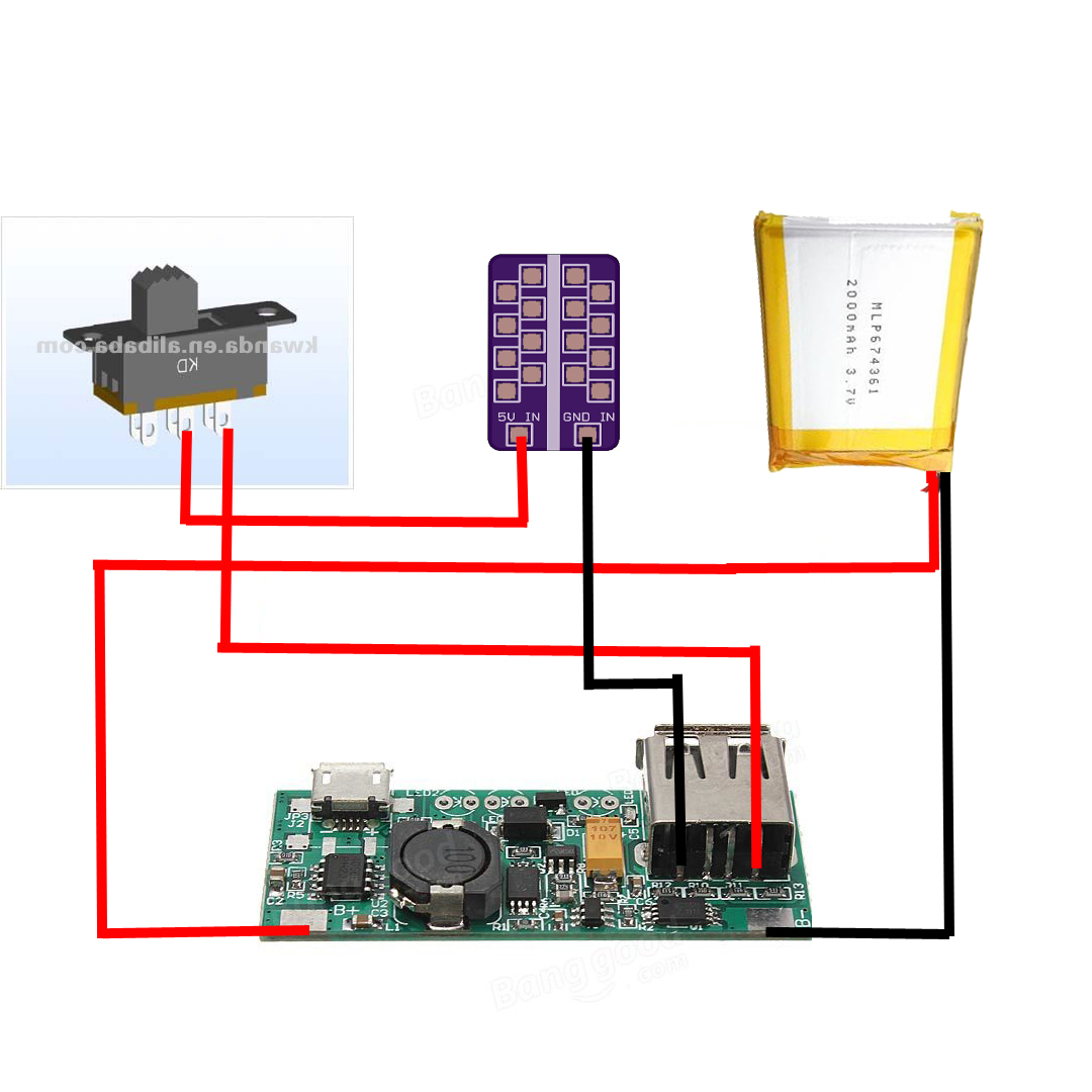

thanks for the input. i went back to basics and had the following set up but missed off the powerstrip just had it direct to the pi. left it on for a few hours and just got warm/not hot. obviously had no screen/controller or anything else so it shouldnt.
i feel like it has to do with everything connected to the powerstip?
Banggood Power Supply Wiring.jpg (344.24 KiB) Viewed 10334 times

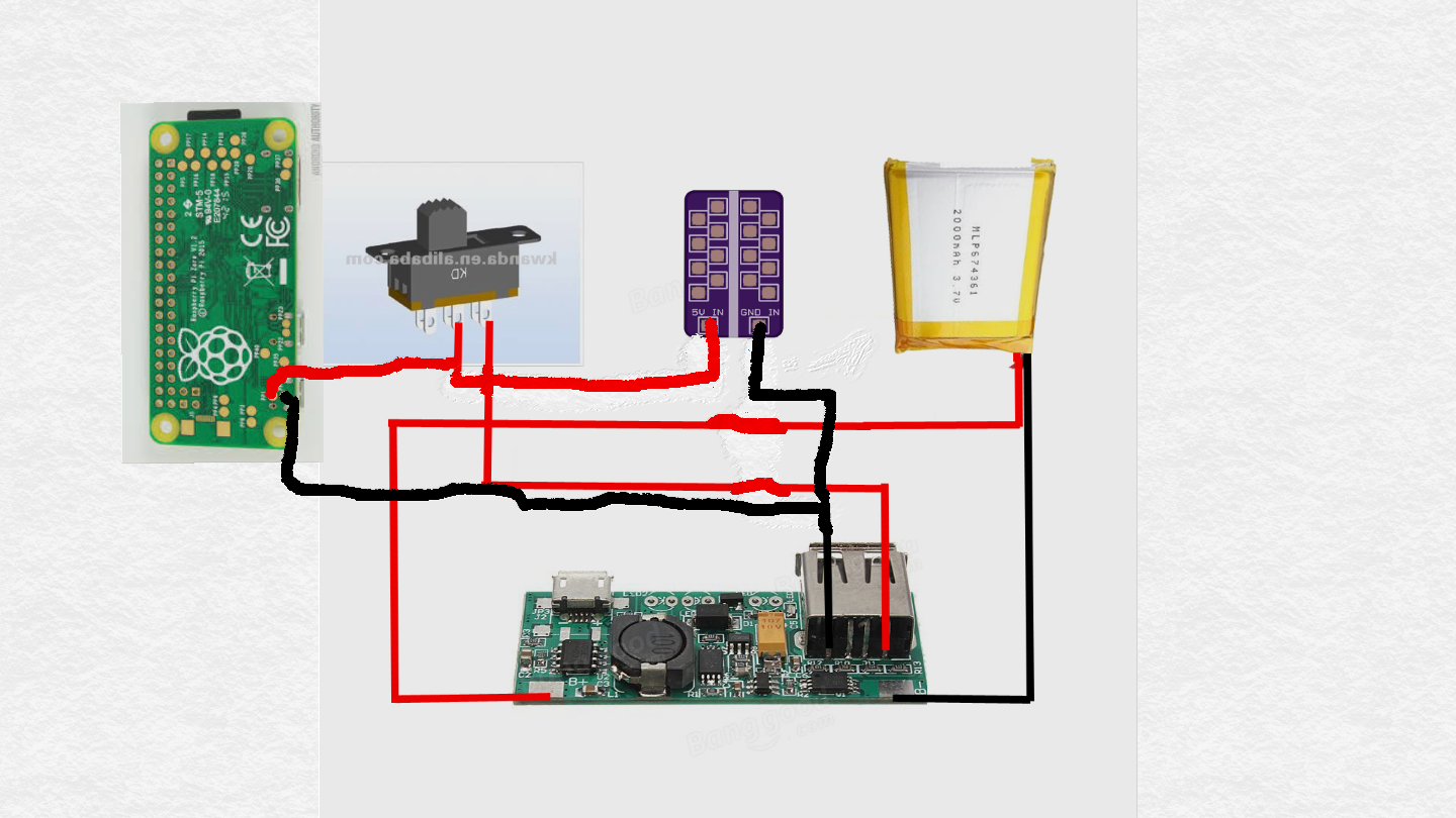

so i have made a "very" rough pic below, does anyone see a problem with me powering my pi direct as above than also have seperate wires coming off the powerboost to a seperate powerstrip?
so the pi gets wired direct and than seperate all the other bits draw there power, screen, usb hub and rest?
