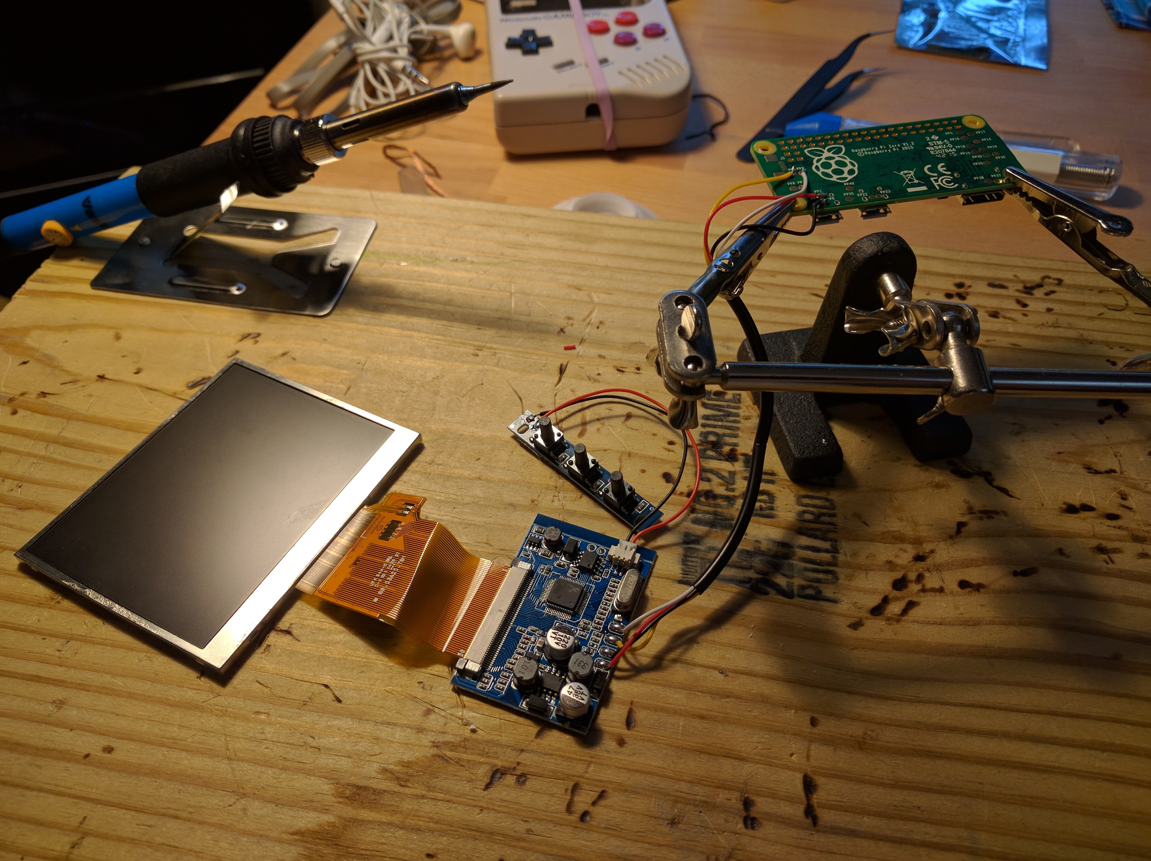

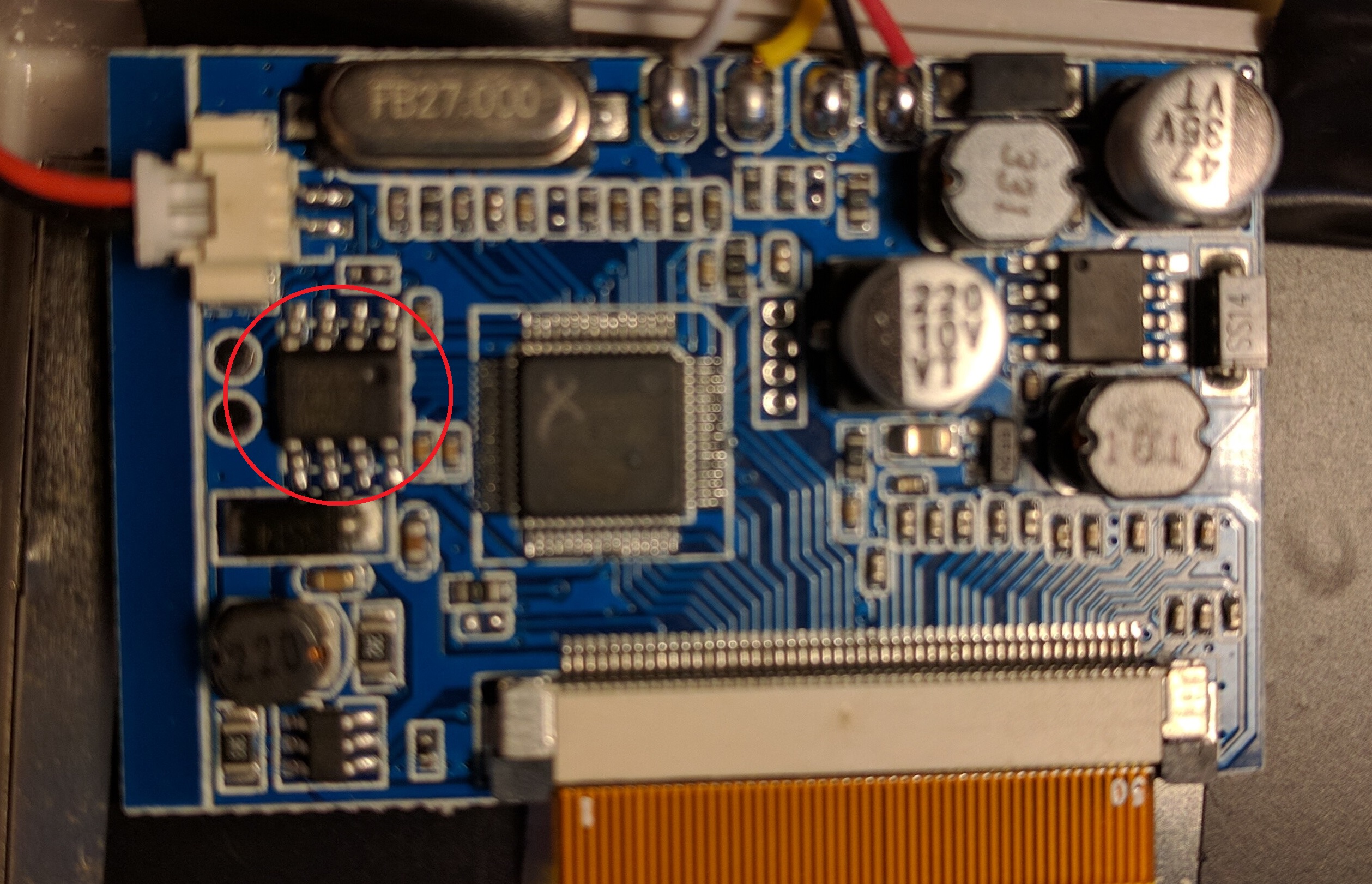

I tried to get the Niceshopping screen and I heard others say it runs off 5V. So I went a head and connected it up to the pi0 and test it out with no luck on anything showing on the display. Any ideas guys?
FYI, this is the only chip that has writing on it. Not sure how to tell if this needs to be removed to get 5V
t25s40
bc16f7
p0u552

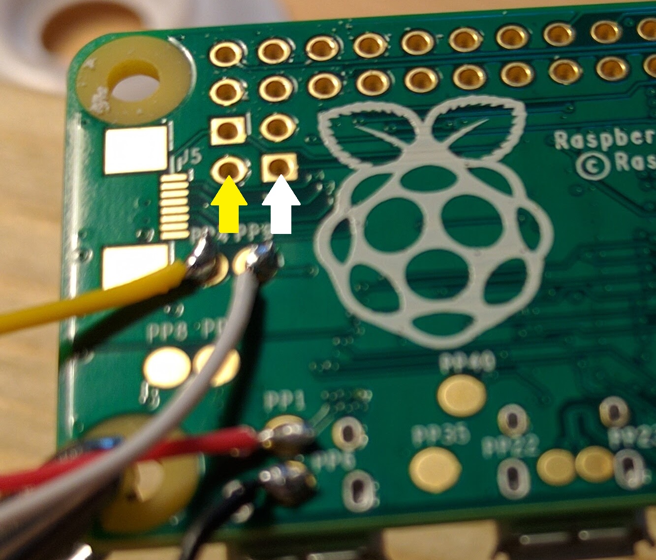

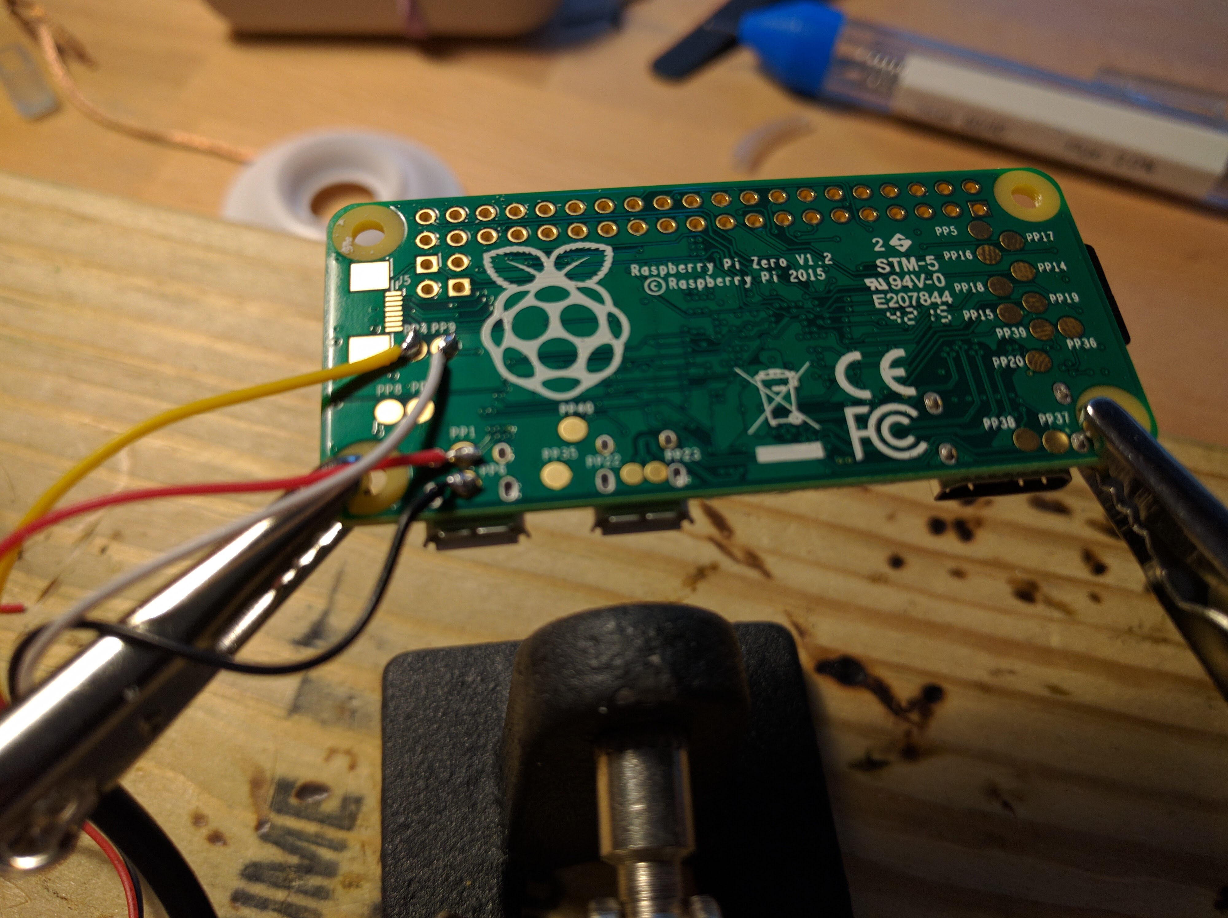

I think I see my problem....
ktechelonbreak
Posts: 78
Joined: Wed May 04, 2016 10:07 pm
Re: Video
Post by ktechelonbreak » Thu May 12, 2016 5:45 pm
dirtybeagles wrote:I think I see my problem....
Actually the yellow goes to the TV composite in (square) and white goes to the adjacent connector.
