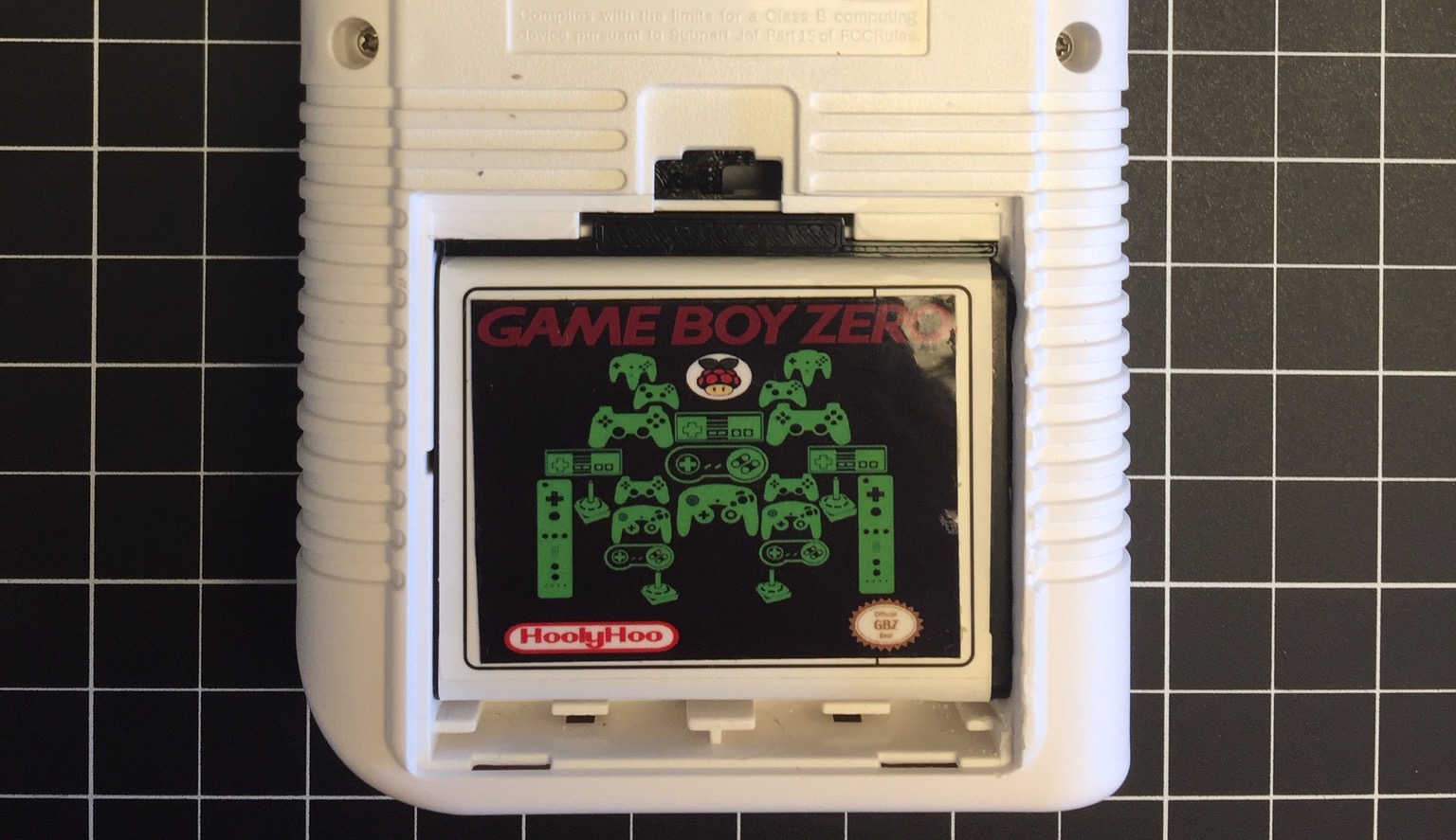

That's what I did with this 4800 mah Samsung battery that fits perfectly in the battery compartment without gutting it out. Used an old Motorola phone I had and used the pogo pins that connected to the battery and placed it in GB case. No wires attaching battery. Works great.

Bought this one. Compartment just needs to be shaved slightly (1mm) on one of the sides. :D

Yeah that double thickness is just the right height to fit and close the case without having to cut the bottom out. Capacity wise I'm waiting for it to discharge to test but I've been playing with it on kites build on and off for the last few days, around four hours is my guess, with wifi on at times and screen full brightness and I'm still showing green on the battery meter so I think it's satisfactory. :)
