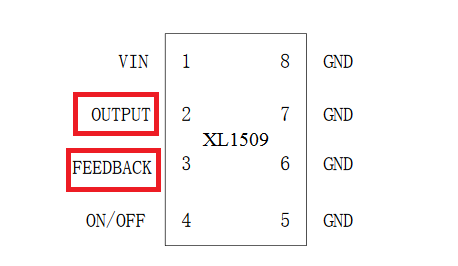

Hello,
i have the same PCB and i'll want to know where you solder the ground( black cable ). Is it on the ground of the element you remove XL1509 or to another element ?
And when i'm trying to remove the XL1509, i destroy the PCB. Red squares are the ways i removed from the PCB ...
Thanks :)

Valadone wrote:Hello,
Thanks :)
n.marek wrote:Image
The black/ground wire can go to the pin next to the TV pin, it doesn't matter.
Well, it's same as here. Are you saying you removed the chip already?

Yes, i already removed the chip.
I solder the red wire to the D4 (on the south) diode ( i think is a diode ), because i can't solder my red wire to the pin 2... I hope that is the right place because i don't know at all where the pin 2 goes.
And if someone knows where the black wire goes. I think it's on the GND of the chip but not sure

Valadone wrote:Yes, i already removed the chip.
Do you have a photo? I am not sure what the problem is and what you're talking about :D
