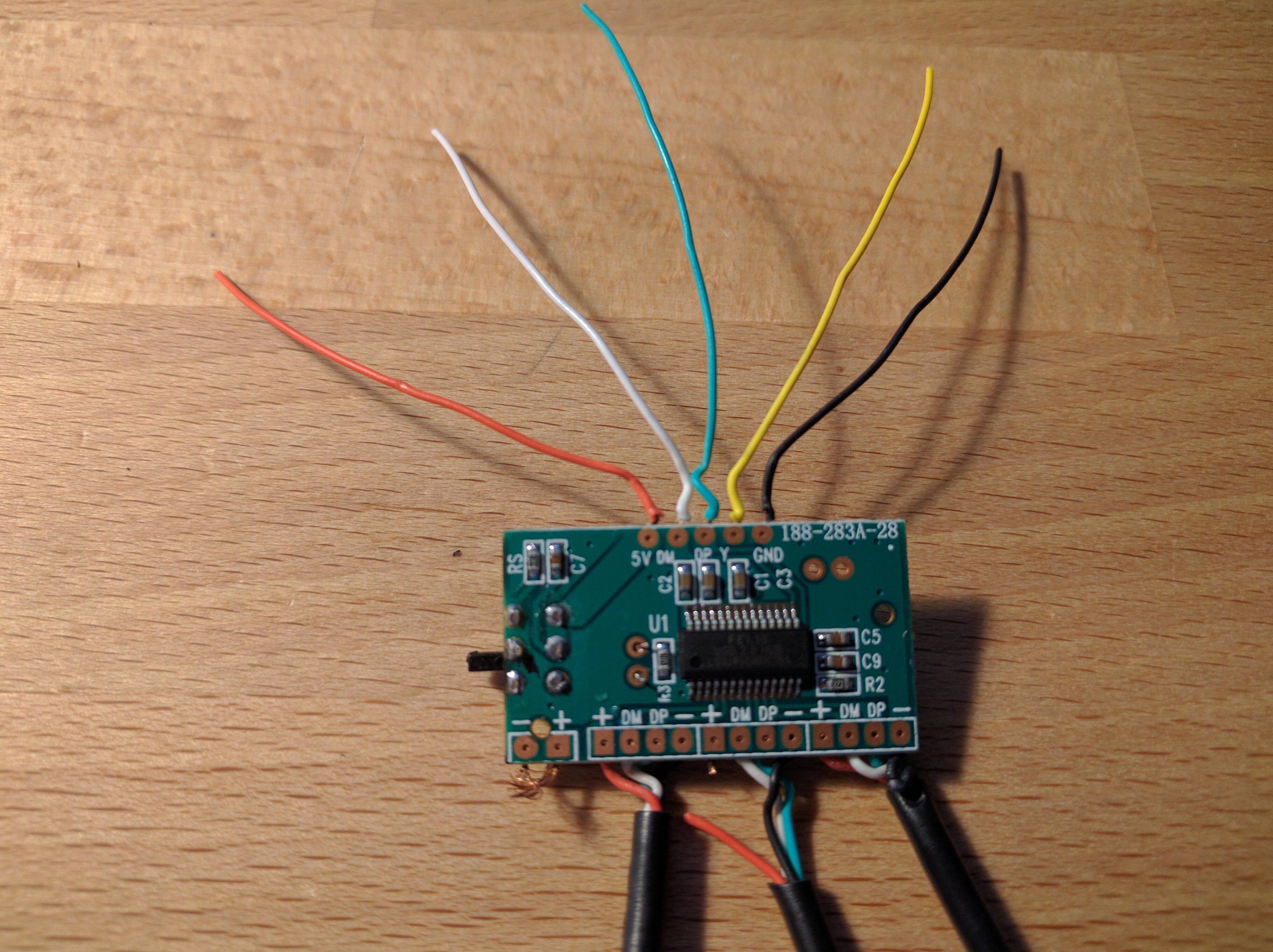

Cannikin wrote:
Robots86 wrote:I might give this similar one a try. I found it recommended on the rpi forums and i can see someone commenting on amazon confirming that it works. https://www.amazon.co.uk/niceeshop-Mult ... ge_o00_s00
Here's the inside of that one if you're curious. I cut the fourth plug off the bottom left there, that was the mini-USB input:
Do you happen to know what the yellow cable is for? I assume the GREEN and WHITE cables go to my pi0?
Cannikin
Posts: 127
Joined: Wed May 11, 2016 3:10 pm
Been thanked: 36 times
Re: USB Hub
Post by Cannikin » Fri May 20, 2016 4:45 pm
dirtybeagles wrote:Do you happen to know what the yellow cable is for? I assume the GREEN and WHITE cables go to my pi0?
So apparently the OTG standard has a 5th pin, the "ID" pin (that's the yellow cable): http://electronics.stackexchange.com/qu ... only-has-4
There's no connection for that on the underside of the Pi so hopefully we don't need to use it! Can anyone confirm we're okay ignoring that wire? Or should we run it to ground perhaps?
For green and white, you'll see those are connected to "DP" and "DM". That stands for "Data Plus" and "Data Minus". Those are standard on USB cables (although you'll sometimes see "D+" and "D-" instead). On the underside of the Pi PP22 is DP and PP23 is DM.

Cannikin wrote:There's no connection for that on the underside of the Pi so hopefully we don't need to use it! Can anyone confirm we're okay ignoring that wire? Or should we run it to ground perhaps?
Now that I have mine hooked up I can confirm that we don't need that 5th ID pin. I didn't bother running it to ground as a continuity test said it was grounded already.
