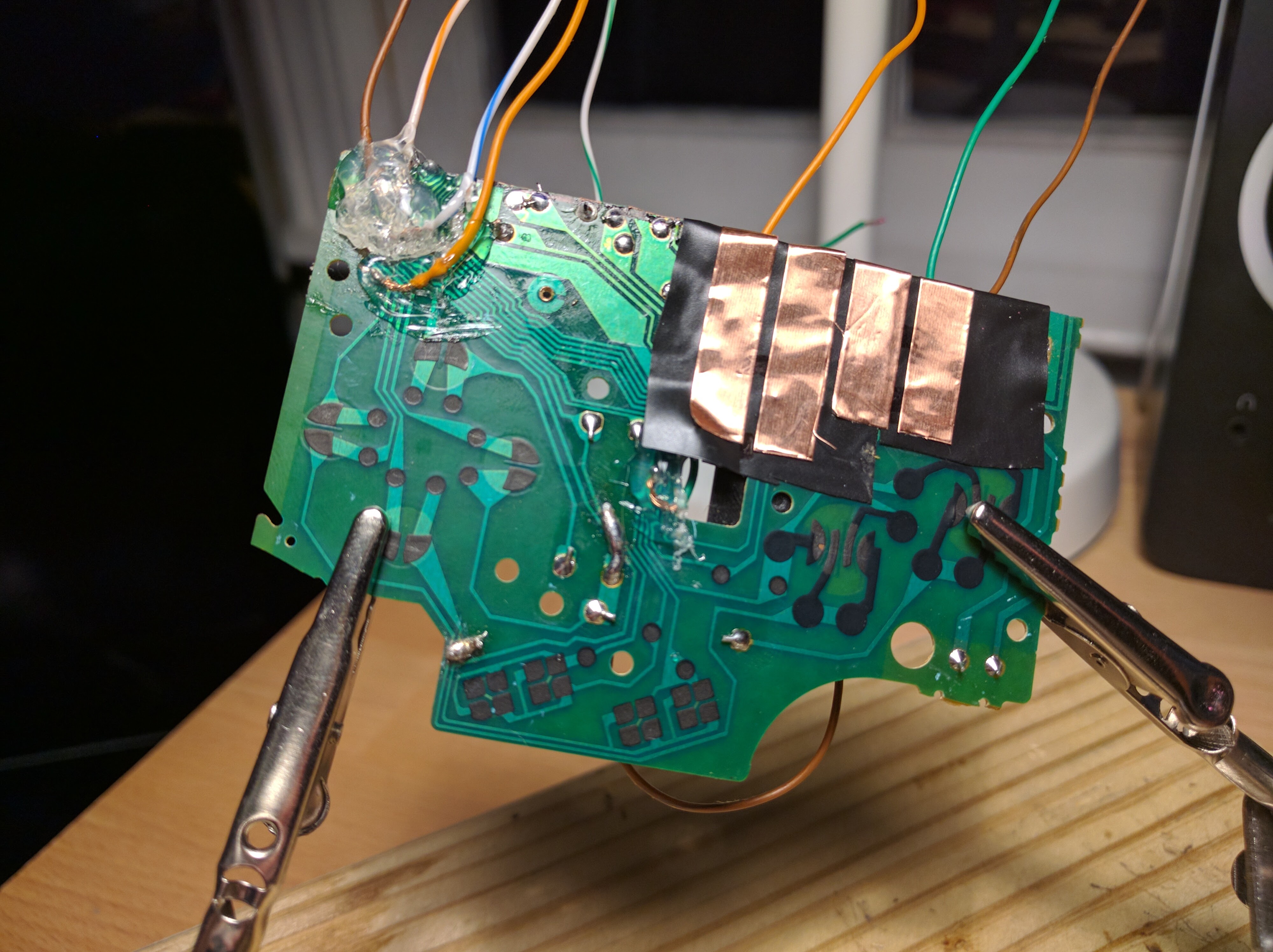

dirtybeagles
Posts: 386
Has thanked: 34 times
Been thanked: 64 times
Re: Soldering Newbee.
Post by dirtybeagles » Thu May 05, 2016 6:26 pm
:shock: :oops: :(
Well, none of them worked...
I may know where I went wrong, so if someone could answer some questions about scratching off the tracers.
1. Do I need to scratch off the scrappers until I see copper?
2. Do I need to have the tip of the wire touching the tracer, or can solder complete the connection?
I guess a tip for someone new is to just scratch off ONE tracer and solder a wire and test before doing the whole board :(

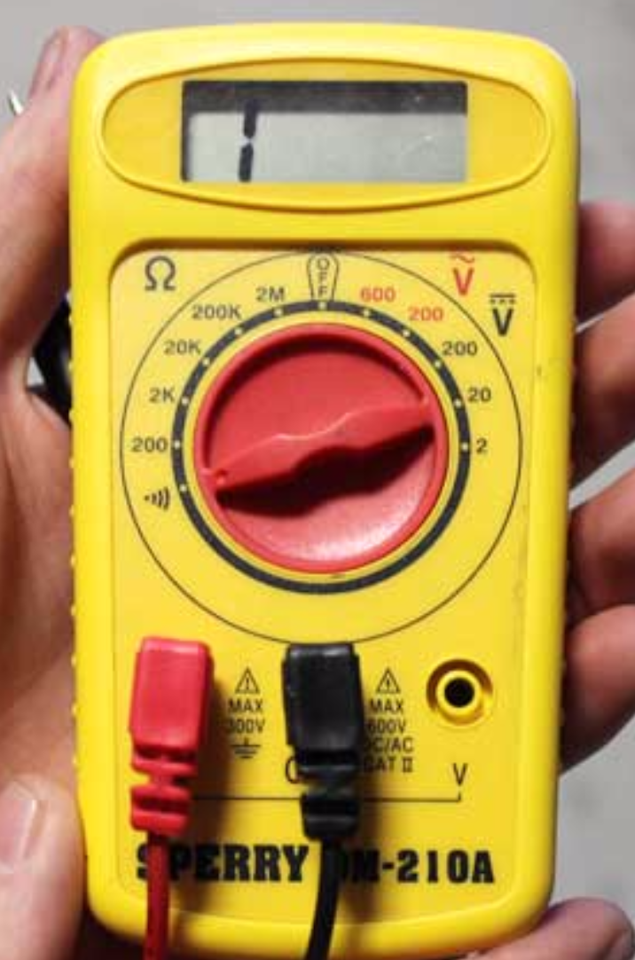

So I guess I did not set up my Multimeter correctly because I was not getting any reading at all when I switched it to COM. I then pressed the HOLD button and I started getting readings. Good news, I think my soldering worked the first time. My A and B buttons work great. Bad news is that I went a head and disconnected my directional pad wires.... :lol:
Oh well.
So anyone who buys this:: http://www.amazon.com/Etekcity-MSR-R500 ... ge_o00_s00
I believe once you set it to COM you need to press the HOLD button before you will get any readings.
Can anyone tell me the purpose of the HOLD button?

Usually, the purpose of a HOLD button is to have whatever the value being displayed in the screen to stay as is. That way, even if you remove the test leads from the whatever your testing, the display will show the last value.

I'm thinking that the hold button on that multimeter is actually a multifunction button for switching between diode and continuity mode at that setting.

Post by dirtybeagles » Fri May 06, 2016 6:16 am
Yeah. I might have either hit the button by mistake unpacking it or some how it was set to another setting when I first turned it on.
The best advice to anyone else new is to make sure there is a "1" when you are testing COM connections. If you do not see just a 1, then you are on the wrong setting (see attachment)

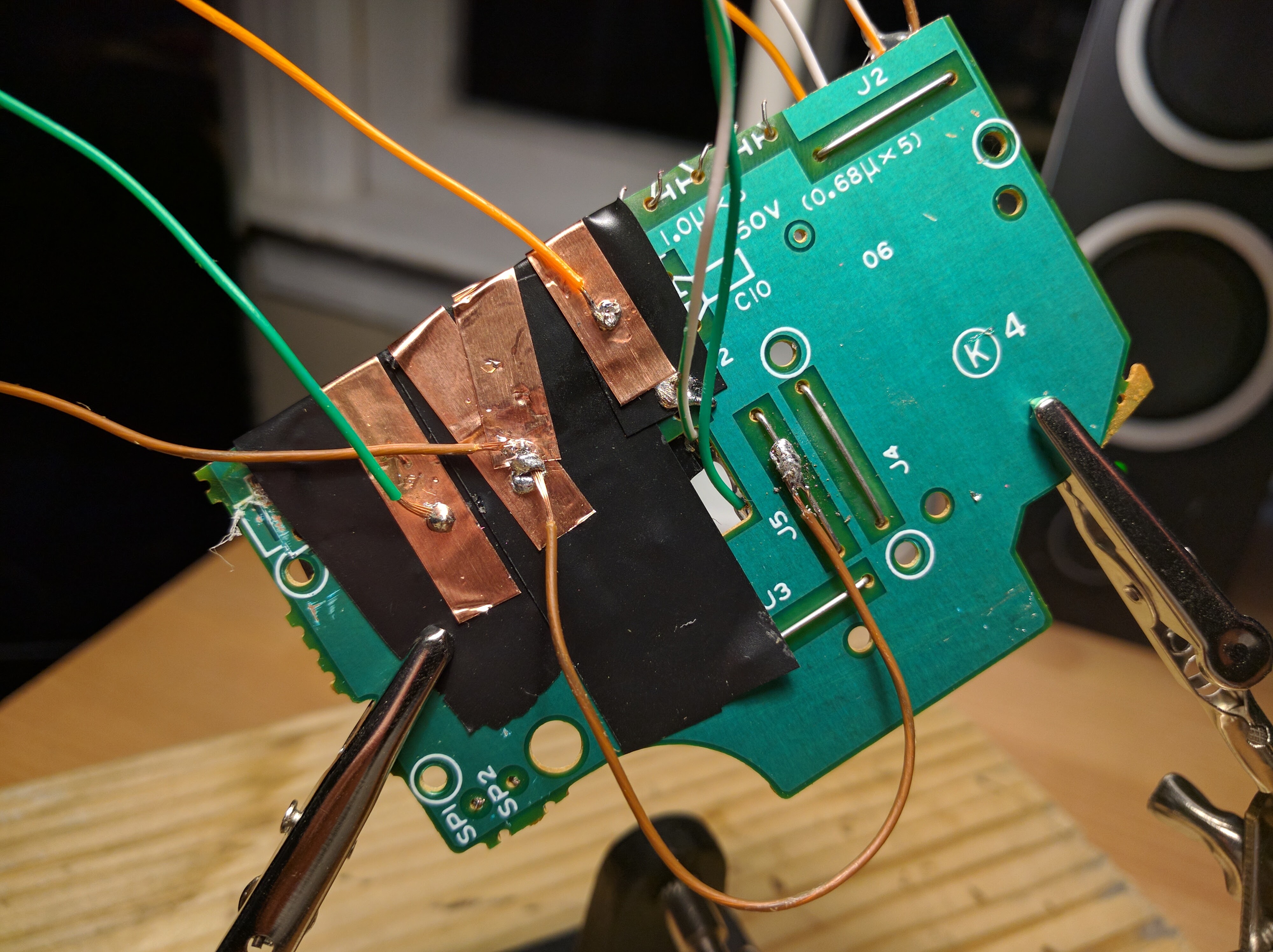

dirtybeagles
Posts: 386
Post by dirtybeagles » Fri May 06, 2016 6:23 am
Here is some more of my progress: See attachements

dirtybeagles wrote:Yeah. I might have either hit the button by mistake unpacking it or some how it was set to another setting when I first turned it on.
I'd also like to note that other multimeters may show 'OL' instead of '1' - they mean the same thing. :)
