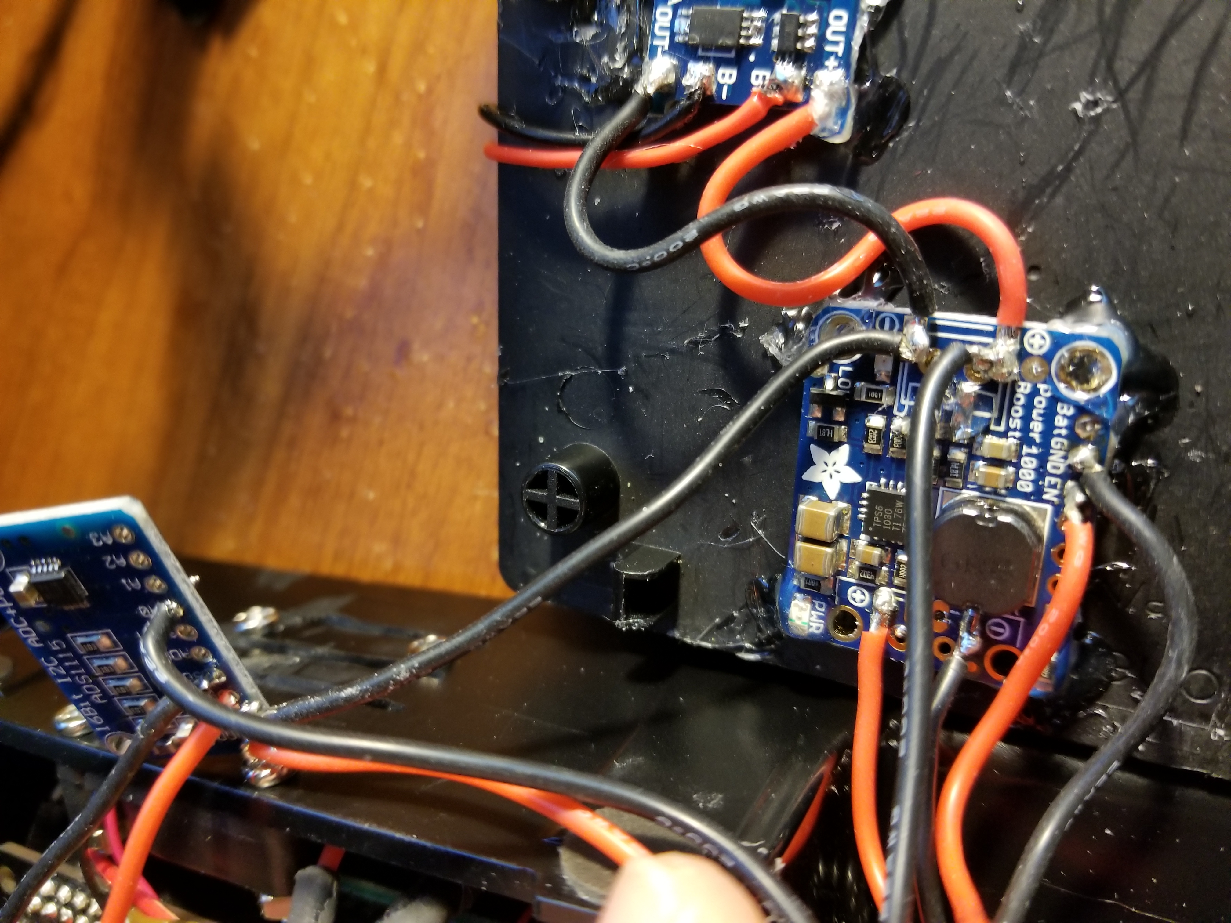

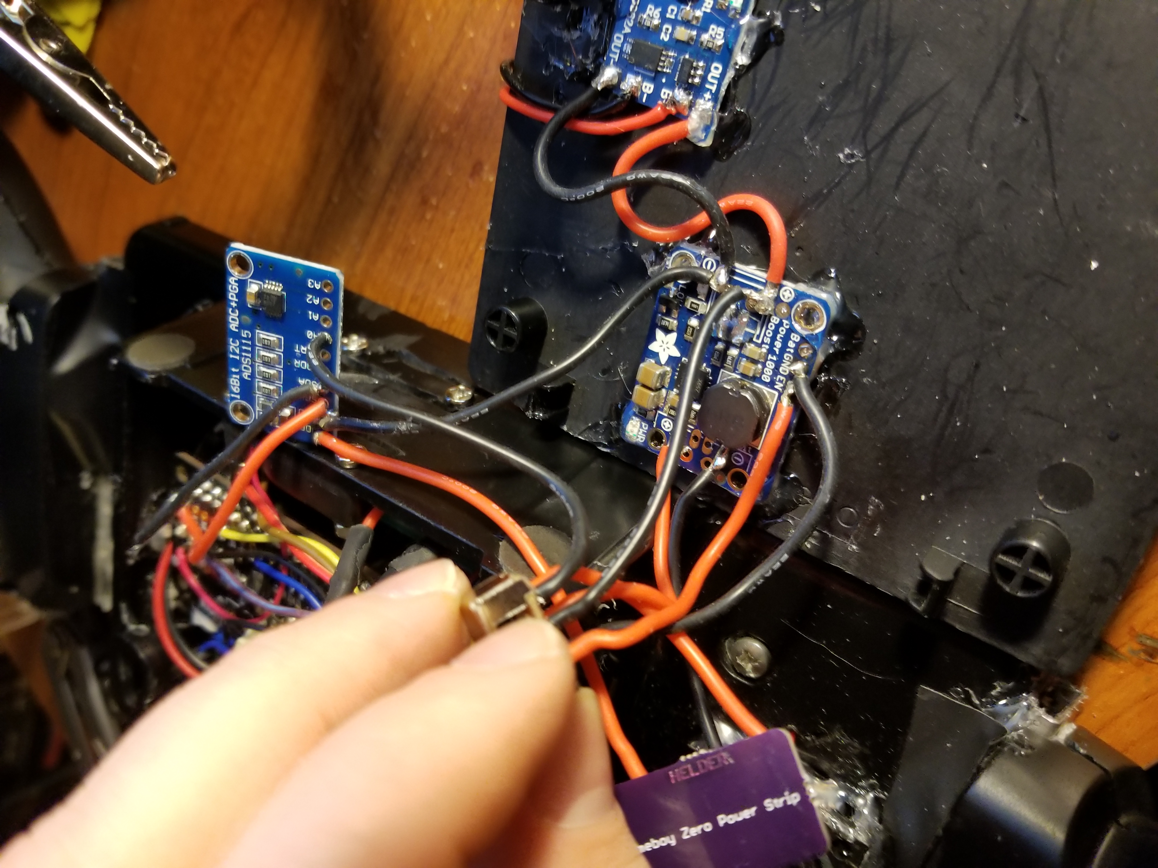

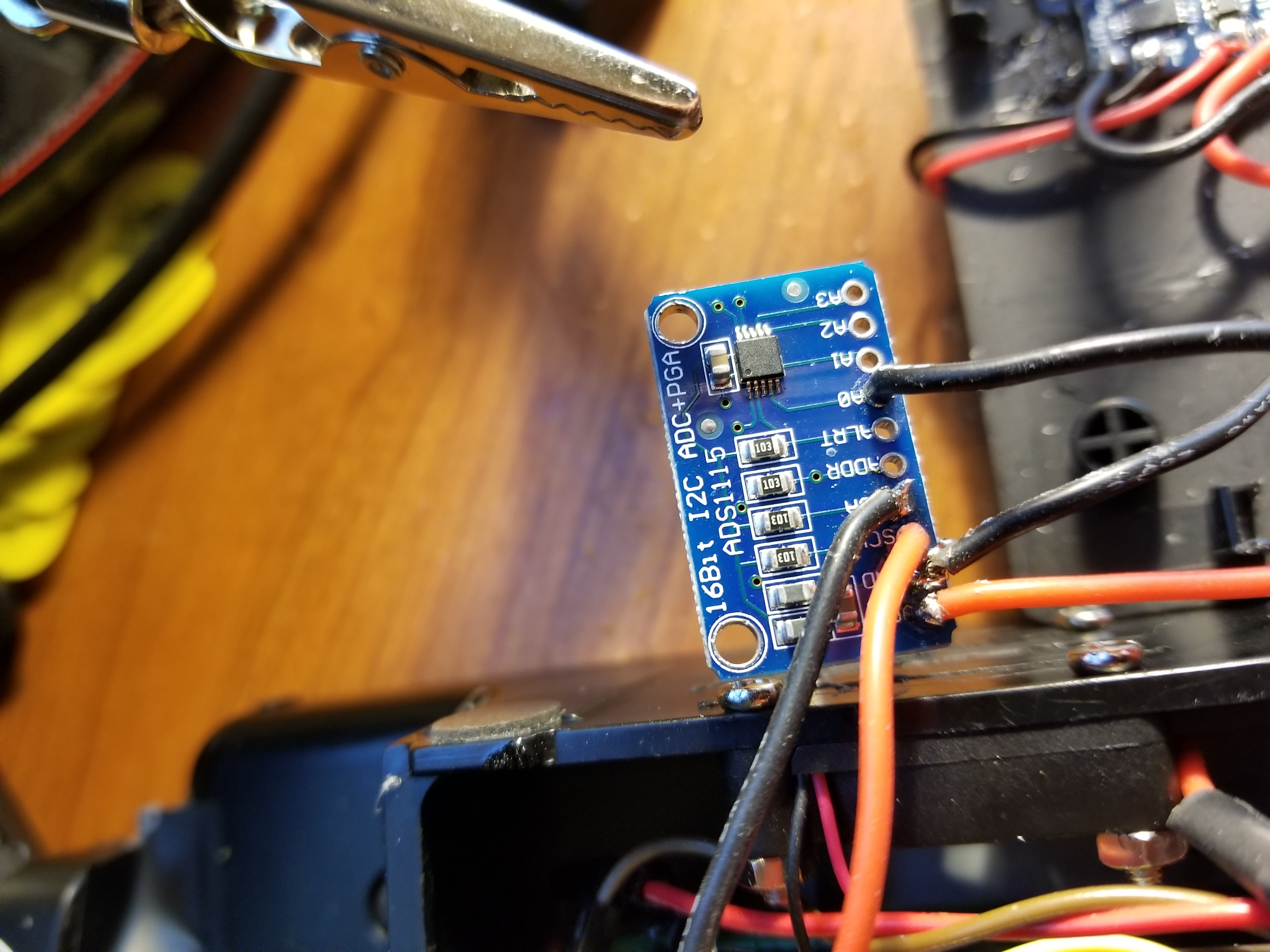

Here are the pics hopefully these are better. I'm going to try and redo the solder job, as I know it wasn't the best but if the rpi is getting power along with everything else they should be making sufficant contact then. I did have an issue a few months back with the sound bonnet causing me to have to do a fresh install of retropie and start everything from scratch to get it to work.
- Hopefully you can see how the switch is wired

- The ads1115
- 1518145459344532350903.jpg (2.79 MiB) Viewed 7960 times

- rodocop
- Posts: 1723
- Location: Saskatchewan
- Has thanked: 606 times
- Been thanked: 608 times
Re: On-Screen Battery Monitor Options
yeah the wiring looks like it is correct, you're certain you have the SDA and SCL wired to the proper GPIO pins on the pi?
