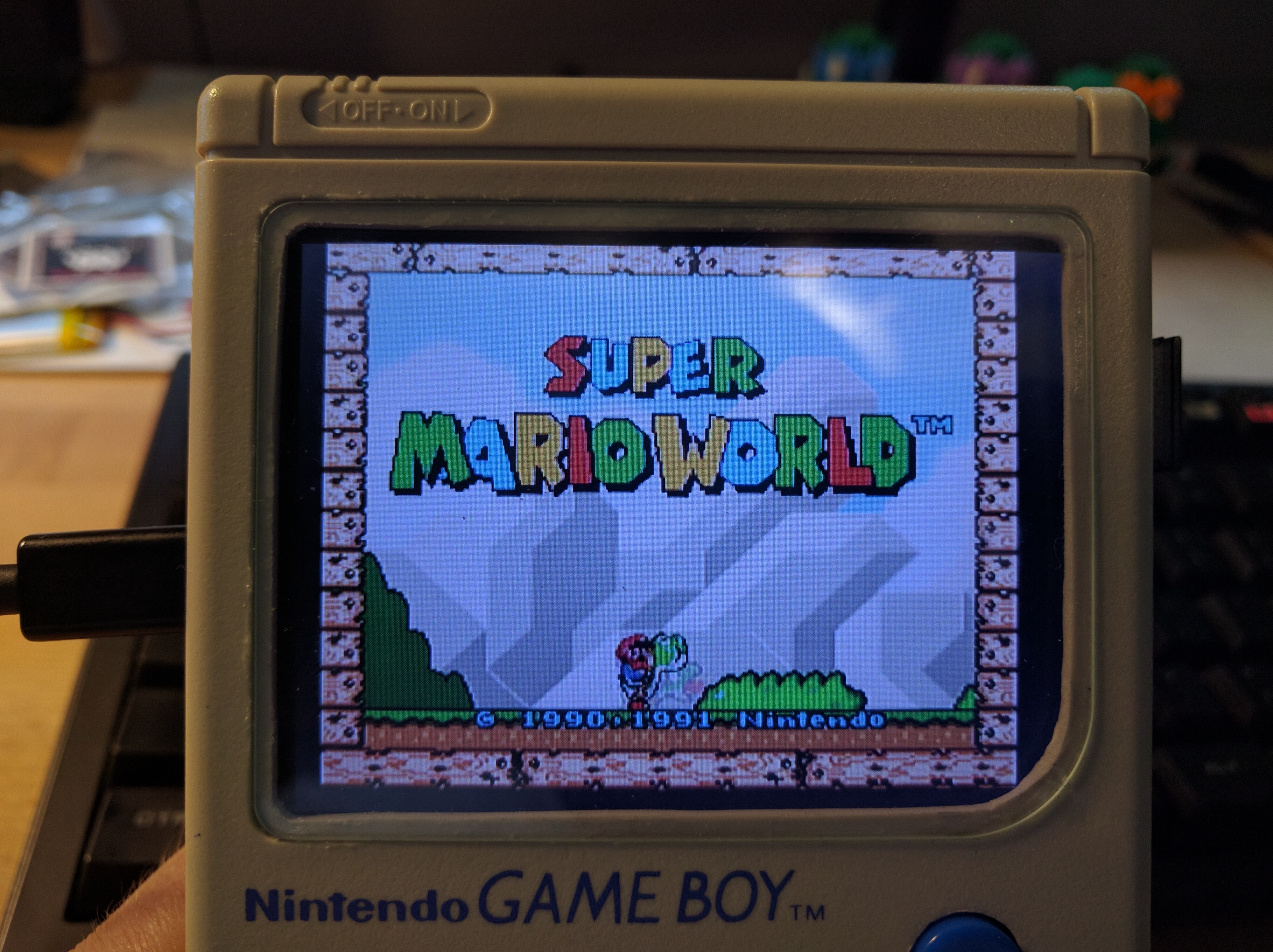

Hey Cannikin. I noticed in your screen picture that the left side of your screen black board is a little to wide. I have the same issue because one side of the VGA screen is a little longer than the other side.
Looks like I adjusted it enough. I guess I was not using high enough numbers so I did not notice. Sense our screens are upside down, this was my configuration:
overscan_left=-0
overscan_right=25
overscan_top=0
overscan_bottom=25

sabrettep
Posts: 14
Joined: Tue Jul 26, 2016 1:58 am
Re: Full VGA resolution (640x480) 3.5" display, composite in
Post by sabrettep » Wed Aug 10, 2016 2:53 am
Step Two - Screen is in.jpeg (615.98 KiB) Viewed 12561 times
The screen is in :D I will solder it tonight!
