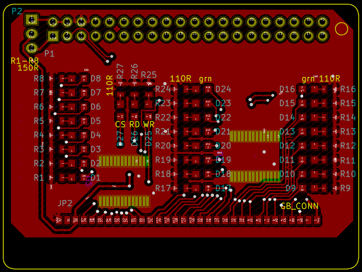

The first prototype PCB is all designed now. This is just a test run to see if I can crank the speed up when off of breadboard. Just need to check all the measurements are right, then off to oshpark!

did some measuring today and I had the pitch for the cartridge connector slightly off, so just need to re-do that (it's like less than 0.5 mm difference end to end, but it's probably enough to make a batch of boards useless!) so that's tonight's task. I've done the footprint, just need to re-route it on the board after I re-add the revised component. should be pretty quick though. so I reckon I'll have it ordered tonight! :D

starts to look very promising:) glad to see this is not forgoten. GOOD LUCK!
