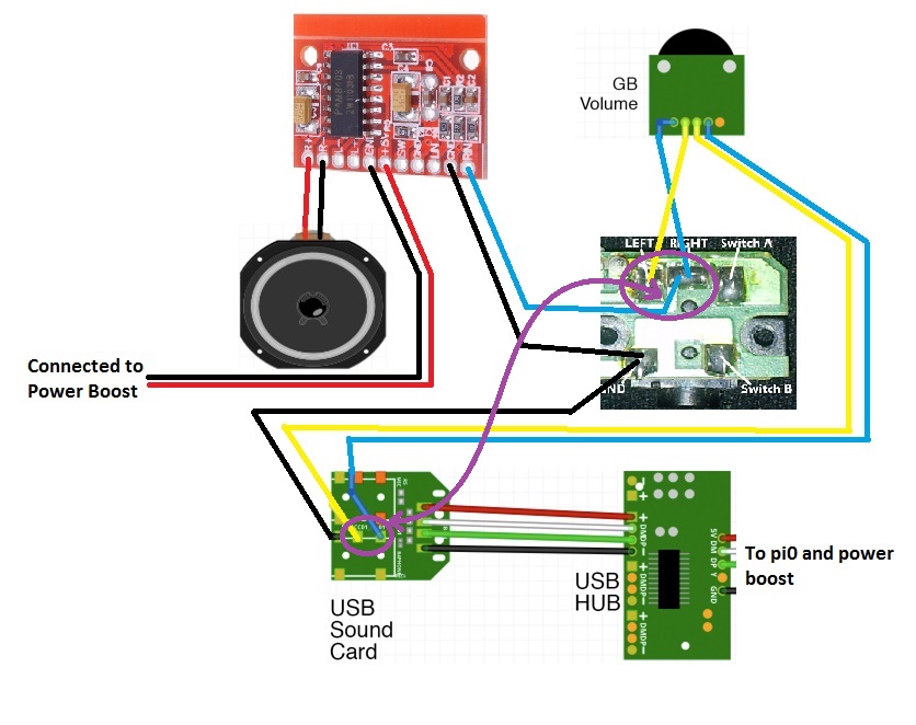

Okay, so I first tried it with your diagram and I received really bad feedback when I plug in my headphone jack. The speaker had a lot of static whenever I plug in the headphones.
I then switch it up to look like this:
Wiring for Sound (v1).jpg (129.29 KiB) Viewed 12319 times
But now, the speaker has static and the headphone jack doesnt work. Is there help you could give me? I think it has something to do with my Ground connections. Just FYI, I had to flip my GB Volume wheel so that is why the connections are backwards from your diagram. I flipped the GB Volume wheel around.

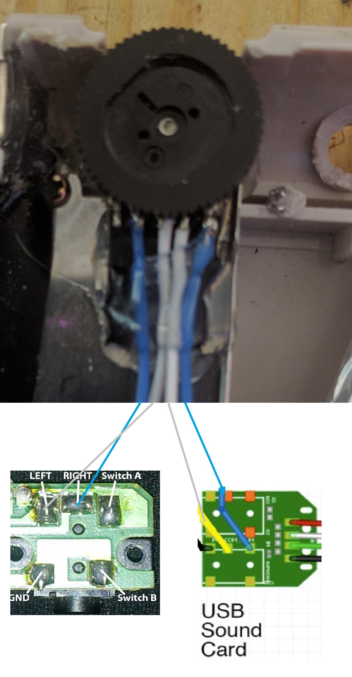

dirtybeagles wrote:But now, the speaker has static and the headphone jack doesnt work. Is there help you could give me? I think it has something to do with my Ground connections. Just FYI, I had to flip my GB Volume wheel so that is why the connections are backwards from your diagram. I flipped the GB Volume wheel around.
Okay, it works not like this, but the speaker is very faint in my option and I am still hearing static from the speaker. Am I missing something here?
Here is my volume wheel because I had to run it around. Gray color is white.
I think that would reverse the volume wheel. I used the left two contacts on the volume control as the "input" (from the USB sound card) and the right two as the "output" (to the headphone jack). The headphone jack then controls the power to the Adafruit amp by cutting off access to ground when you plug in headphones. I sent the left channel to the Adafruit amp (although I saw someone else connect left to A+ and right to A- on the amp, so I might try that.
I don't have any static on mine other than a very quiet constant level, regardless of what the volume is set to. The sound card is pretty cheap and the Pi is famous for having pretty crappy audio anyway so I just chalked it up to that. You can't hear it at all unless it's completely quiet (no game sounds) and you're in a quiet room.

Is there anyway you can give me a visual from what I have in my diagram? hard to follow what you are saying.
I am thinking you are saying I should I should reverse my connections for my volume wheel (indicated by the purple line)?
