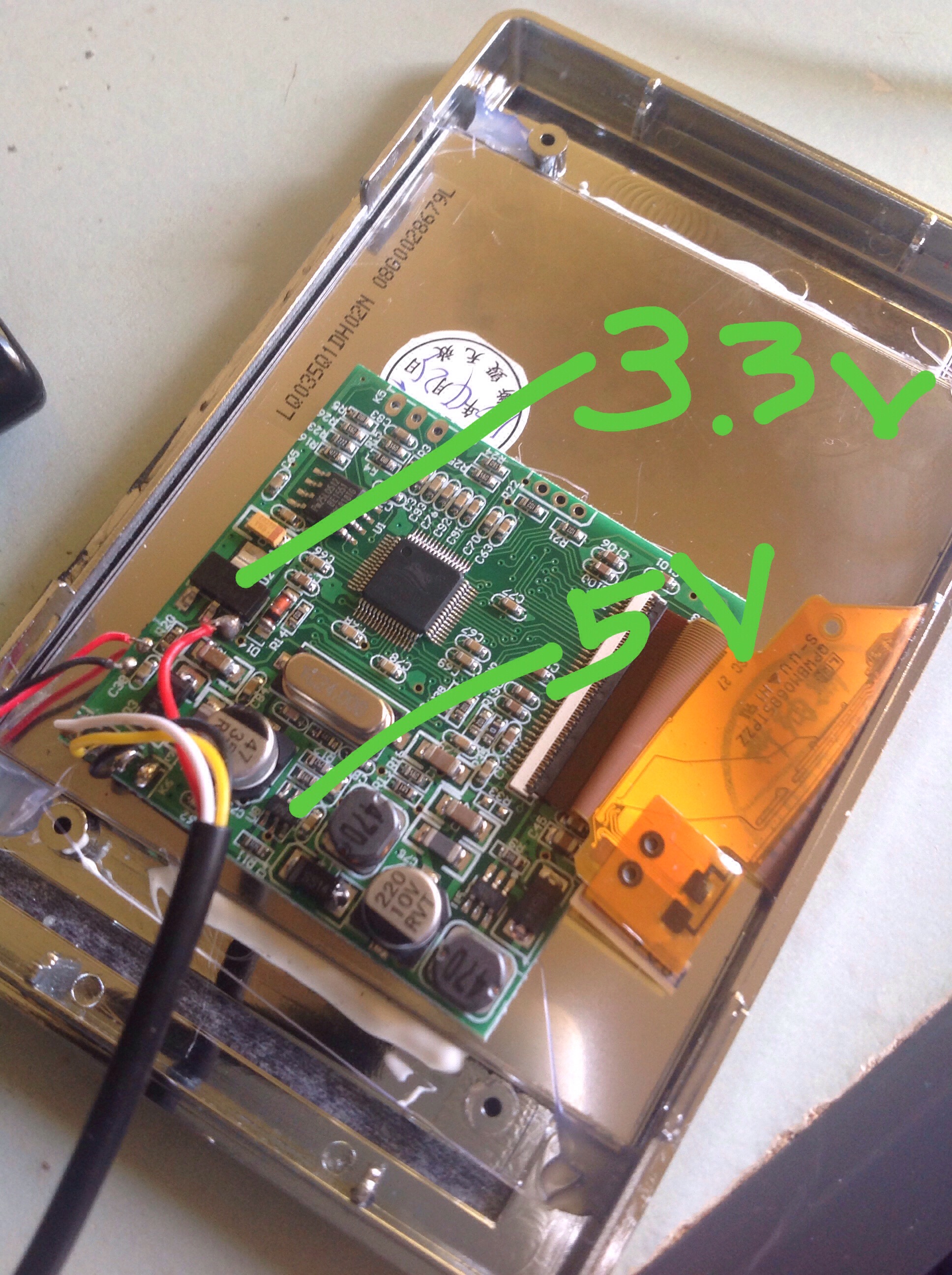

Post by tinkerBOY » Sat Jul 08, 2017 9:50 pm
Hex wrote:
Sat Jul 08, 2017 8:23 pm
It uses AMT630. Here is another image
Based on this image the board just seem to have one regulator. It just takes 12v and turns it to 3.3v. Can i see closeup picture of your board's regulator so i can check the datasheet?

Post by Hex » Sat Jul 08, 2017 10:07 pm
The regulator is config based. ie resistors and capacitors connected decide the output voltage. I think it is "a5269". BTW your board has a single step regulator. The second one is a EEPROM and not a regulator. If you supply too much voltage to that you will damage it beyond repair. If you have a multimeter, connect 12 v and check voltages on all major points. some of them ought to be 3.3v or 5v
Also the point you have soldered is output pin. I have checked

Post by tinkerBOY » Sat Jul 08, 2017 10:56 pm
That is not the one on my board. Its 1117H. As i said mine have 2 regulators. Already checked their datasheet.

Post by tinkerBOY » Sat Jul 08, 2017 11:00 pm
I tested a 3.3v power supply directly connected to the 3.3v output and screen works fine but as i suspected the chip amt630 still gets hot and still consume the same current.

Post by Hex » Sun Jul 09, 2017 5:35 am
Ok my bad. Clearly the IC does not follow standard DPAK pin layout. If Your screen is working properly for both 5v (on pin 3) and 3.3v (on pin 2) on 3.3Regulator and your AMT is still getting hot, try removing the PCB from the screen and post photos of PBC front and back and your raspberry pi.

Post by Hex » Mon Jul 10, 2017 2:45 am
When you say hot, how hot does it get? Can you keep a finger on it for long time without burning your finger?
