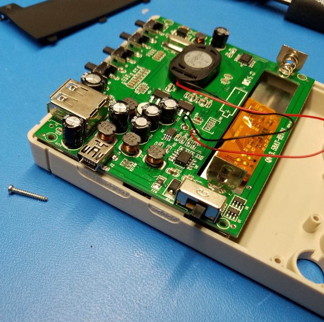

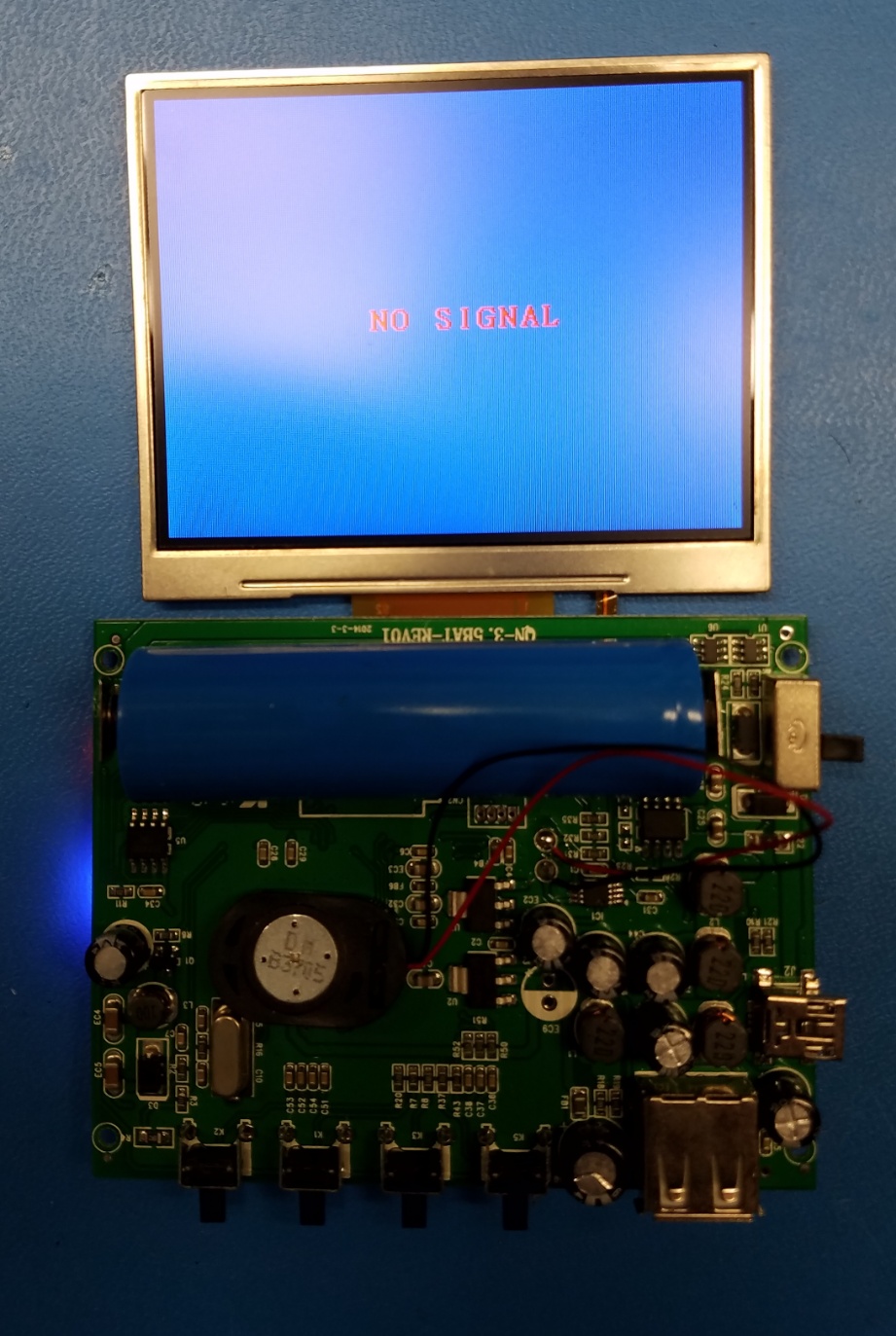

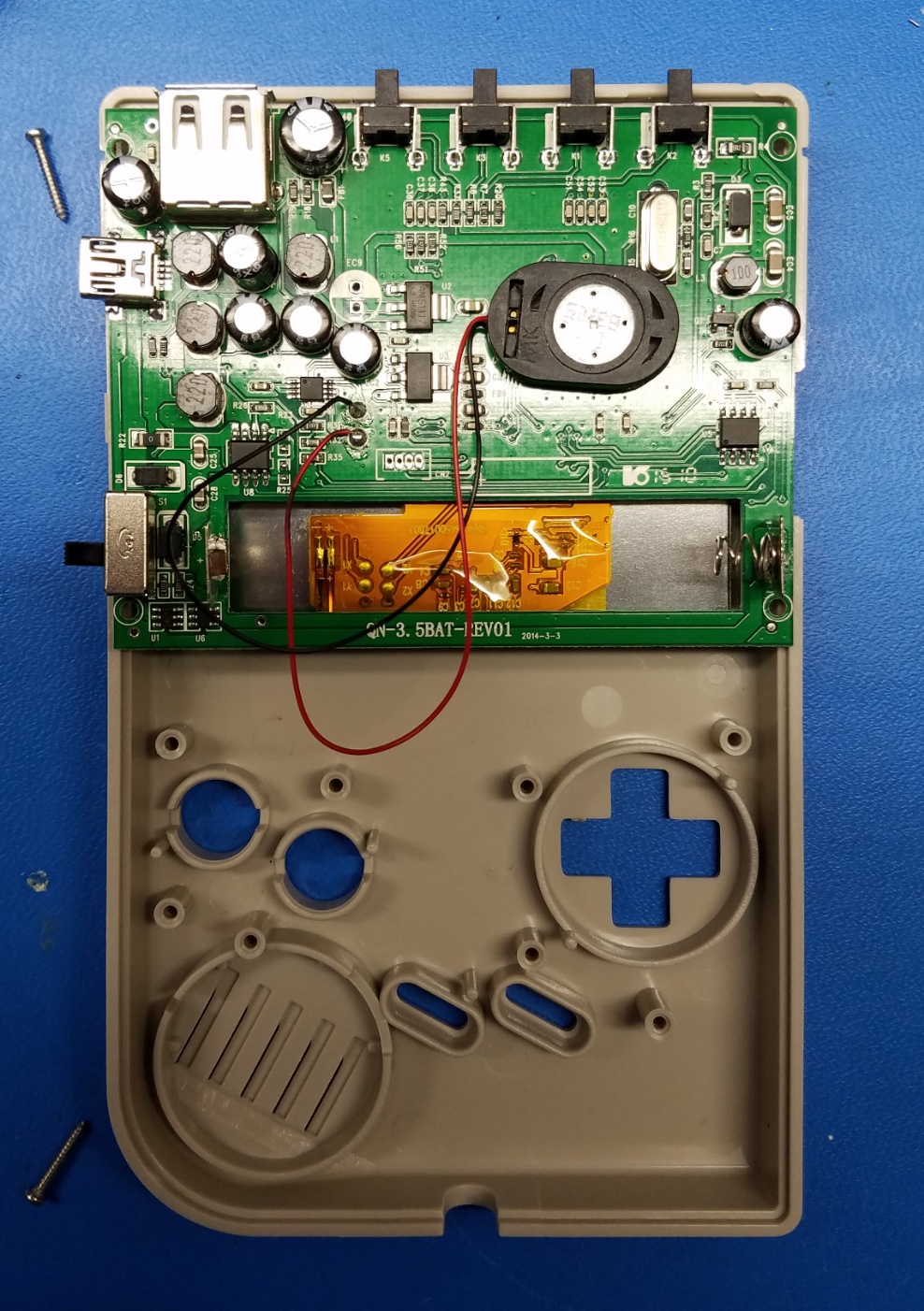

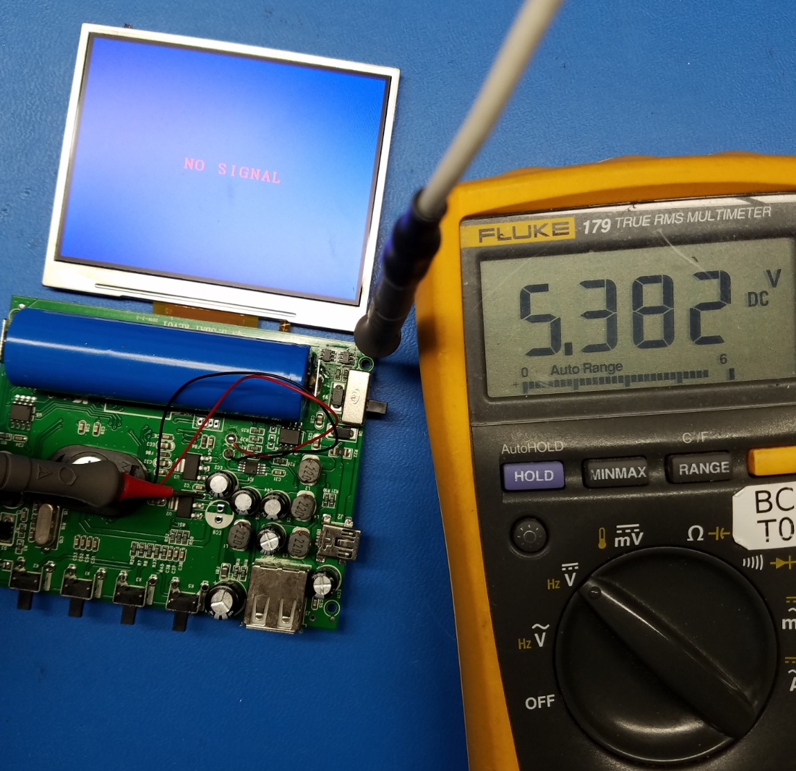

I cracked it open the portable LCD ( http://www.ebay.com/itm/291709734092 ). It has regulated 3.3v, 5.2v and 12v output on certain points on the board. Its a little bulky but it seems that its going to fit fine in the Gameboy case with no trimming with the connectors, switch and buttons of the LCD nicely reach the edge to have access to them. And yes, there is a small speaker in there!! ;)
