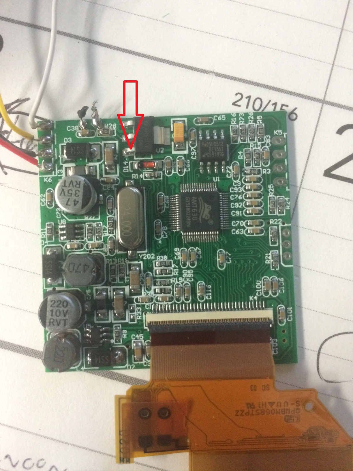

fedplast wrote:can someone please help me with my screen?
I would modify it to run on 5v if someone can figure out how: the only chip that looks similar to the one in the tutorial seems to be a flash memory, not a regulator:
Any help would be appreciated!
I have the same board. Yellow and white is your two inputs. Also I managed to get it running on 5v soldering Vin on this pin
vid card1.JPG (533.19 KiB) Viewed 10225 times
fedplast
Posts: 27
Joined: Tue May 31, 2016 3:18 pm
Post by fedplast » Thu Jul 14, 2016 5:25 pm
@pixelplus, you are a saint, you, your children and your children's children should never suffer any pain, and be successful in all your ways.
How in the world did you figure this out? there is no way you traced the circuit...
if possible, this should be added to the wiki...
pixelplus
Posts: 26
Joined: Thu Jun 23, 2016 12:43 am
Has thanked: 37 times
Post by pixelplus » Thu Jul 14, 2016 5:42 pm
fedplast wrote:
Happy to help :P
I did trace it, with 12v input I started to measure each pin on every suitable circuit and on that one I found 12v on one pin and 5v on another, figured that must be the regulator so I just soldered it there and sang a prayer :lol:
Don't know if you get the same result just desoldering the regulator as some guides tell you to do, but as long as it works I'm happy ;)
Tamasco
Posts: 67
Location: Spain
Has thanked: 34 times
Post by Tamasco » Fri Jul 15, 2016 12:23 am
fedplast wrote:
White cable is AV2. You are wiring it to GROUND. Search for @Fleder guide. You just need to solder either yellow oe white, not both.
