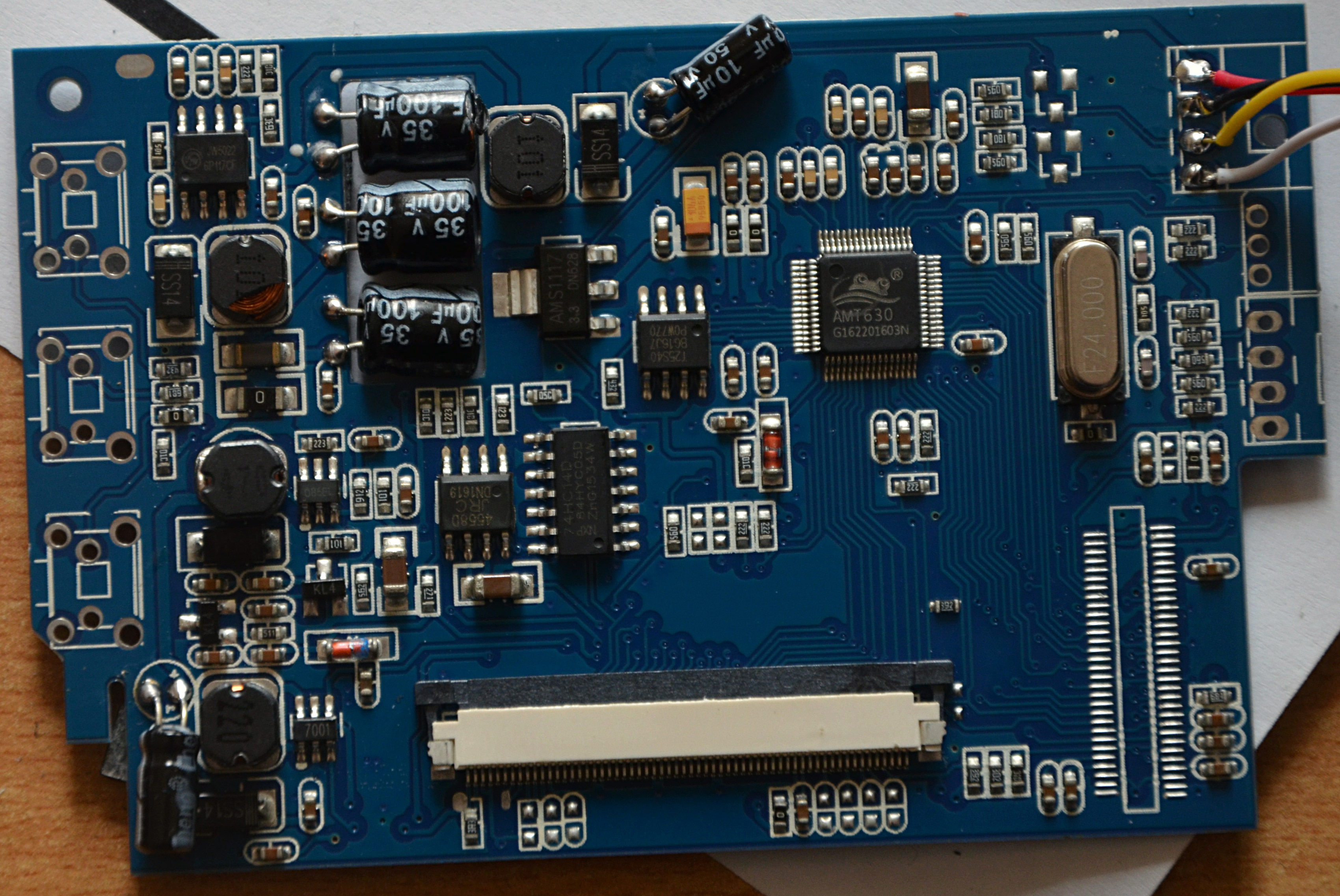

Hey guys :)
I think it's time to contribute - got a "new" TFT and haven't seen it here.
I got mine from amazon.de (https://www.amazon.de/dp/B019I0C5FK/) and since the case was looking small, I'd thought I should give it a try.
a project member told me that the voltage regulator is on the upper left corner (JW5022 - a chinese clone of MP1482)...
so, where to start? pin3 should do 5V?
since I've never had to mod a driver-board, I am thankful for any hints and tipps :)

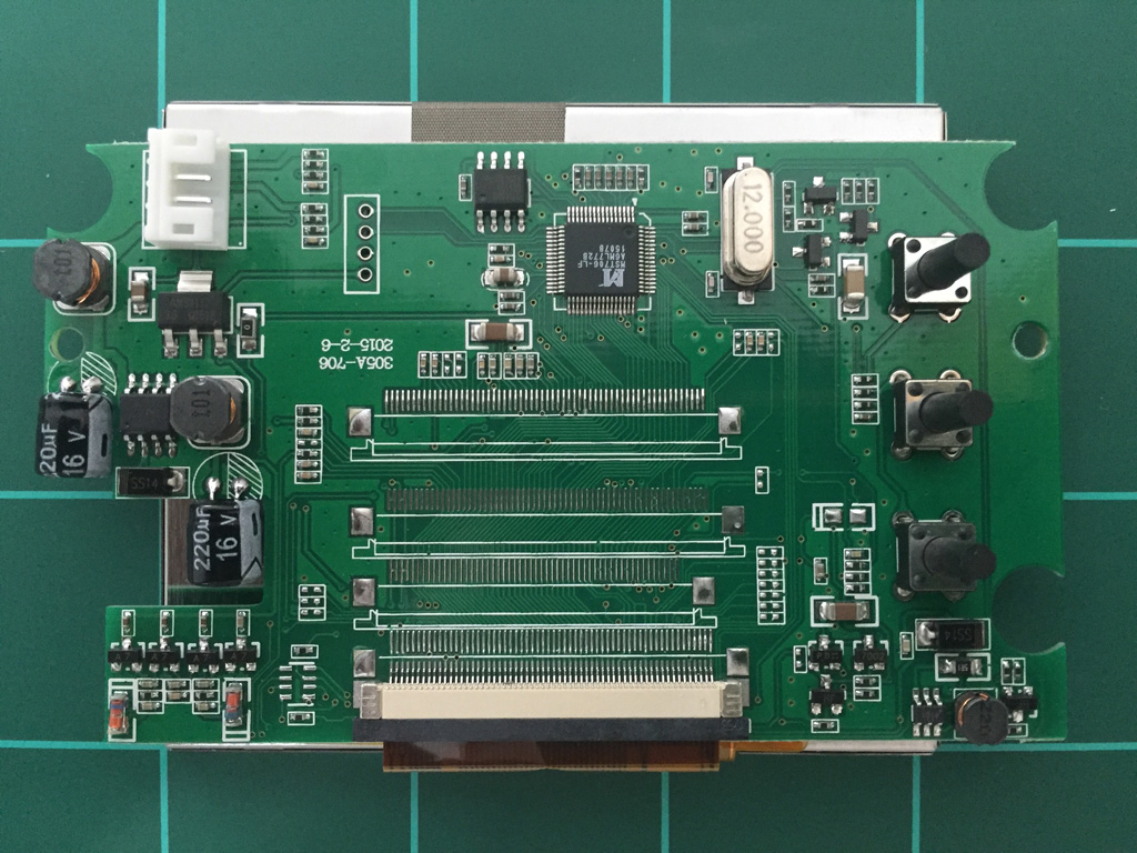

This is the "BW 3.5 Inch TFT LCD Monitor for Car / Automobile" from Amazon sold by: ATian Direct
The board is bigger than the screen and looks like there's no way I can trim the board without losing some components.

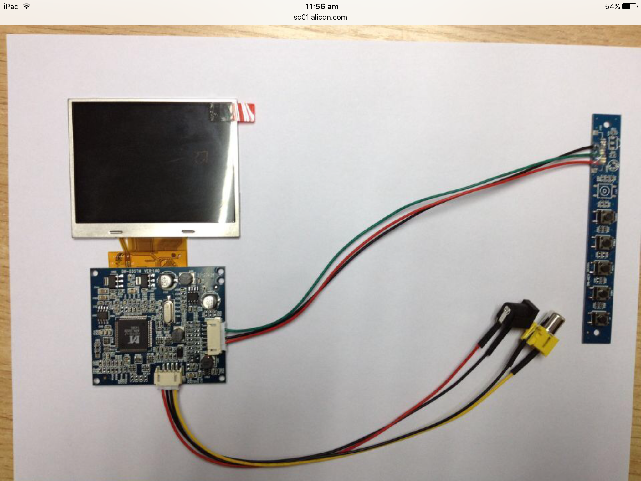

I just got a pair of XIANJIE 3.5 Composite Displays. The seem to work great. The price was $28 each plus shipping. The website used to order is a bit odd, but that's the only down side so far.
