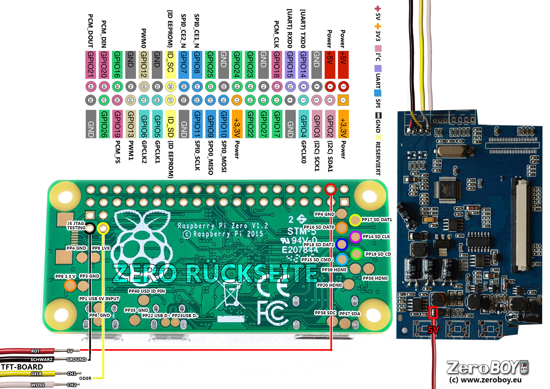

m3zz4nine wrote: a project member told me that the voltage regulator is on the upper left corner (JW5022 - a chinese clone of MP1482)...
so, where to start? pin3 should do 5V?
since I've never had to mod a driver-board, I am thankful for any hints and tipps :)
You could look for a datasheet of this voltage regulator. Or you can measure the pins of the IC against your ground. The one where you can measure 5V will the the one to solder you V(in) to.
btw: laughed at the filename of your picture ;)
Hey :)
The sad thing is, i do not find any usefull information about this regulator on the web :( - it is a JW5022 EP117CF
Anyway, I measured my way through - the Diode (marked red 5V in the picture) does the trick...
click here for the full version of the diagram
Ps: Haha, yes the filename is because one older member couldn't read the chips - so I made a high-res picture with my dslr for people that are somewhat blind :)
