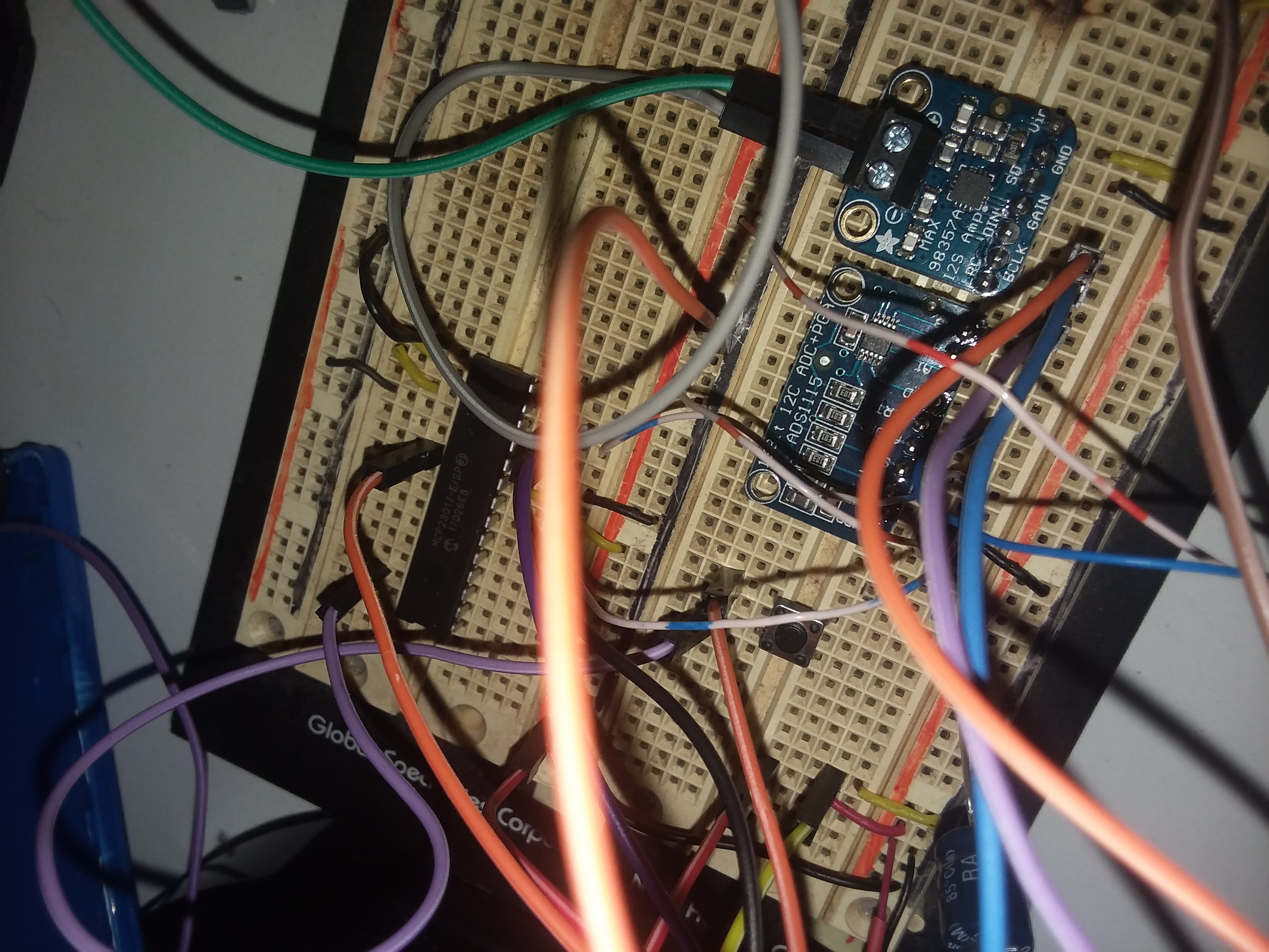

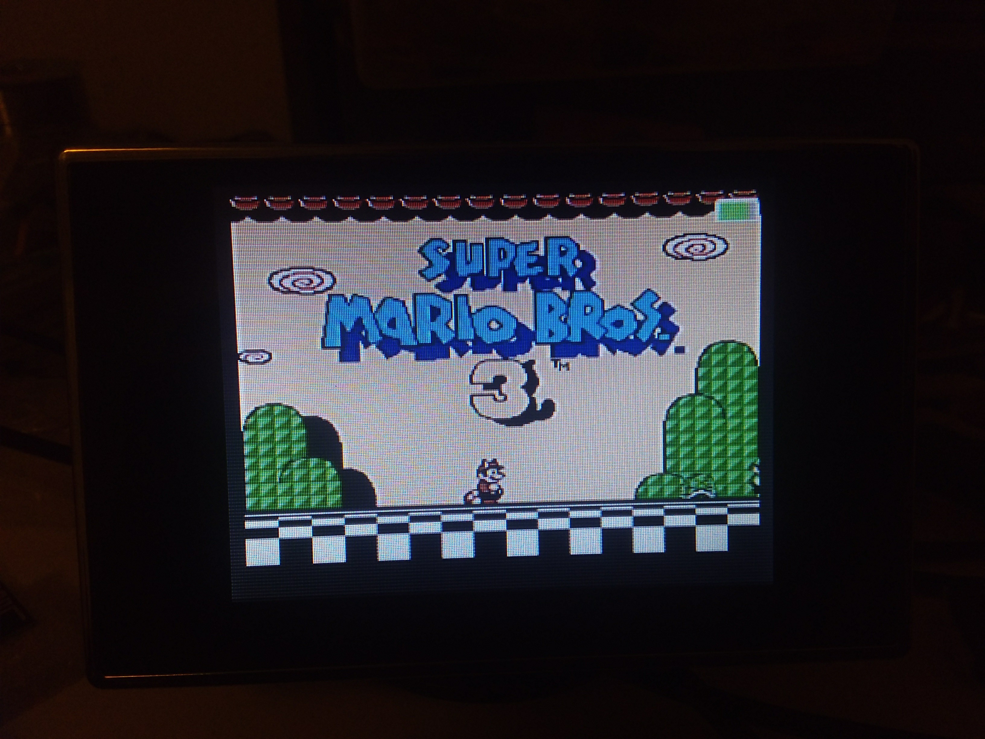

Hey I finally got a little time to try hoolyhoos script with my ads1115 board and it works. I just have it hooked up to my test breadboard so I'm not monitoring a battery. Just hooked up the A0 input on the adc to a potentiometer. I can turn the wheel and make the battery icon change. I had to change a lot of values around in the script because of the different voltage range though.

Hey sorry I'm using an older version of the adafruit library so i needed to change some of the commands to get it to work. I need to start with a fresh image I think because I couldn't get it to run the newer examples. I also had to change all the volts25, volts50, etc to make the bar change between 0 and 3.3v because all i had was a pot hooked up. I will post the code later though but I really don't think you will have too much trouble getting it to work. Setting debug = 1 in the battery monitoring script prints the value of the adc to the command line. If you do this you should probably edit /etc/rc.local and comment out the line that runs the mintystart script at boot otherwise its annoying having the values pop up every time you want to enter a command. Just try the two changes we talked about before and see if the values printed make sense. I will hopefully have time to start fresh and try to get the original code working soon though.
