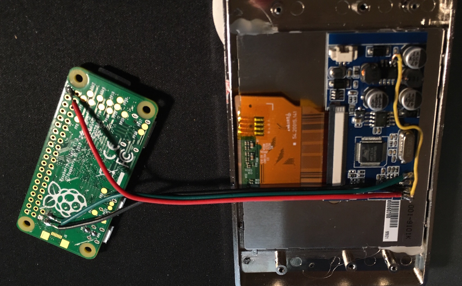

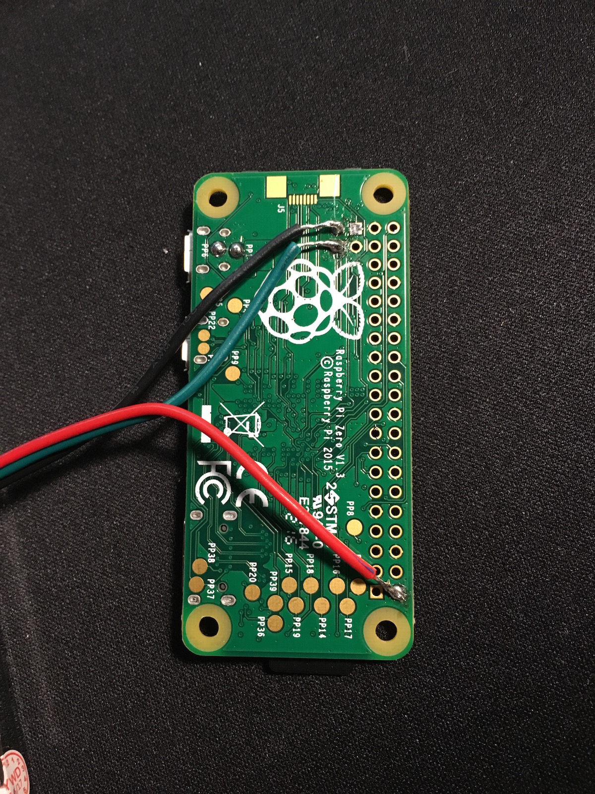

I can't get a BW v7 to work with my pi0. This is the 3rd BW v7 screen but nothing seems to work.
Things tried...
- Hook up the video out 1 (also tried video 2) and hooking 12v to the screen - nothing
- Hook up the video out 1 (also tried video 2) and run 5v/ground straight off the pi0 - nothing
- Run the jumper cable from the power to the second pin like here - nothing
- Remove the chip - nothing
Currently on my 3rd screen...
- Running NOOBS for a testing OS
- +5v is getting to the screen
- pi0 works fine on my TV with HDMI
- Followed this LCD wiring guide here.
- Check the screen first by hooking up my SNES and playing a bit of Super Mario on the small screen.
- Solder points are a little sloppy, but triple checked that nothing is touching.
This is what I currently have...
File_000 (2).jpeg (430.45 KiB) Viewed 10087 times
File_000 (1).jpeg (850.02 KiB) Viewed 10087 times
