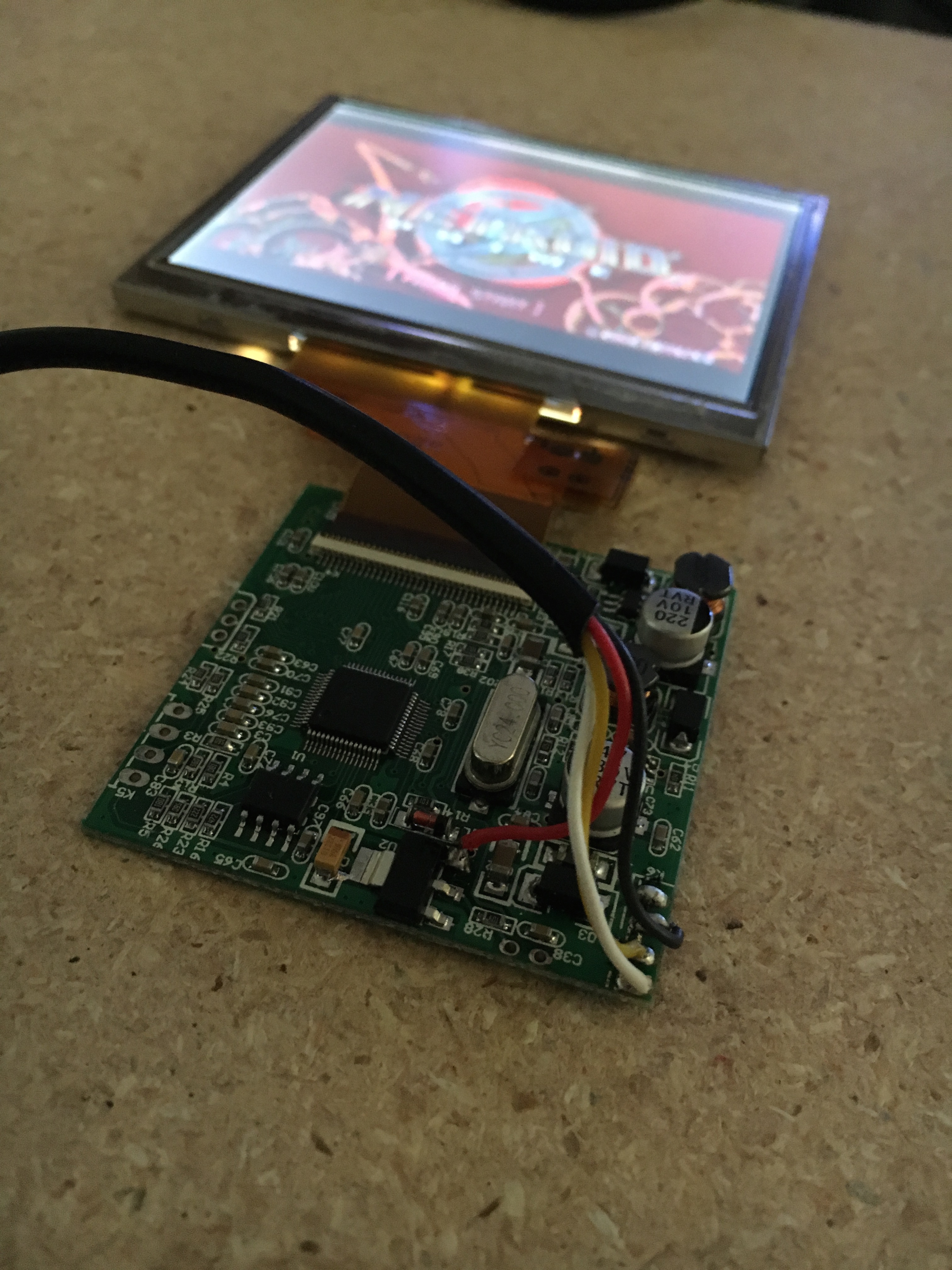

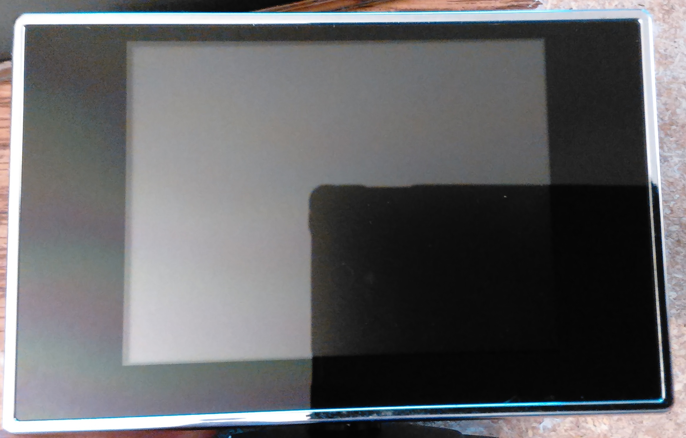

I tore the case before I thought to just cut the wire. Anyway, That's the screen I purchased. I'm not sure how to, if at all, modify it to run off of 5v. As is, when I supply it with 5v, the screen goes from black (off) to a slightly lighter shade of black when on.

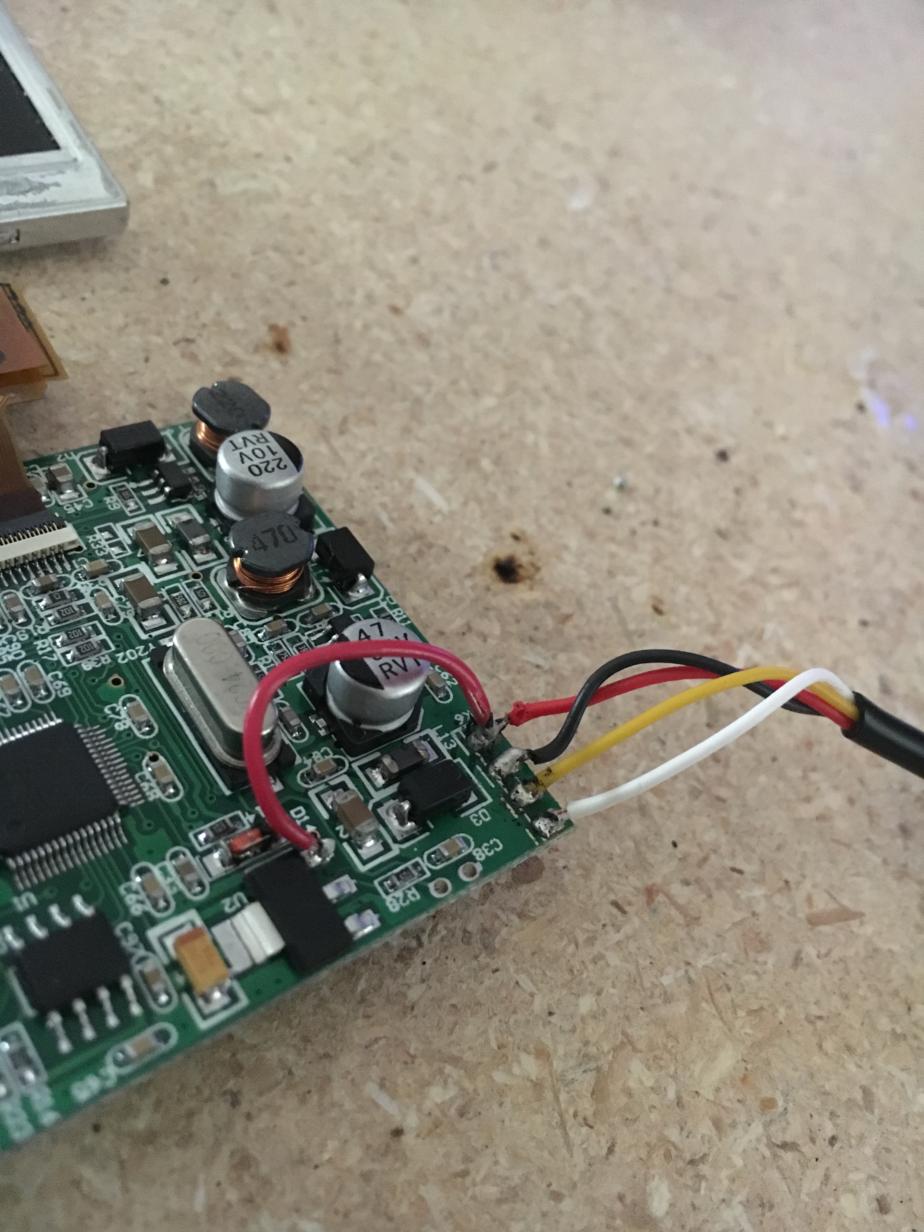

The 5 volt regulator is the three legged pad right above the soldered wires. I initially soldered a red jumper wire from the power wire to the third prong:
This is NOT exactly what should be done, at least in my case it wasn't exactly correct. I got the screen to work, but it had a very delayed flicker:
You can see how I powered everything without a pi by looking a few posts back in this thread
Finally I made a thread in the project help area of the forum and someone suggested wiring the red wire DIRECTLY to the 5v regulator. This worked.
So if you get this board, I hope you find this and it helps you figure out what to do. I am very grateful for everyone who helped me out with this screen. Thank you!
