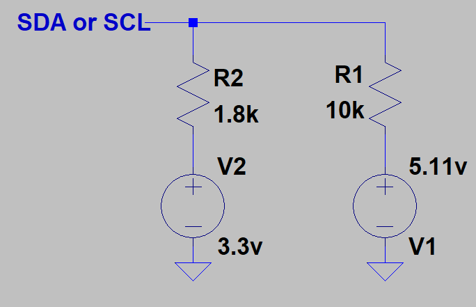

While it my not be an ideal situation, it seems like just powering the module from 5v without removing any pull-ups should work fine. The raspberry has 1.8k ohm pull-up resistors to 3v3 on the sda and scl lines on board. The module has 10k pull-ups to 5v on the same sda and scl lines. So the actual circuit for one of the lines is something like this:

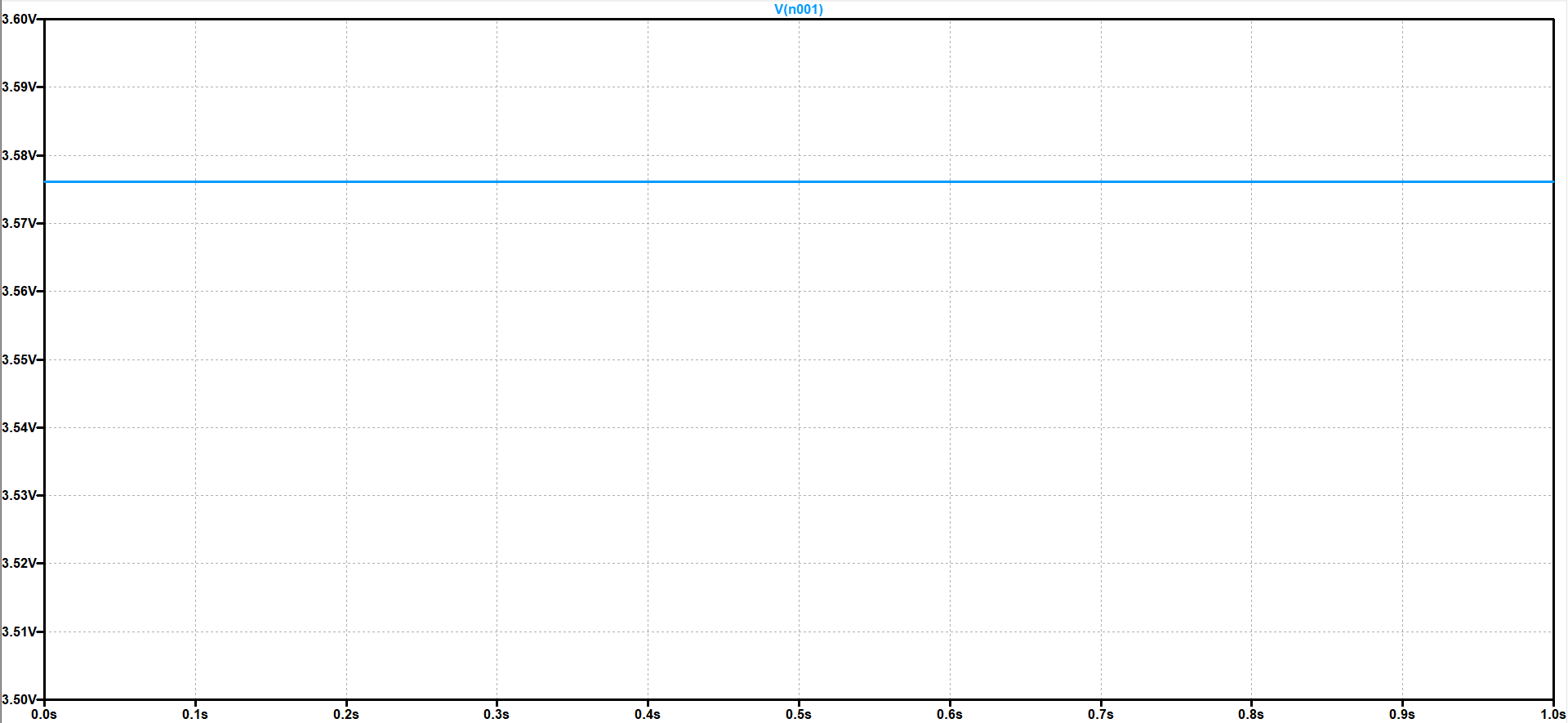

I used 5.11v because that's what i measured with my DVM. Simulating this we get around 3.58v on the data line:
I have verified this with my DVM I'm seeing 3.58v. Seeing as its not very high above the 3.3v rating of the pi's pins it seems like it wont hurt anything. This does work perfectly so far on my breadboard.
Thanks for the info! I'm making a control board rright now with an ads1115/1015 circuit integrated. I placed a 1n4001 diode in series with the 5v vdd to (theoretically) drop down to around ~~ 4.3v . So that the output is below the 3.3v required of the pi. If there is a flaw in my logic please let me know haha
