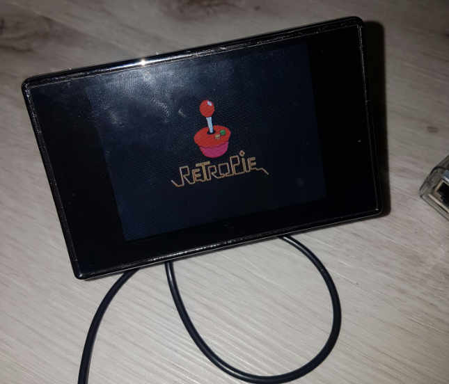

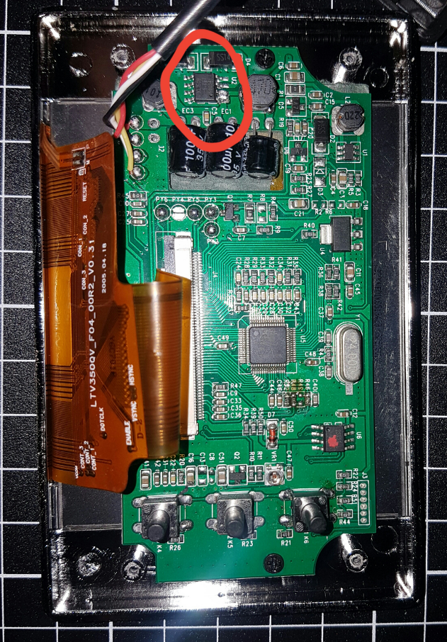

Post by Lphillimore » Wed Jan 18, 2017 6:04 am
Managed to get this running off of 5v.
Turns out this isnt the same screen Wermy listed. Only model number on the box is K414
Looks like its the same screen listed above - mine did not run off of 5V out of th ebox however.
Opened it up again and checked the voltage regulator and found it was an XL1509 chip.
Looked it up and the easiest way was to simply solder pins 1 + 2 together as per the pics.
No need to remove the chip or run a wire.
Success!
Now to try and make it fit....
