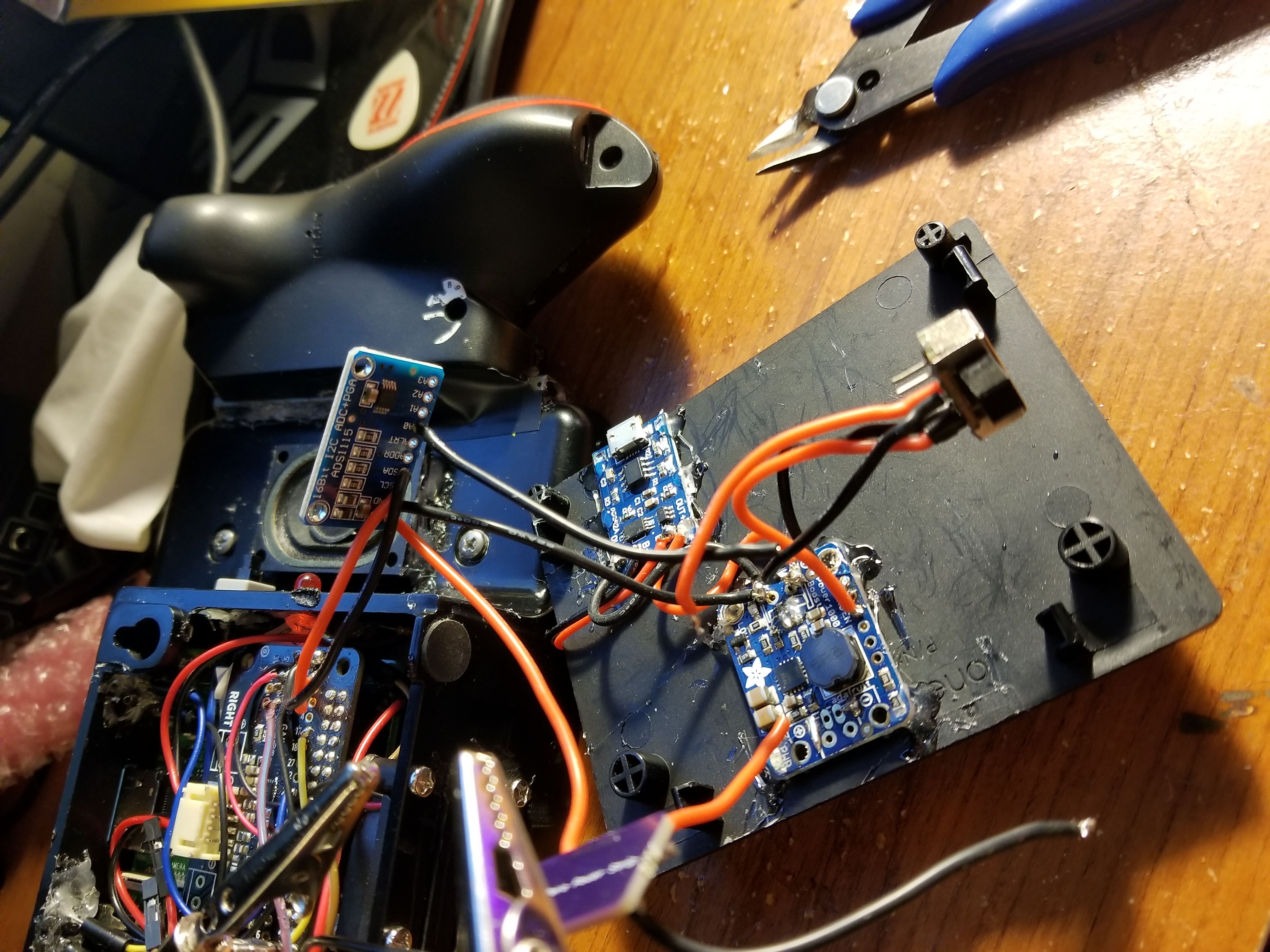

ok so finally got my boards in and connected but after connecting to SDA and SCL I am now getting under volted symbol and I can clearly hear and see a difference then them not being connected :-/ kinda stumped here, but i do have a question if I have the DPDT switch installed to A0 do i still need the resistor? and if not could that be whats causing the under voltage?

You mean the pi is giving the lightning bolt in the corner?cainkirisgai wrote: ↑Thu Feb 08, 2018 6:05 pmok so finally got my boards in and connected but after connecting to SDA and SCL I am now getting under volted symbol and I can clearly hear and see a difference then them not being connected :-/ kinda stumped here, but i do have a question if I have the DPDT switch installed to A0 do i still need the resistor? and if not could that be whats causing the under voltage?
Where is the ads1015 getting power, I'd wire 5v from the powerboost or power strip. And then wire the battery to a0. Can't hurt to add a resistor too.
How are you powering everything else in the build? From the pi, or your powerboost?

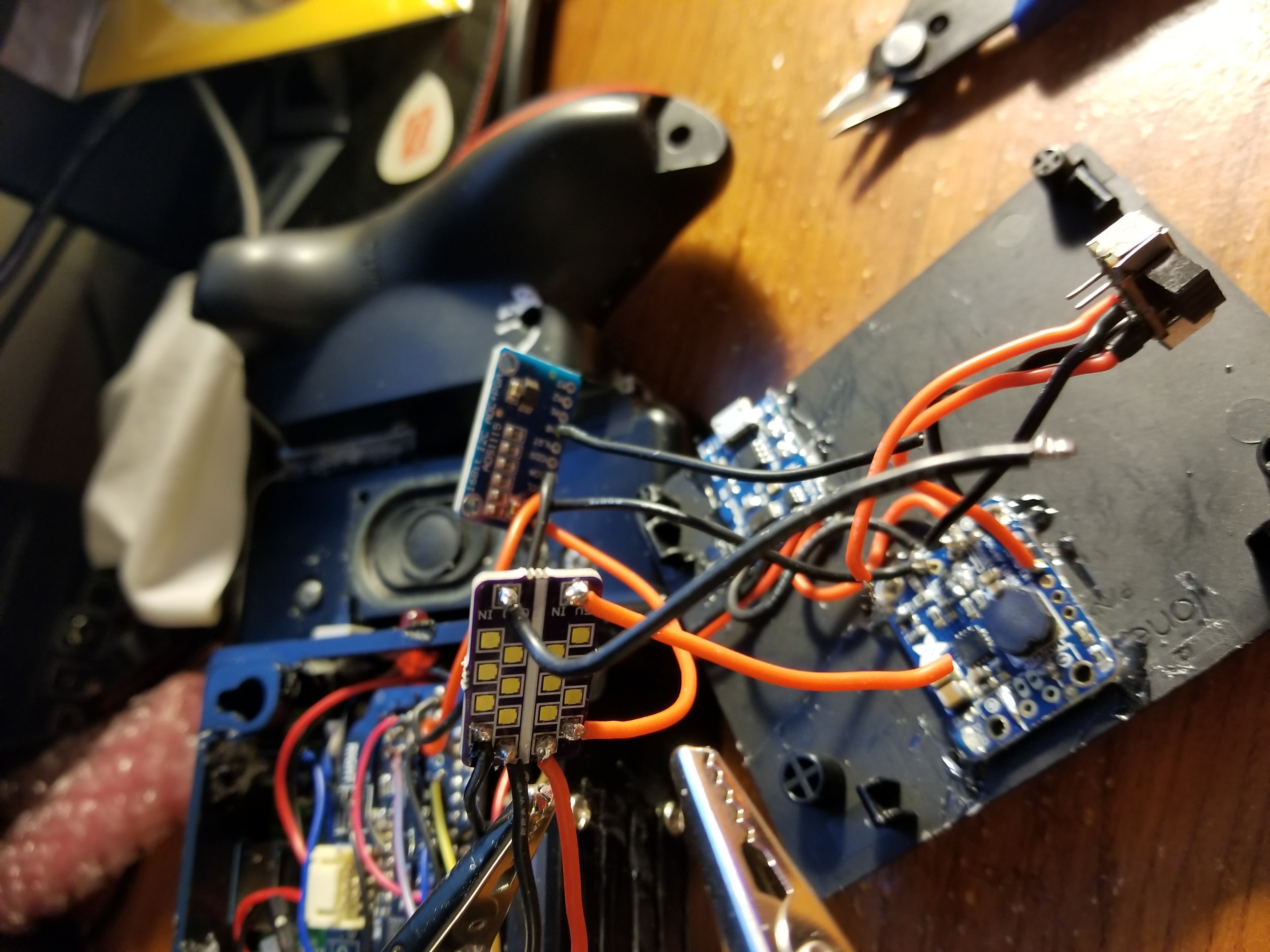

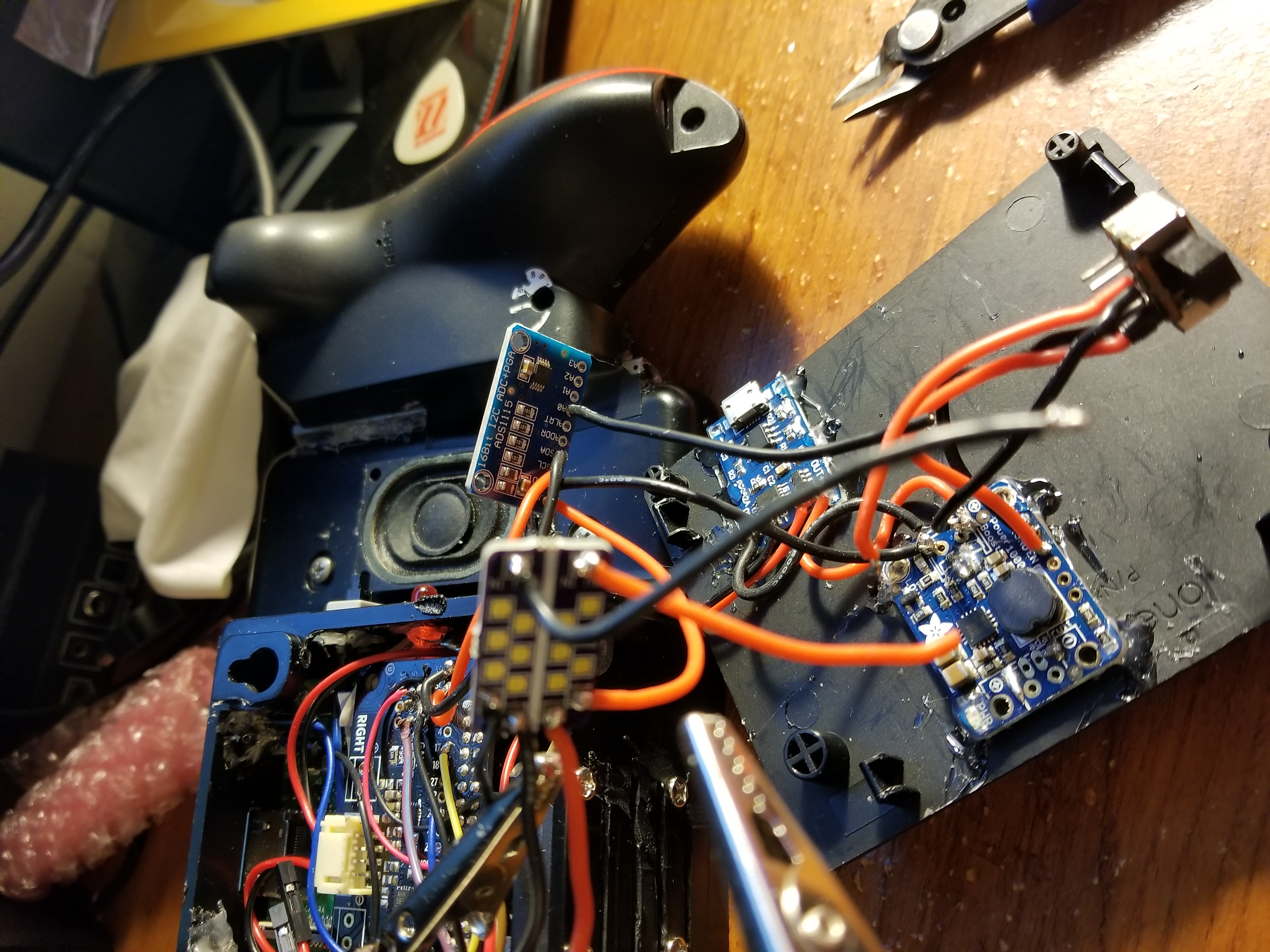

well right now i believe its from the powerboost. Trying to wire it the way that VeteranGamer posted on page 7. I did have a resister on A0 already, i will try to take a pic of it to show how i have it wired perhaps i have it wrong. As of right now i did disconnect a few of them so it might not look all that right

Well I took the resistor off and all is well right now no low voltage warning at all

Hmm. We'll at least it's working. What resistor did you use anyway?

it was a 10k but still not seeing the OSBD :-/
