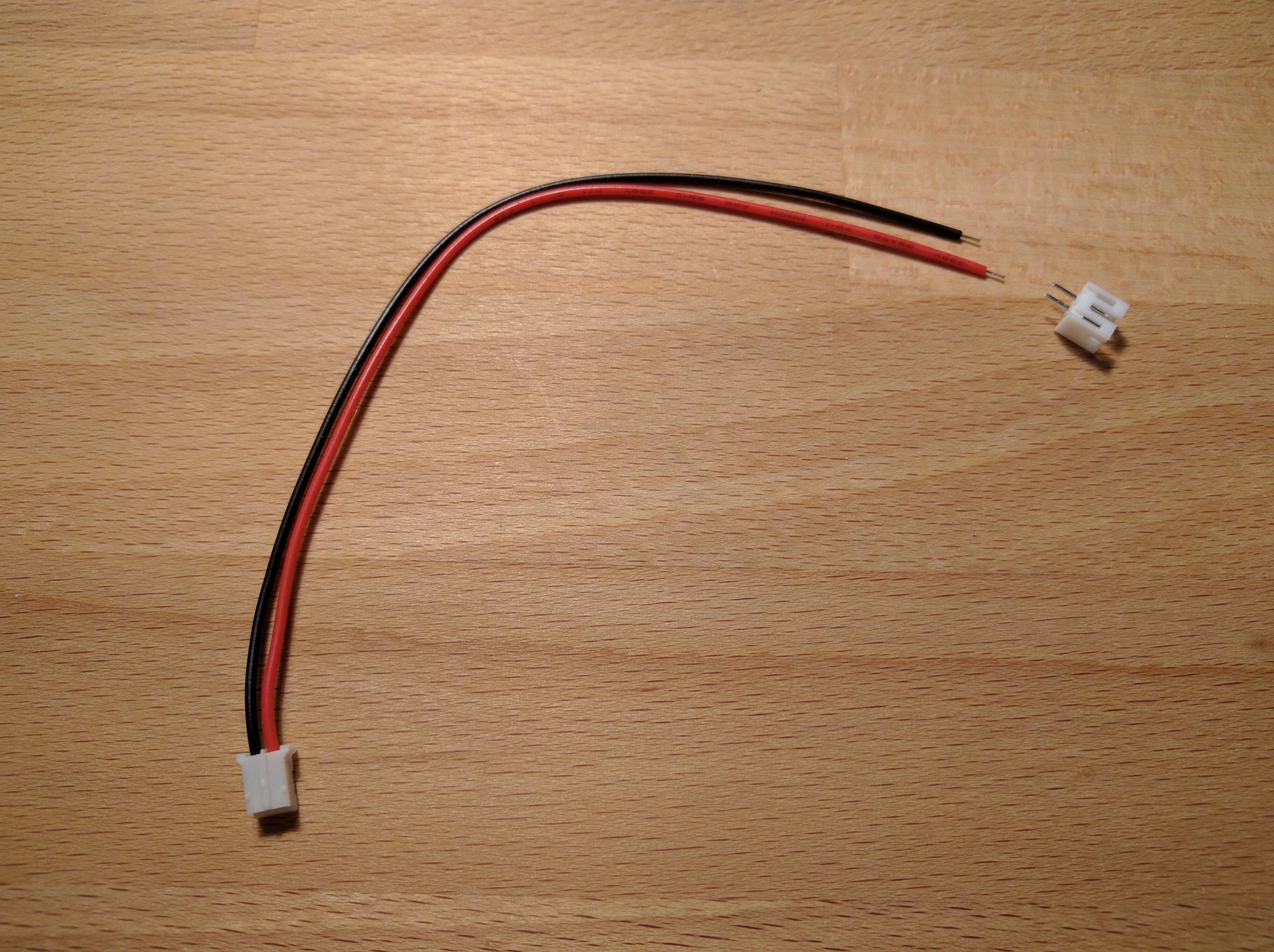

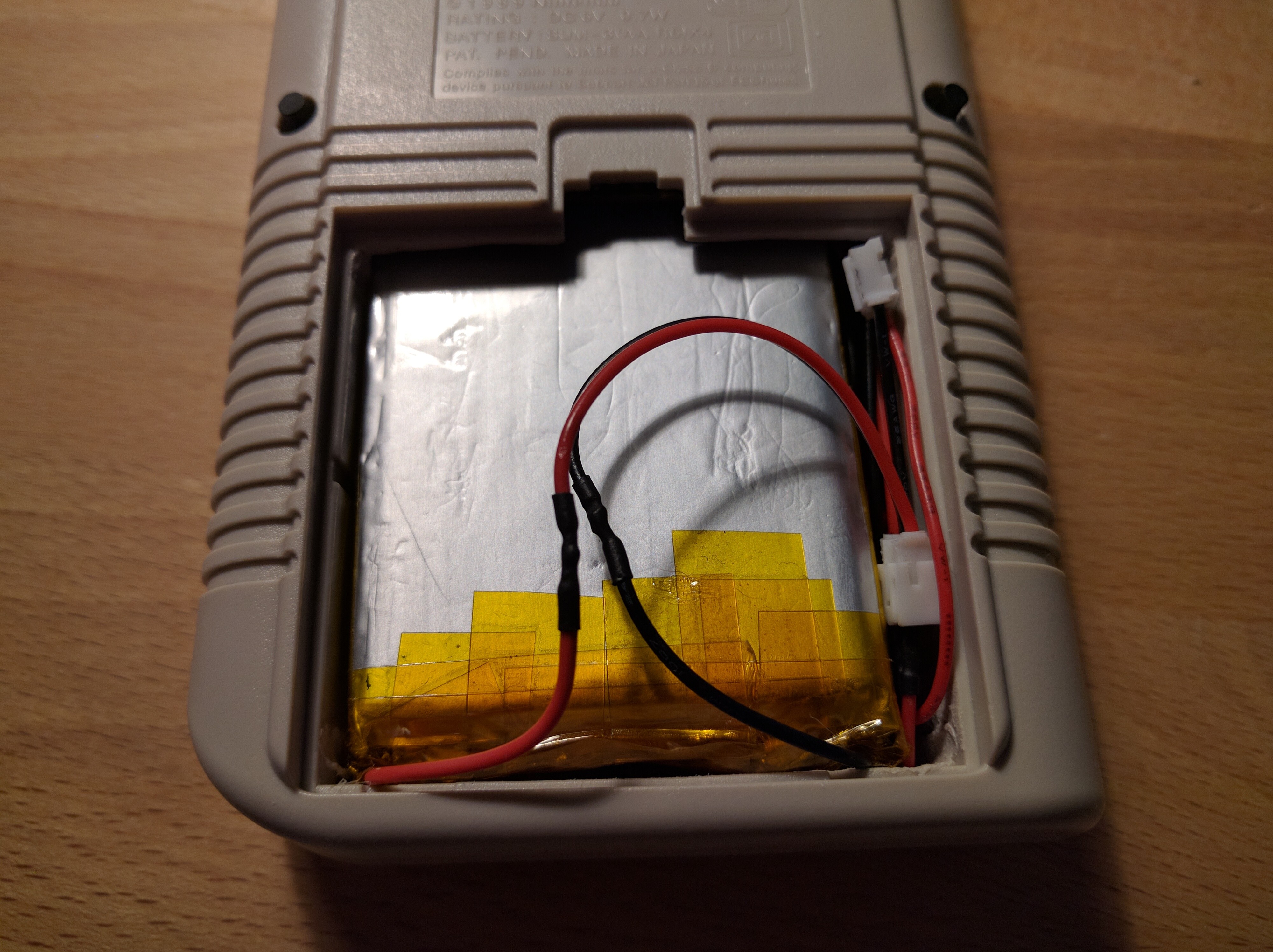

Here is a little tip that I did because I did not want to keep having to take a part my GBPi2 when I go to sleep or leave the house so I created a male to female extension cable from the powerboost to the battery bay that way I can unplug my battery without taking apart the GBPi2.
[spoiler="Created a Male to Female Connector Pin"]
[/spoiler]
[spoiler="Put in the battery"]
[/spoiler]
[spoiler="Make sure it fits and test"]
[/spoiler]
*this way I can disconnect the battery whenever I need because I do not want my battery to catch on fire.
:D Hope this helps!!! Please be responsible and safe. :D
