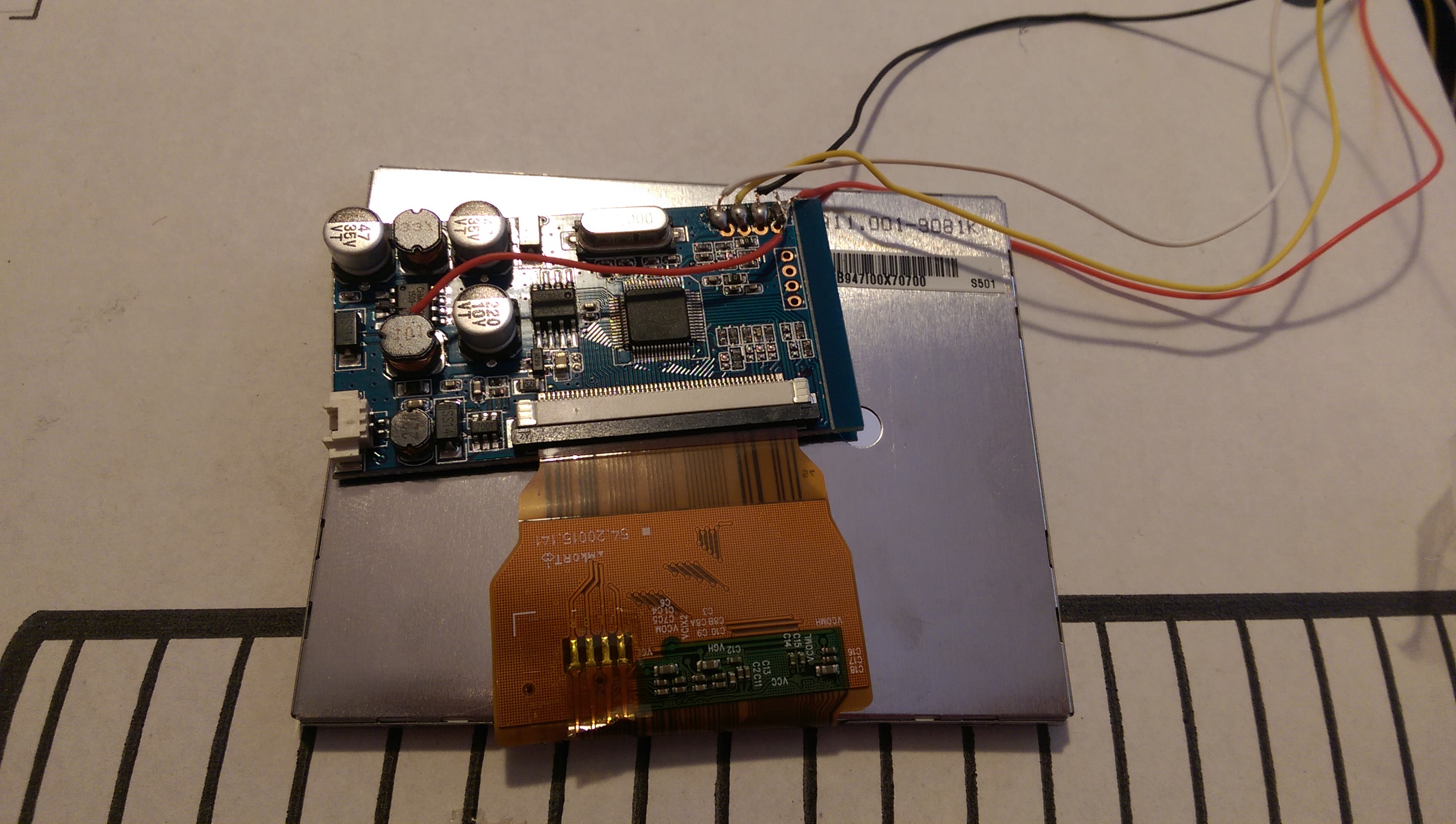

The board's tiny! It probably takes up about 30% of the total area of the screen itself:
Though it works on 5v straight out of the box, I added a bypass wire to eliminate some slight phasing. No chip removal necessary either!

Chunkee, I just bought this same screen from BW sold by e-life on Amazon USA and it looks identical. But it noticed on black screens that it has some white wavy action going on is this what the Phasing is? Will that go away if I add the bypass wire like you did?

I'd say go for it! If you do have the same Variant 7 board as mine then whilst it works straight out of the box on 5v, it's lacking that little bit of juice to consistently produce a stable image. For me, adding the jumper wire found in the wiki totally removed the wariness.
As long as you're sure it's a V7 then go ahead. You don't need to remove the chip from the board, so if you find that the wire doesn't really do anything you can just devolved it, and you're back to stock.
