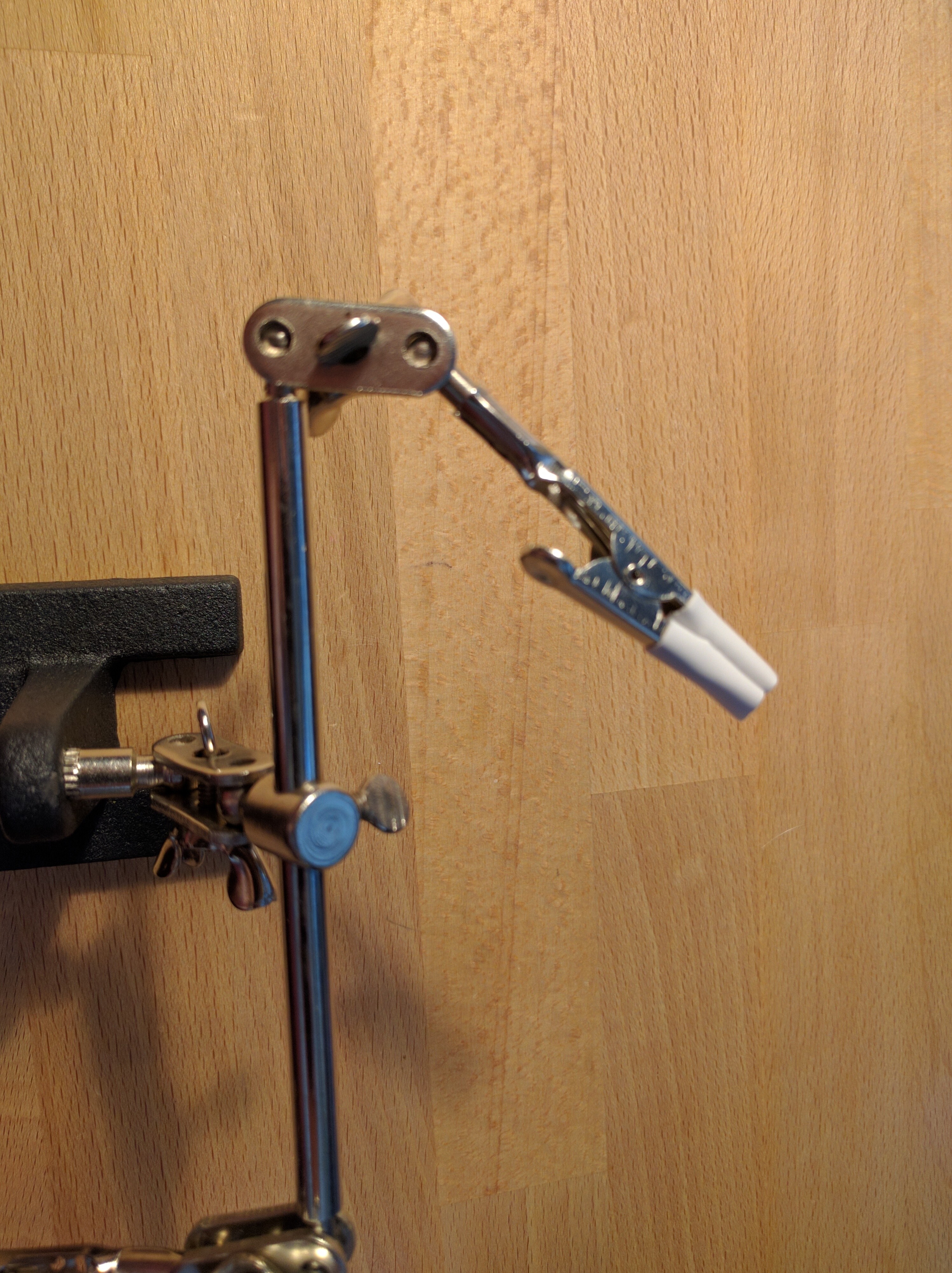

Post by wermy » Thu May 12, 2016 9:22 am
Heh, those actually came with a toggle switch: https://www.radioshack.com/collections/ ... 5717512773
I didn't use the rubber caps on the switch itself, found them in my misc bits/pieces drawer while trying to find something to cover the clips and make them more grippy. Worked nicely. :)
chiz
Posts: 228
Has thanked: 29 times
Been thanked: 119 times
Re: Rubber ends for alligator clip?
Post by chiz » Thu May 12, 2016 4:26 pm
Are you looking for these?

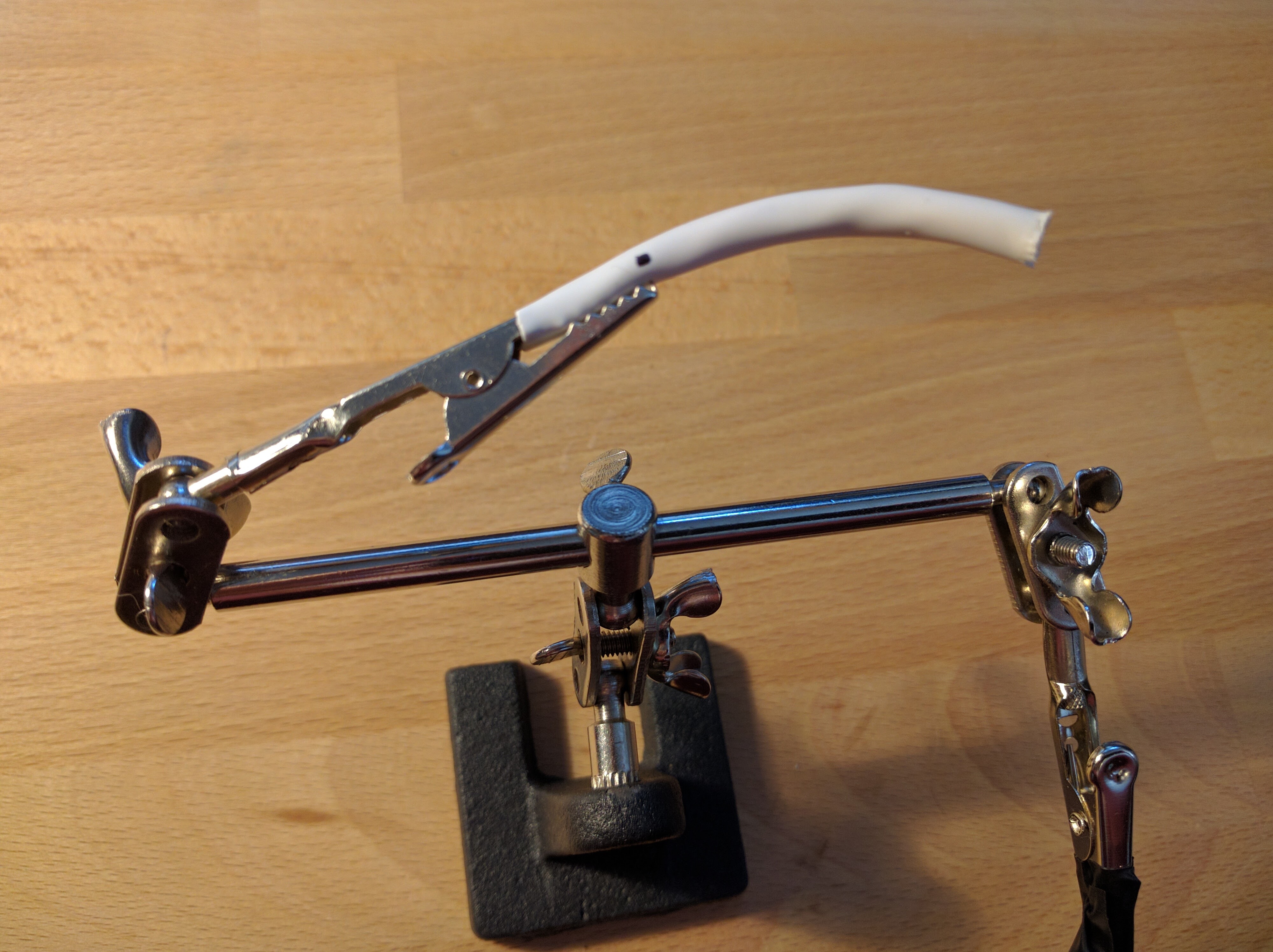

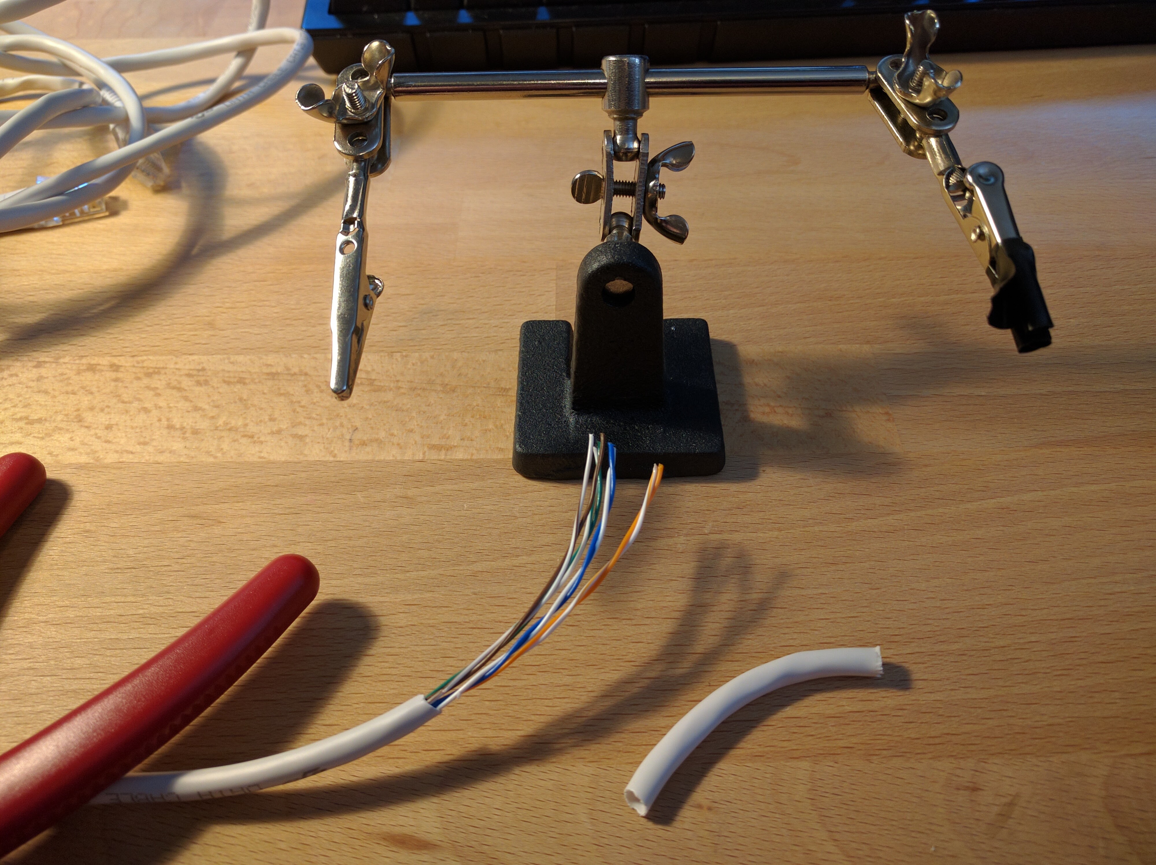

dirtybeagles
Posts: 386
Has thanked: 34 times
Been thanked: 64 times
Post by dirtybeagles » Sun May 15, 2016 7:47 am
This is what I did, sense I was using the wires from the eth cable anyways.

ylwsub68
Posts: 24
Joined: Thu May 05, 2016 6:27 am
Post by ylwsub68 » Sun May 15, 2016 7:48 pm
I just wrapped electrical tape around the ends. Not the most elegant but it works in a pinch.
dirtybeagles
Posts: 386
Post by dirtybeagles » Mon May 16, 2016 9:06 am
crispy_tofu wrote:Wow, that looks really good! Does it improve the grip significantly?
You lose the little teeth grips, but I think it works great. Worse case, you can just take it off if you do not like it. Most people do not keep the cable casing when they cut it for the wires.
