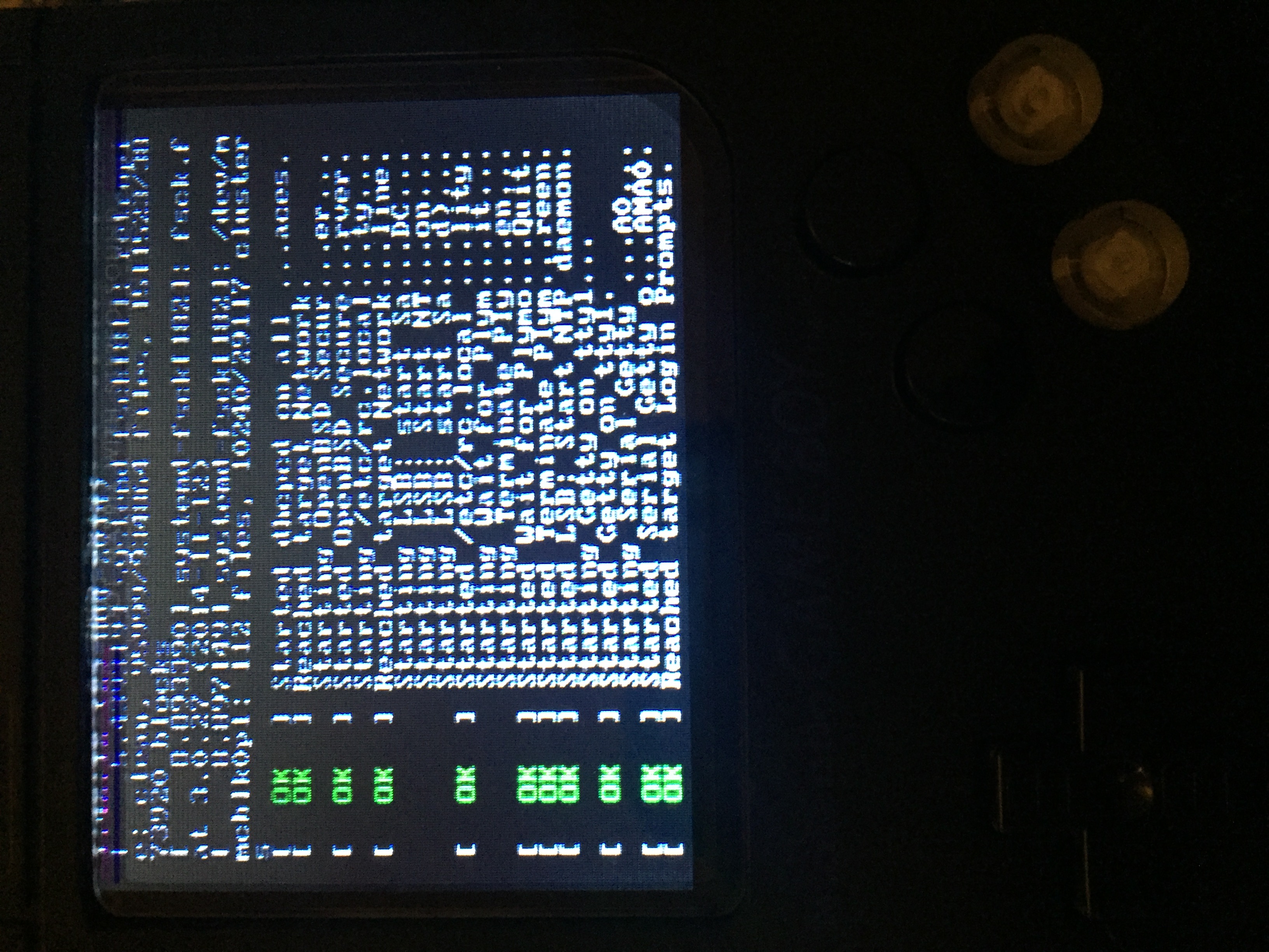

The screen resolution needs to be set in the config file... just open the file and look for the resolution settings, remove the hashtag and change the resolution to your screens resolution. It's likely 320 x 240. Should work for you... Here's how it looks with the proper resolution settings...Frodowills wrote:So I just built my GBZ and am working through some issues. Is there any way to make the screen readable? When in commandline I can make out like every other word. I'm using the BW screen.

This is what I was looking for! Thank you! Now to just find a RetroPie theme that looks good with a nice big font.JohnnyFYVE wrote:The screen resolution needs to be set in the config file... just open the file and look for the resolution settings, remove the hashtag and change the resolution to your screens resolution. It's likely 320 x 240. Should work for you... Here's how it looks with the proper resolution settings...Frodowills wrote:So I just built my GBZ and am working through some issues. Is there any way to make the screen readable? When in commandline I can make out like every other word. I'm using the BW screen.
