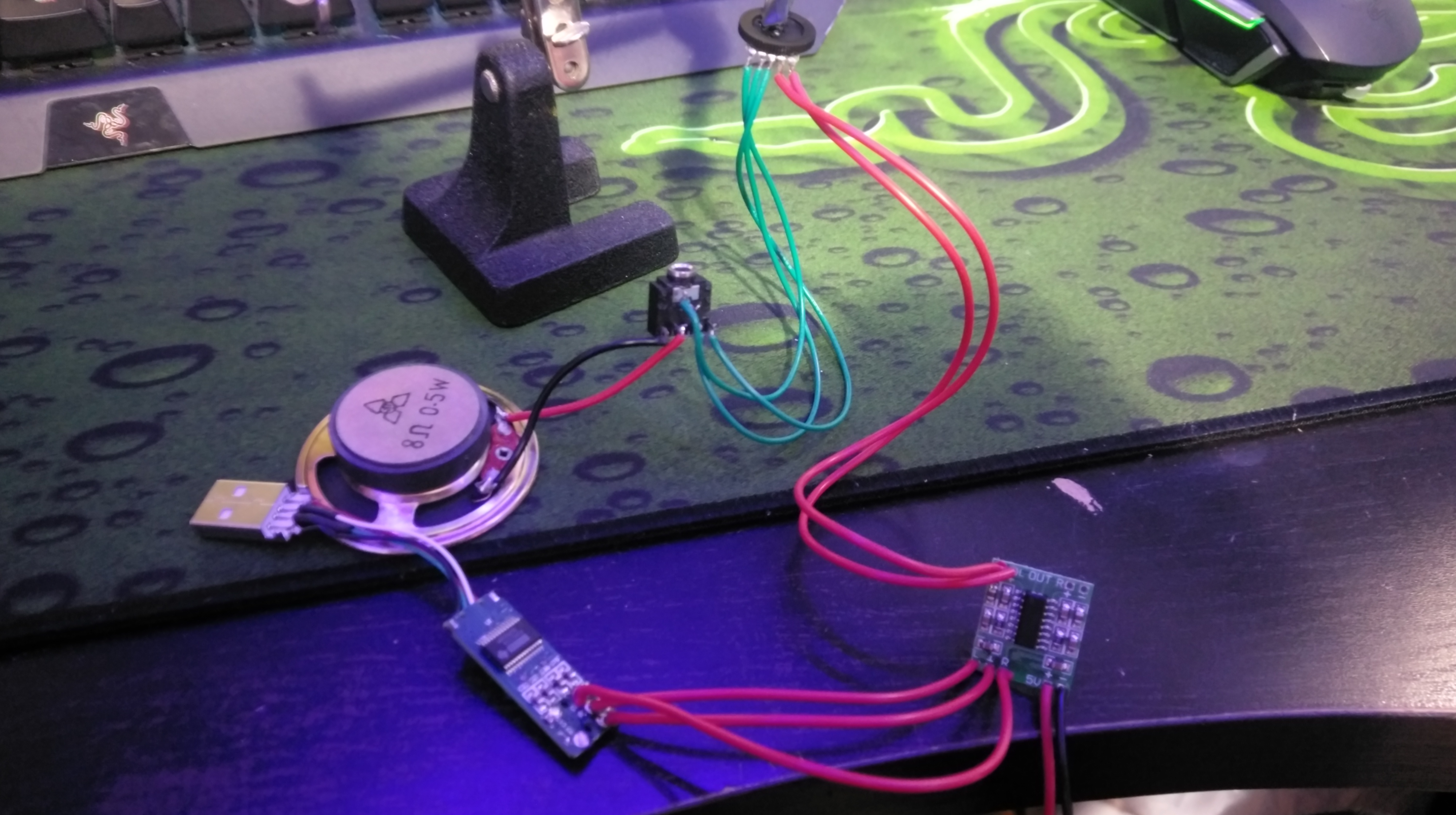

Hello, I'm having trouble with getting USB audio to work. I don't know what I'm doing wrong so if anyone could help me that would be great.
I'm a newbie at electronics...
Thanks.
~print
I'm using this diagram
Halp

Well, I would check first:
-does the USB sound card show up in a PC or on the pi when plugged in?
-Try connecting the L+R to one side of the speaker and ground to the other side, without the amp, potentiometer, headphonejack to test if it works before adding the other wiring
-Is your potentiometer wired correctly (may not be same type/model as diagram)
Then we can continue troubleshooting. Good luck :)

Thanks, the sound card is being picked up by the PC, the speaker works with the L±R wired up
I don't know how to wire up the potentiometer though...
It's a B103.
Thanks again

Looking at your wiring, you wired + and - of the left channel into both inputs of the pot.
You only need to wire the + into the pot (and of course the ground as well). (Your audio will be mono). Or add the + of the right channel to the pot as well.
From your picture I would say, from left to right:
1. ground
2. first output
3. second output
4. second input
5. first input
Not sure about the output / input ordering......I'll check my wiring when I'm at home

TimBer wrote:Looking at your wiring, you wired + and - of the left channel into both inputs of the pot.
1. ground
2. first output
3. second output
4. second input
5. first input
I'm confused... Diagram?

Something like this. I do not know your audio jack wiring.
But again....I will check my exact wiring this evening (4 to 5 hours from now for me ;-)

Just found out I'm using a B503....not a B103......not sure if they are compatible....but for the schema:
Note that you can combine the output to the speaker for both channels (you need an additional schema with additional resistors for that) ....for simplicity....I just connected one channel.
