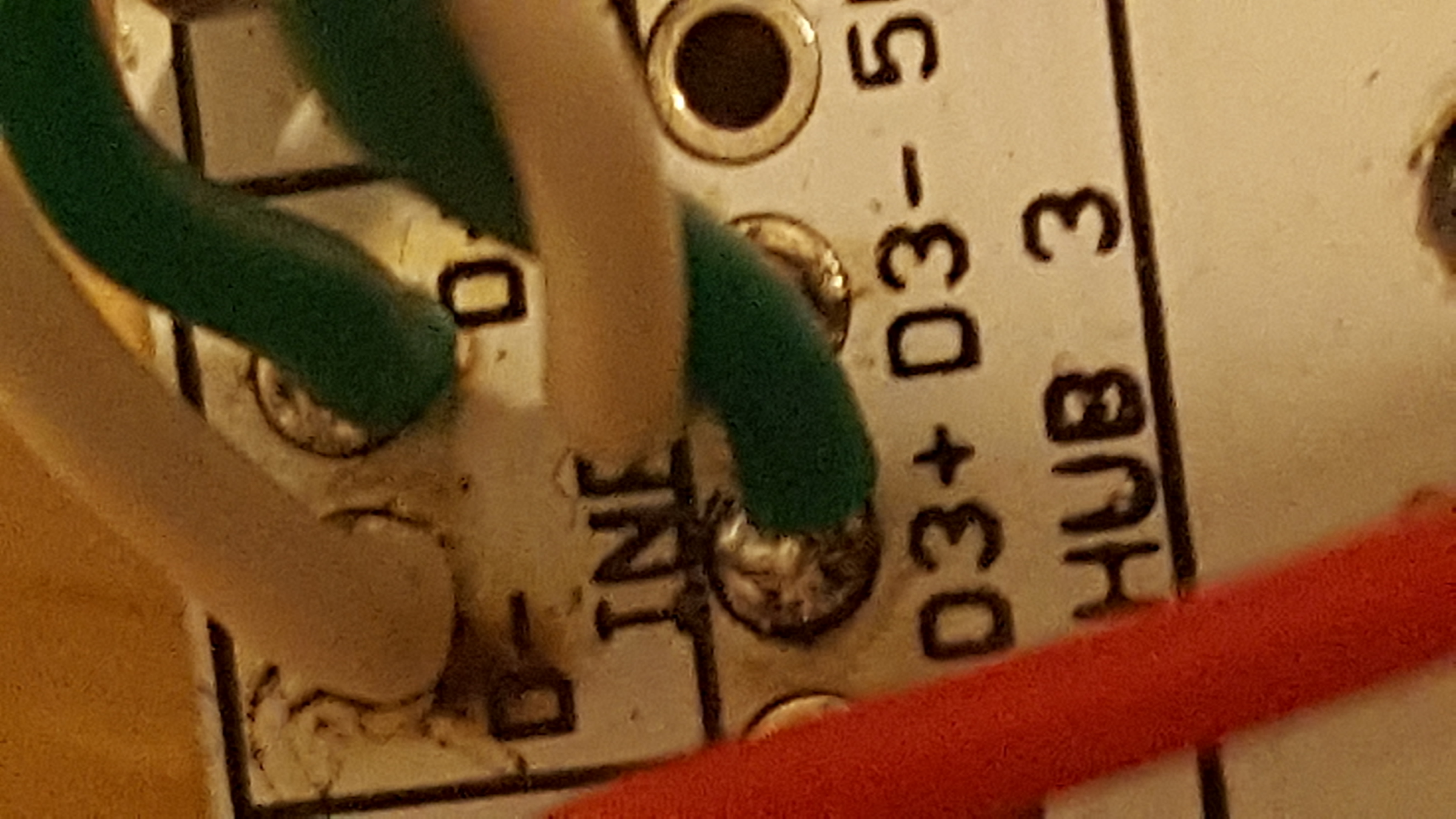

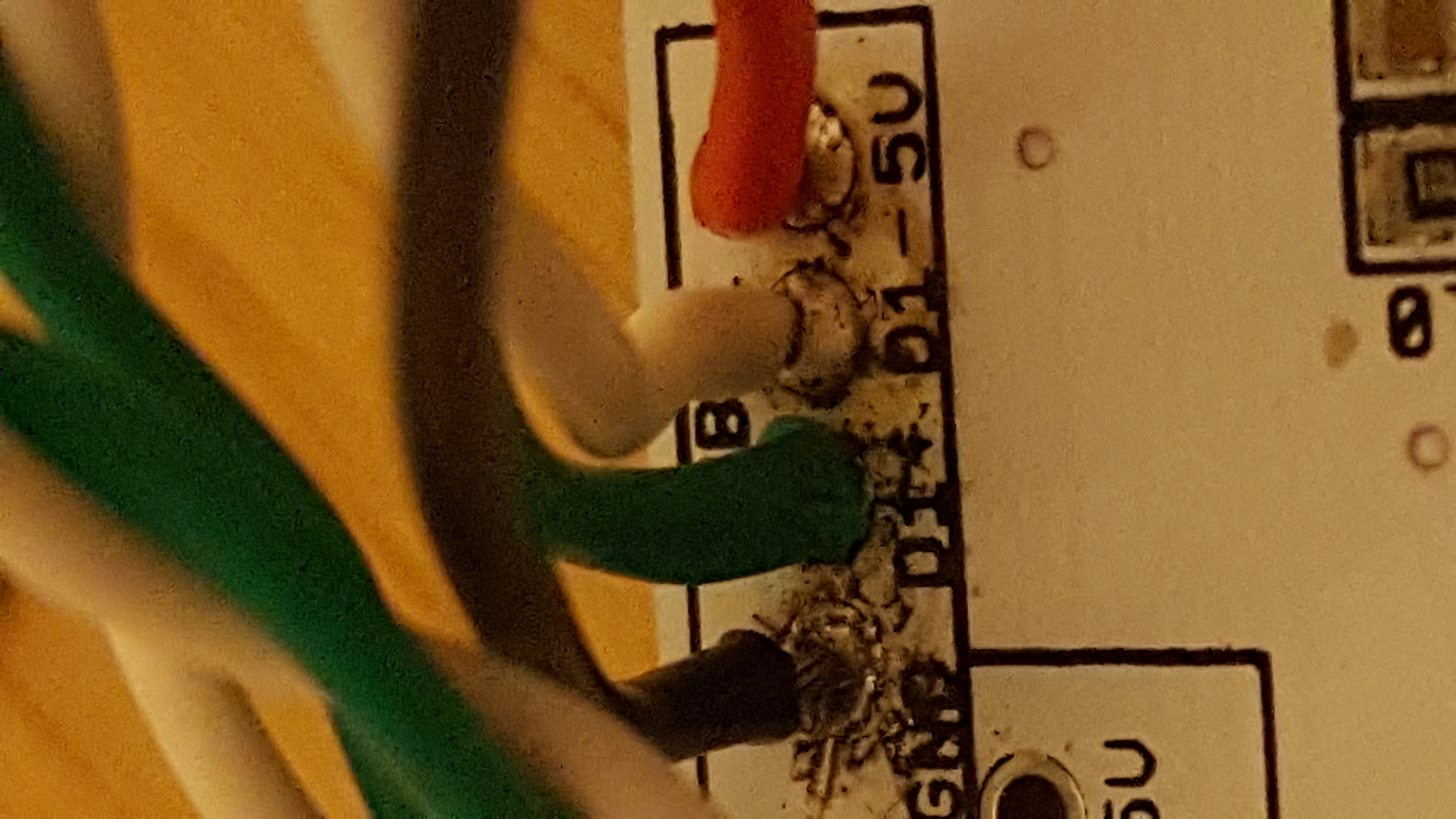

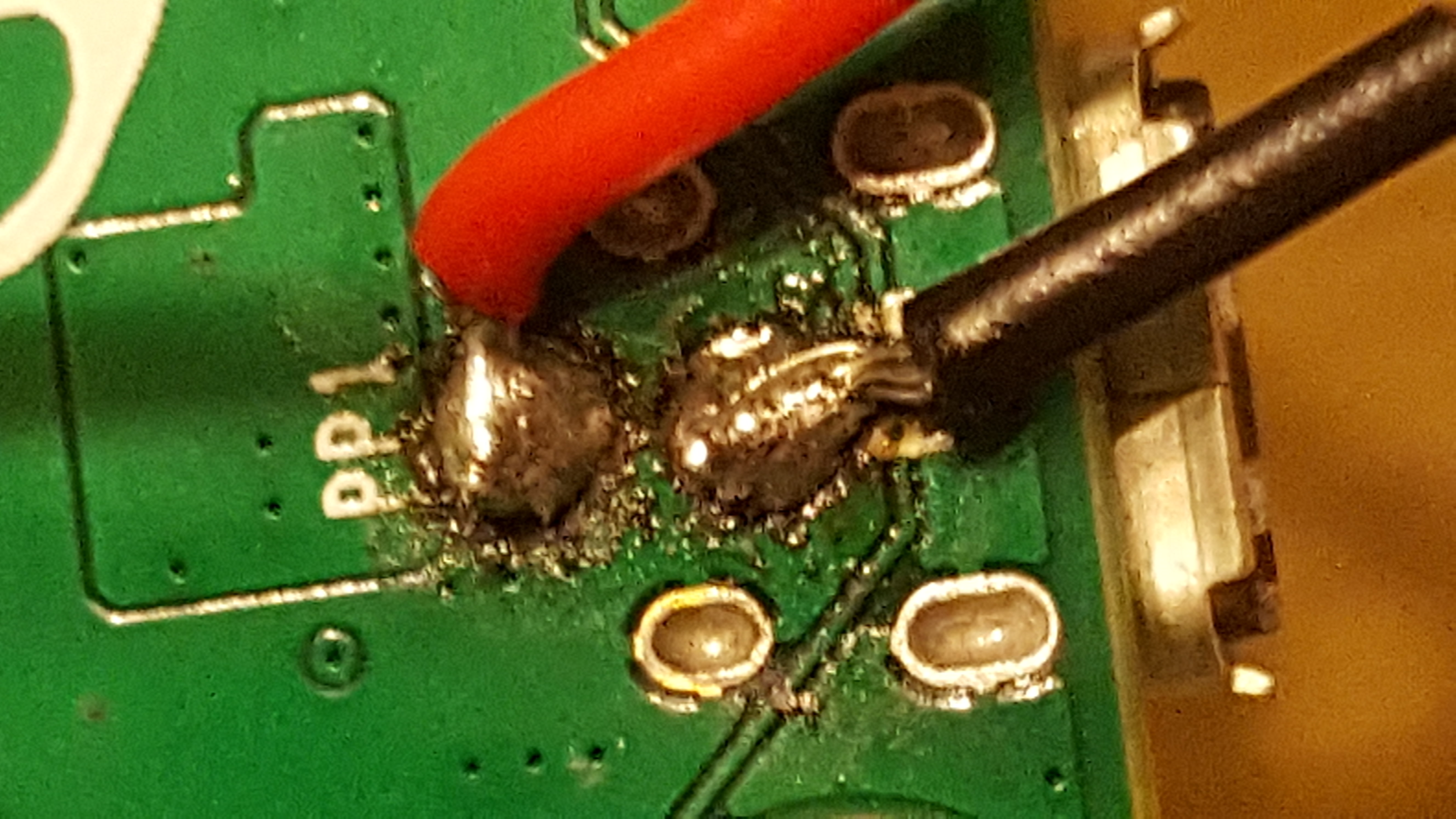

If you wiggle it and it shuts off you have a short or loose/cold solder joint. Post pictures and plenty of them because people will post 1 picture and expect us to help fix the problem when it's often in other parts of the wiring.

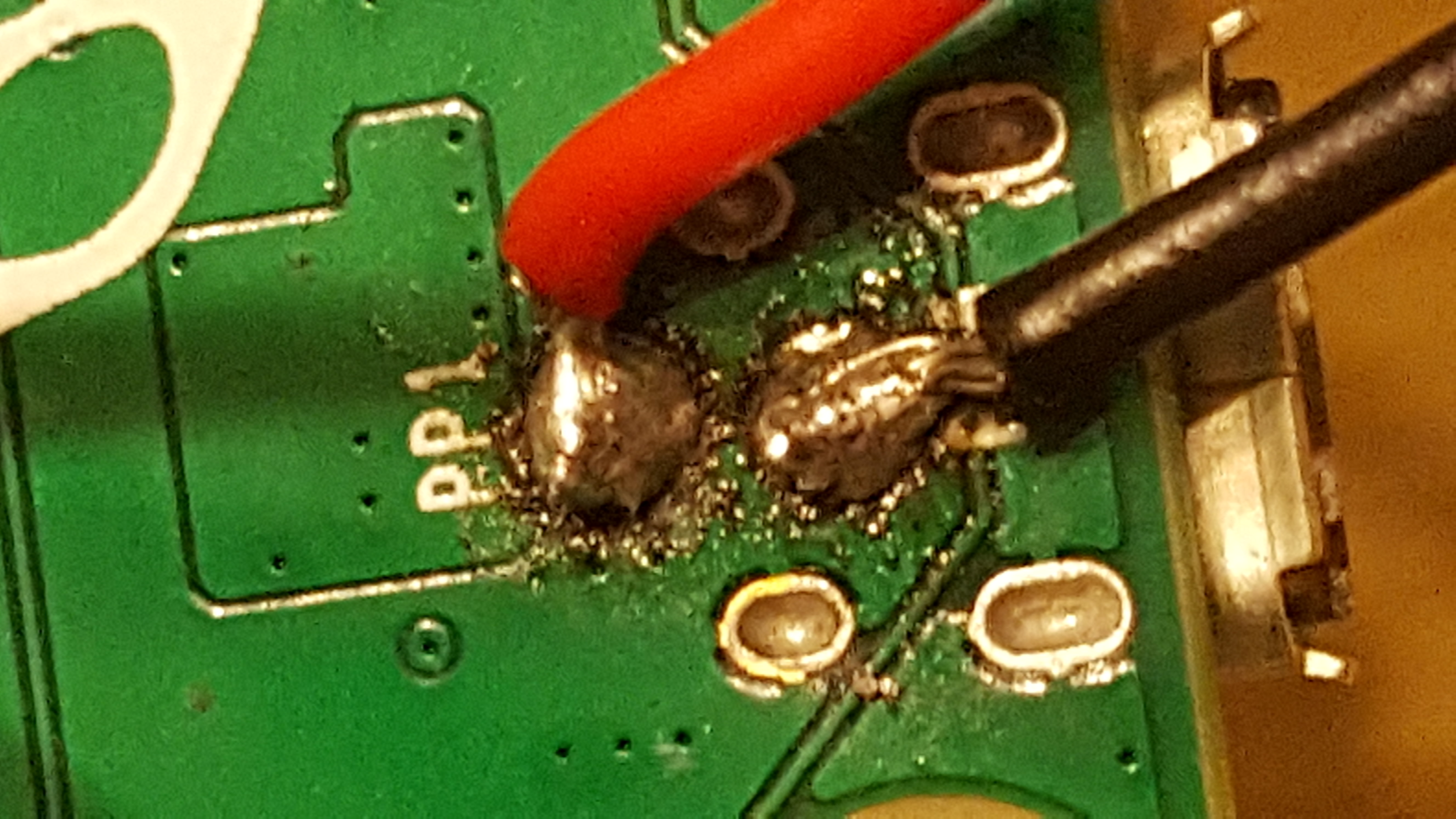

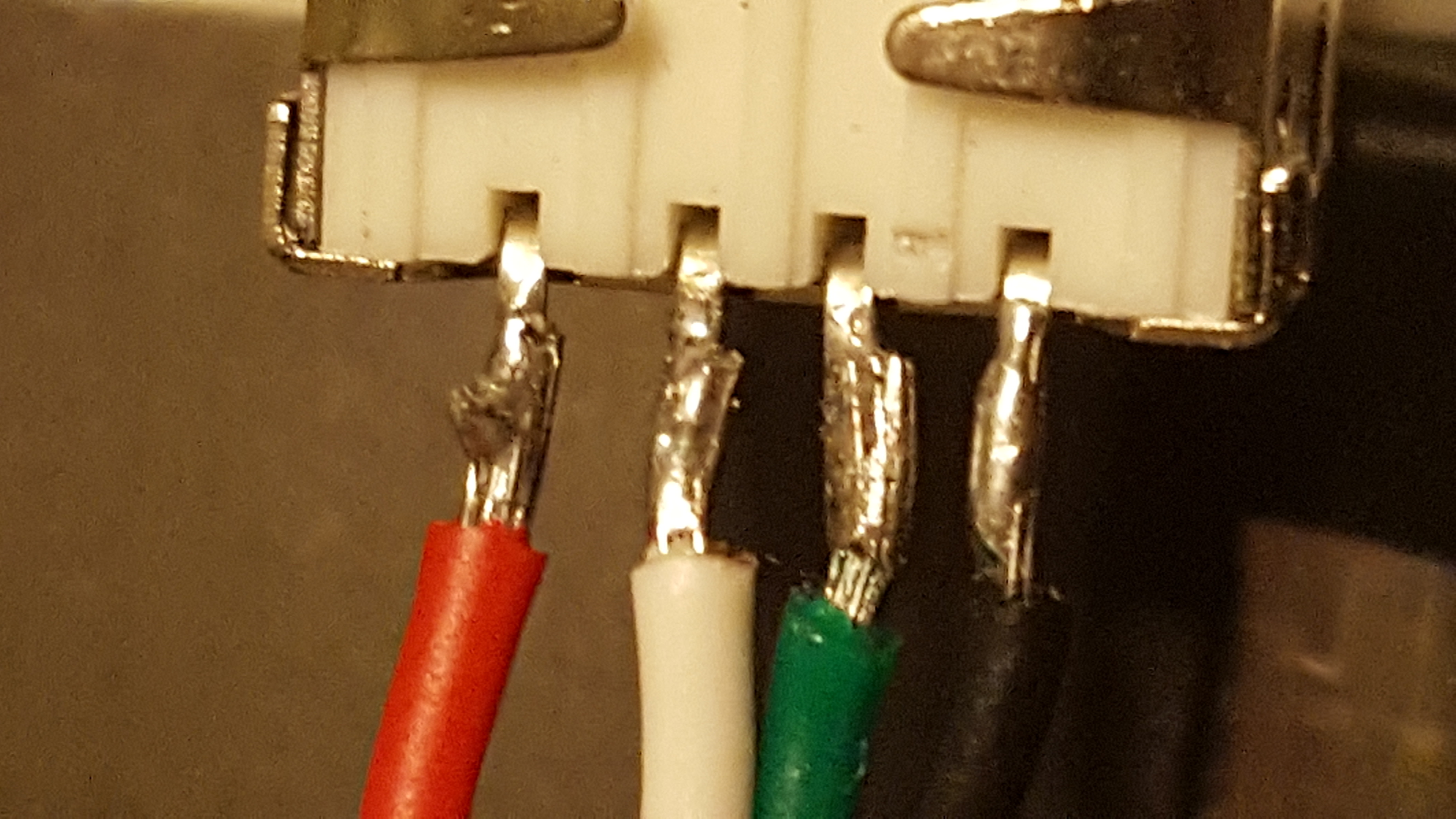

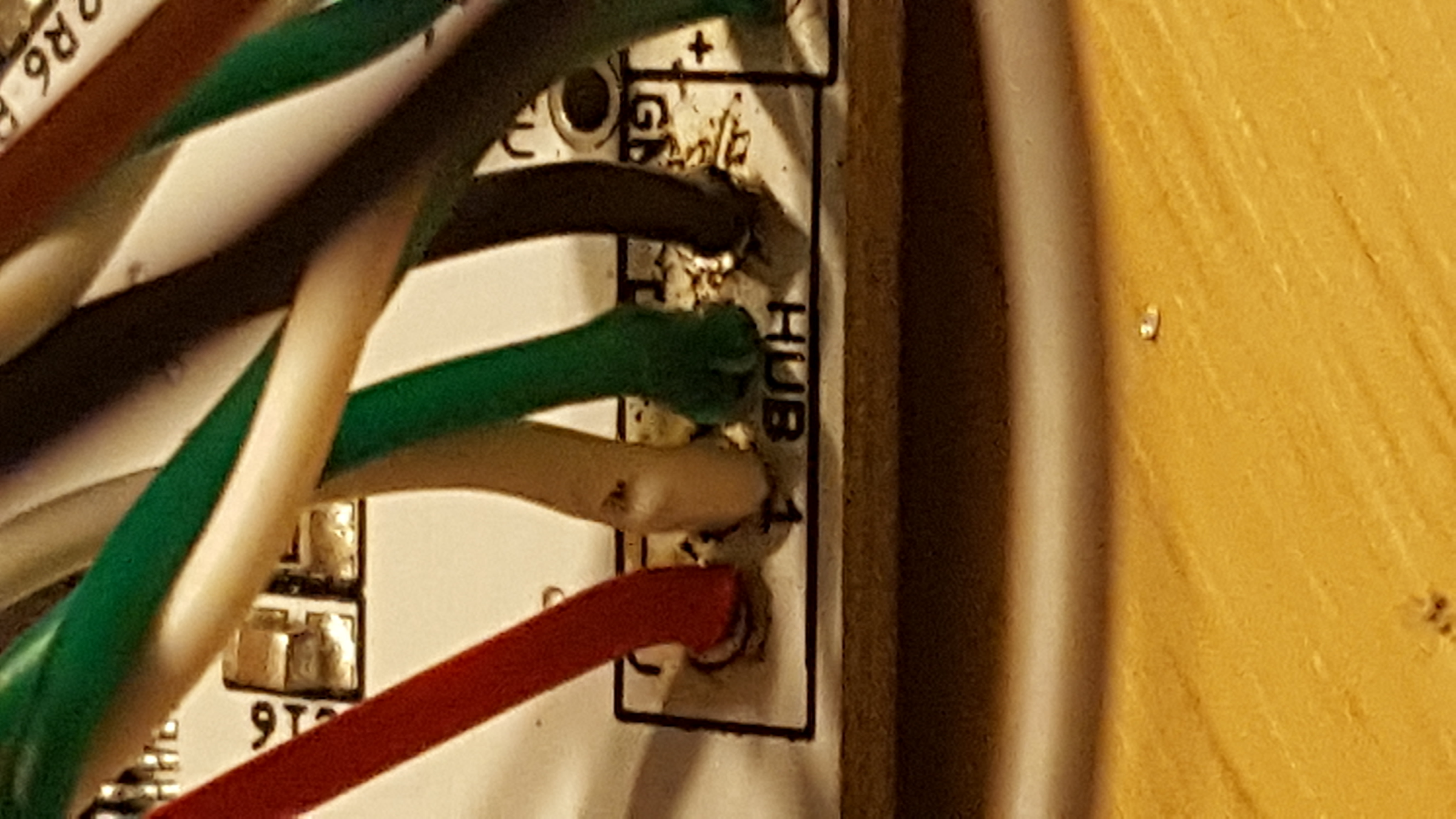

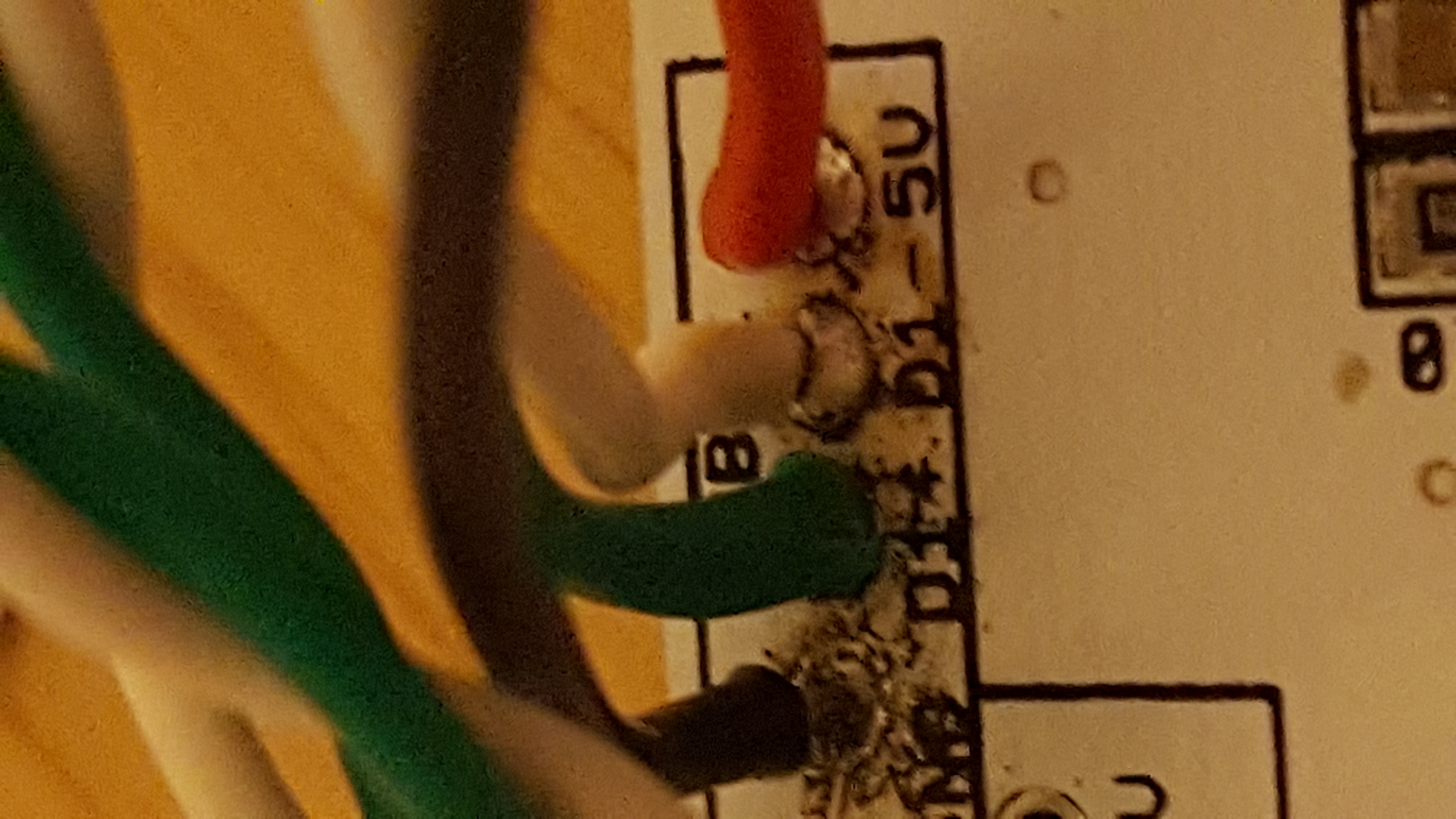

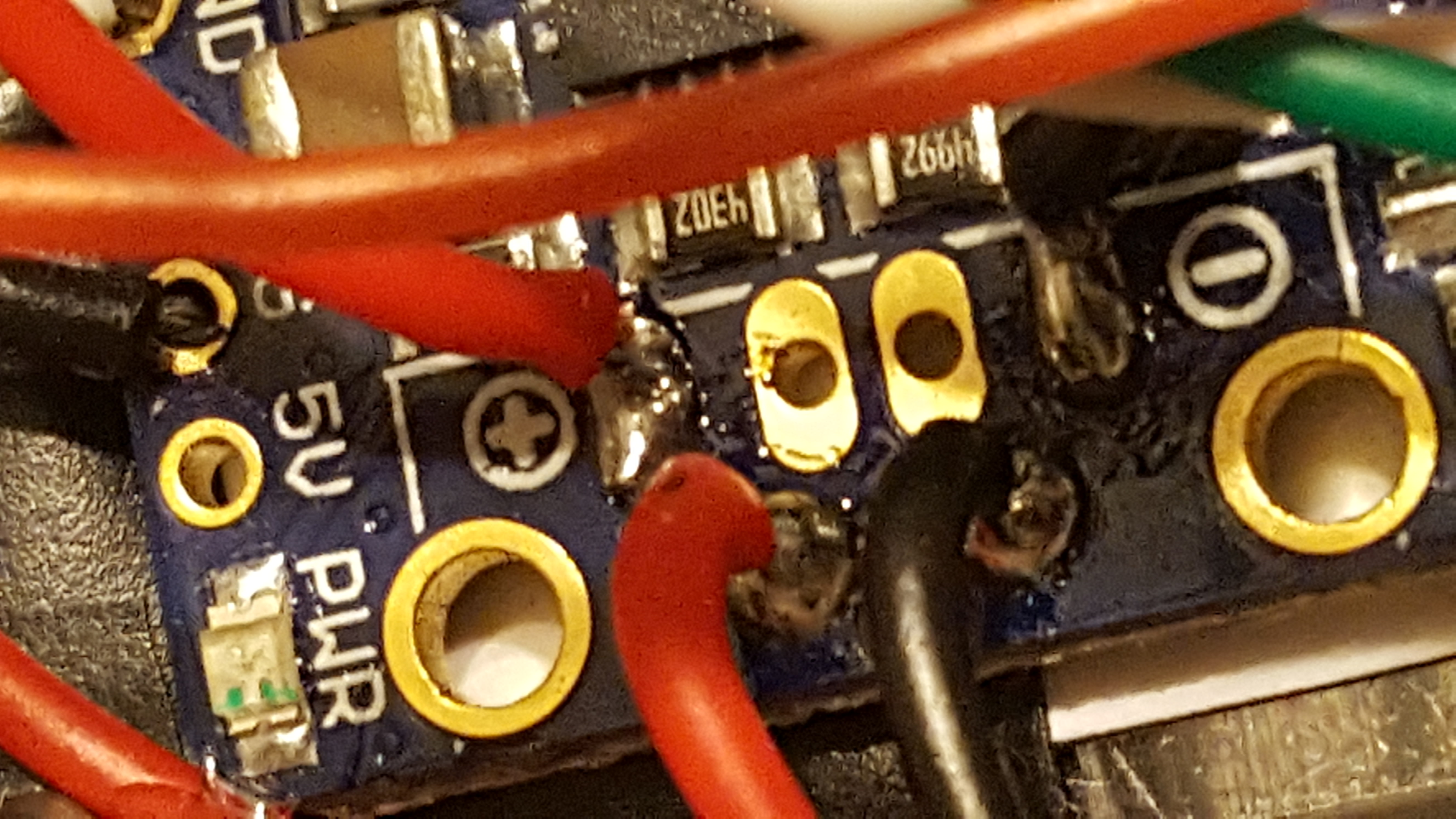

Post by Zacarycaine » Tue Jan 24, 2017 11:30 am
Helder wrote:If you wiggle it and it shuts off you have a short or loose/cold solder joint. Post pictures and plenty of them because people will post 1 picture and expect us to help fix the problem when it's often in other parts of the wiring.

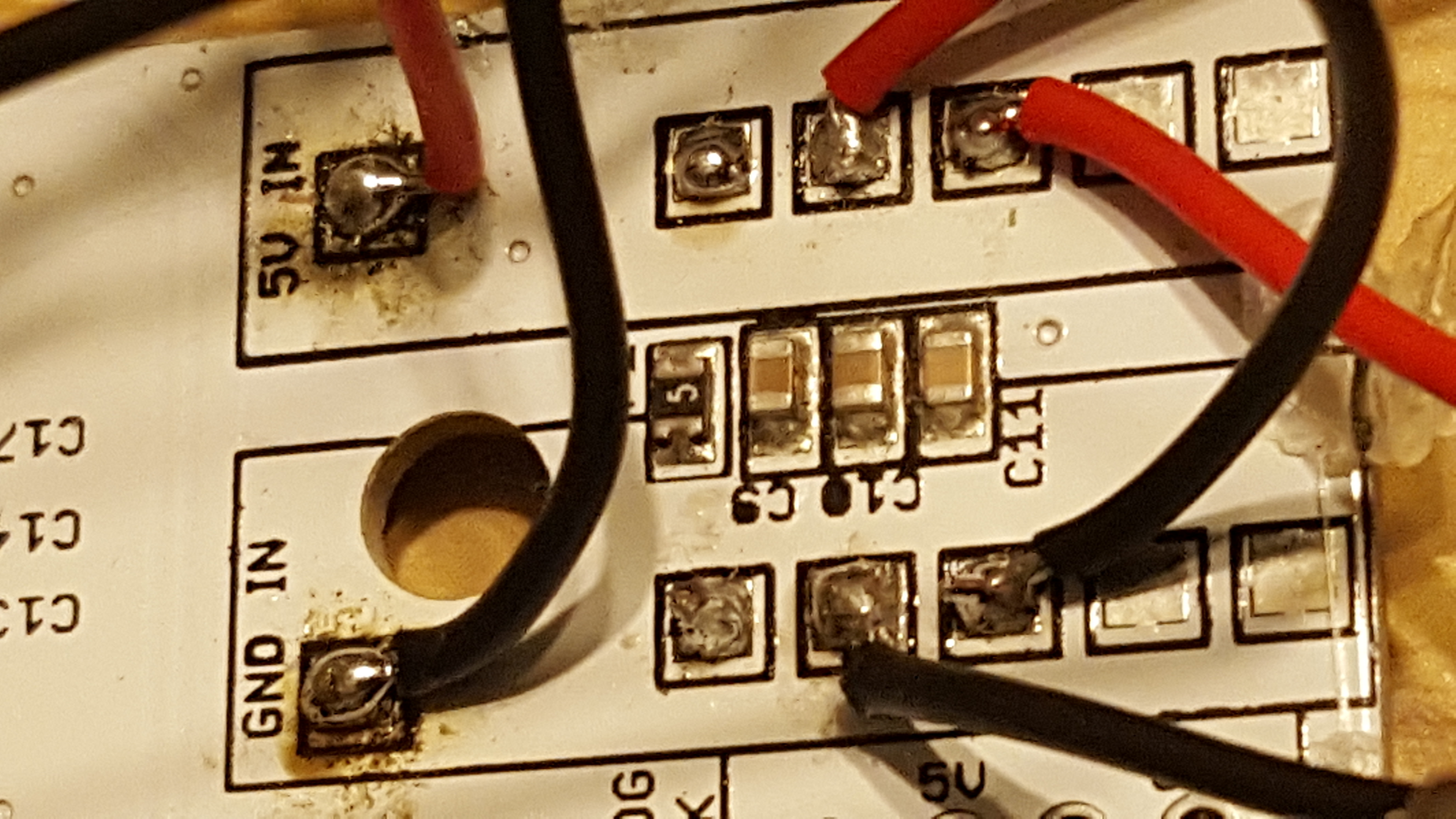

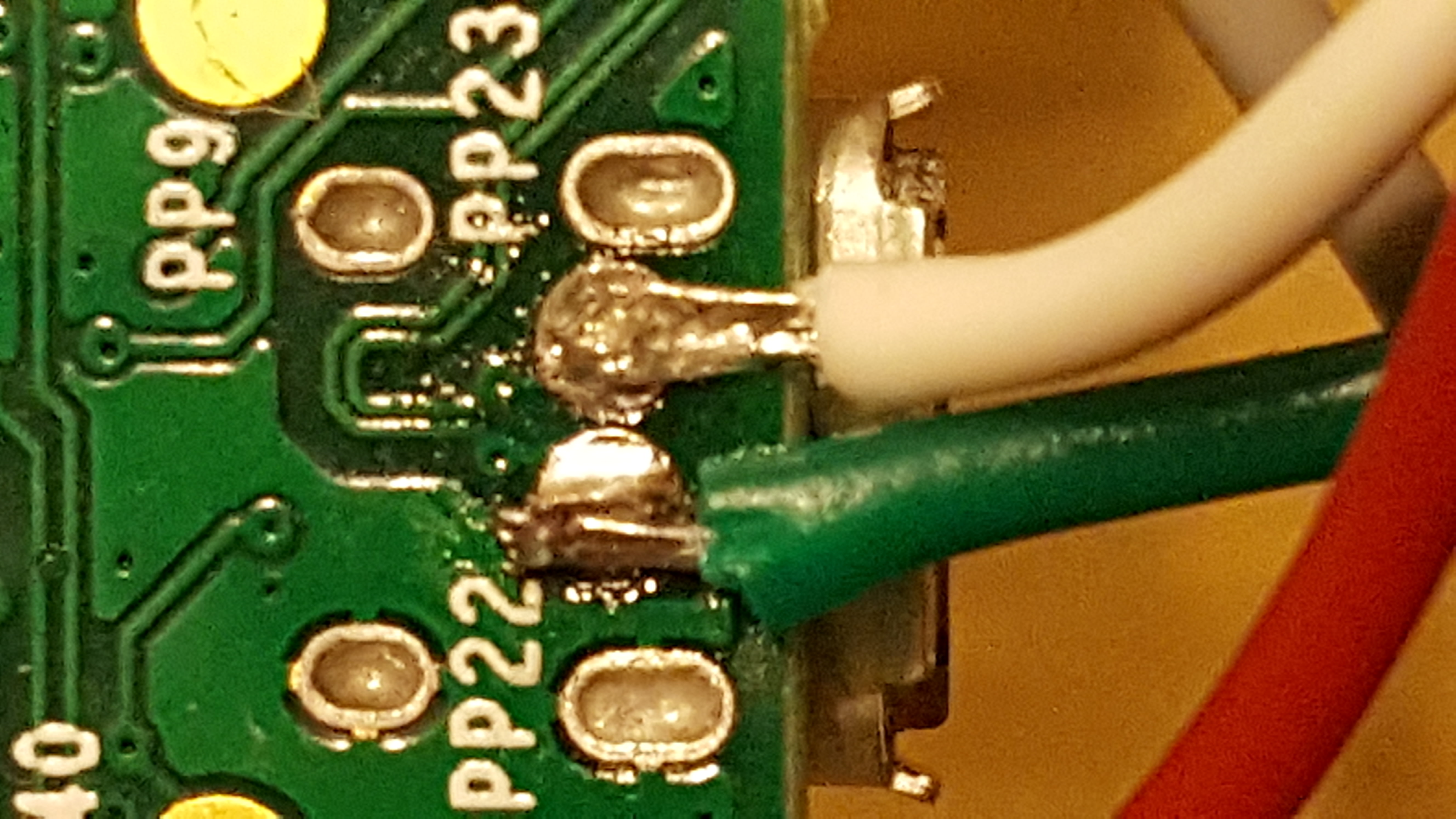

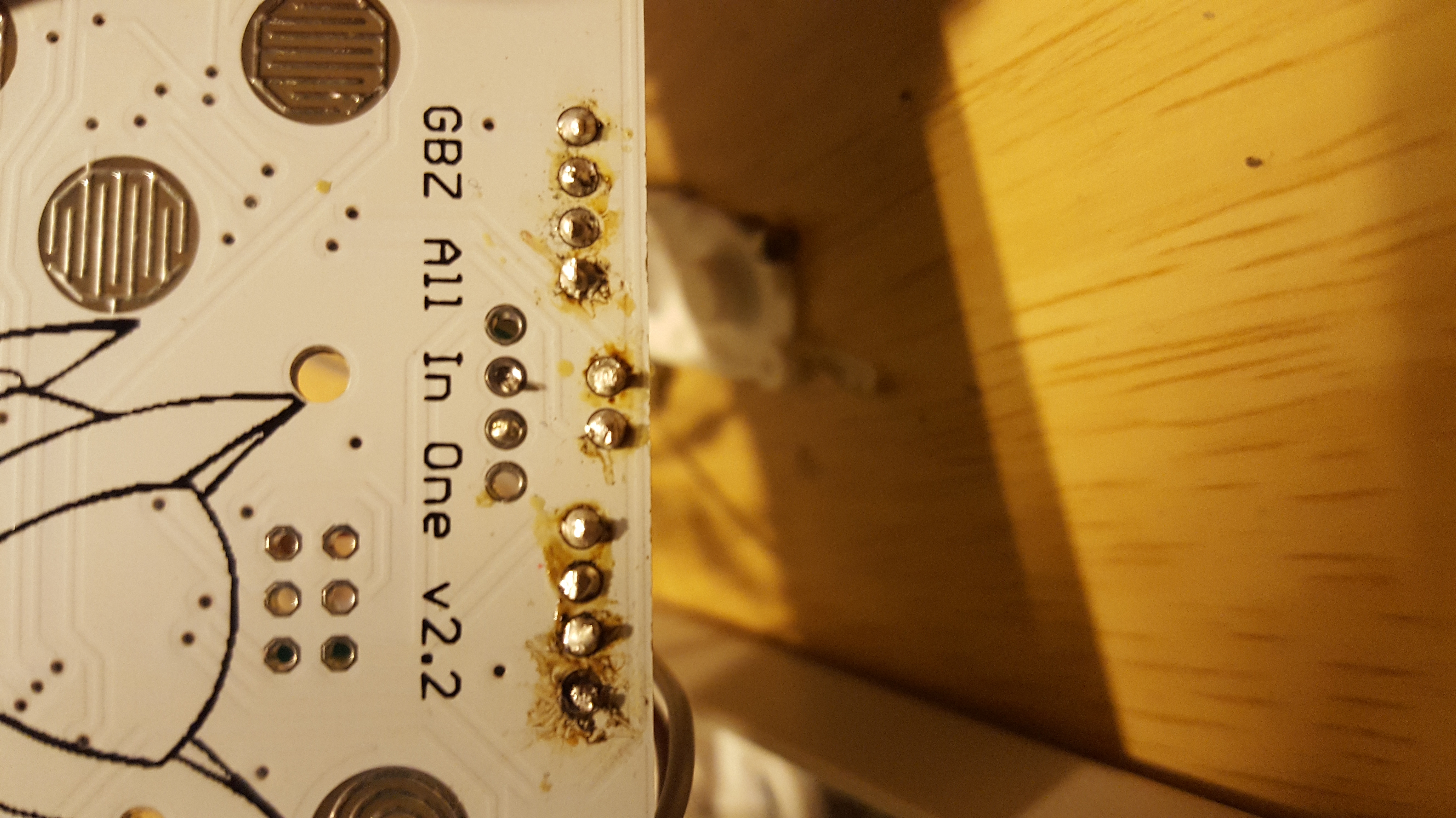

Here are some pictures.
I've tried re soldering some stuff but still no luck.
I have a feeling my controller board is fried but I dont know.
Any help is appreciated.

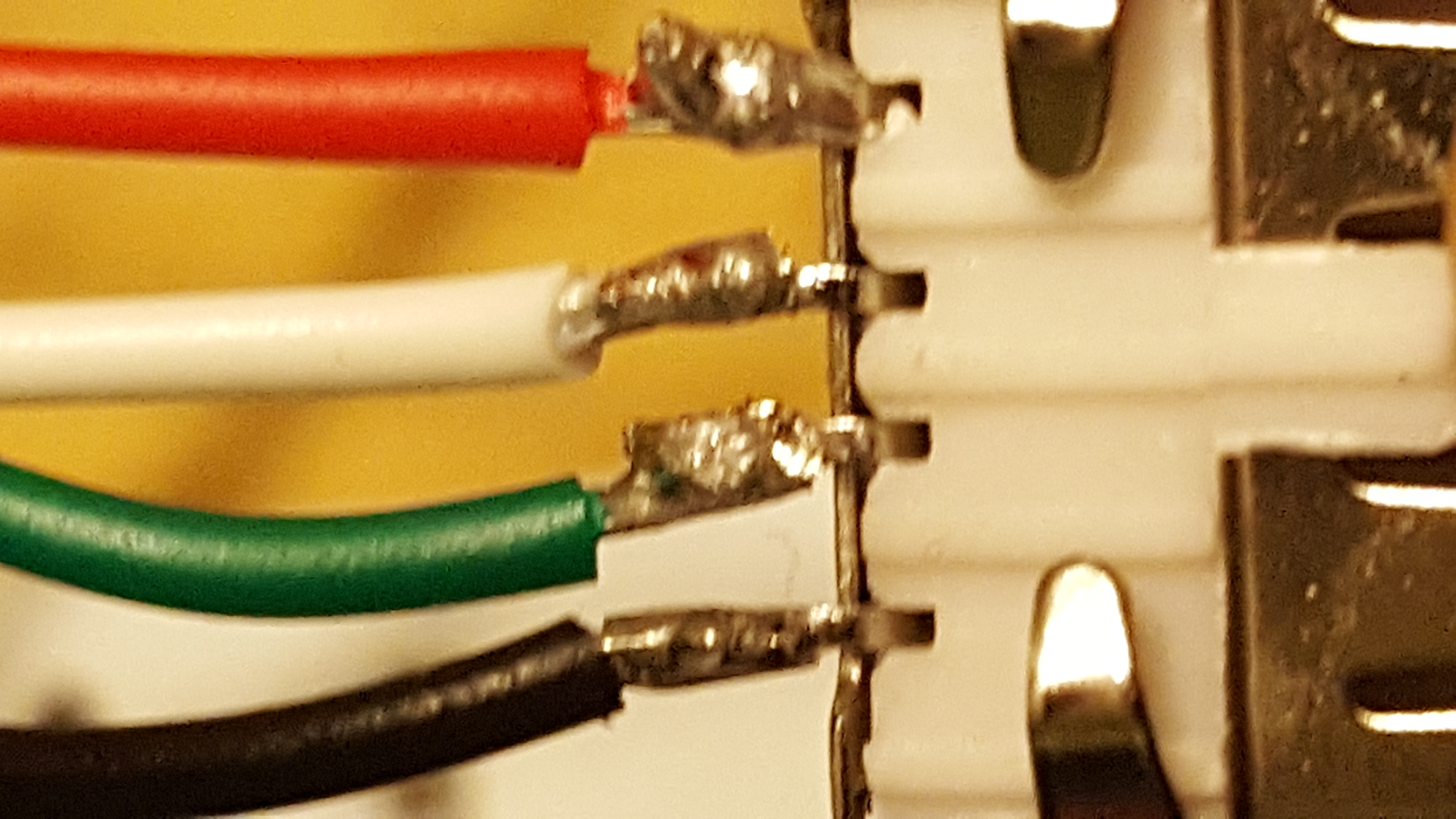

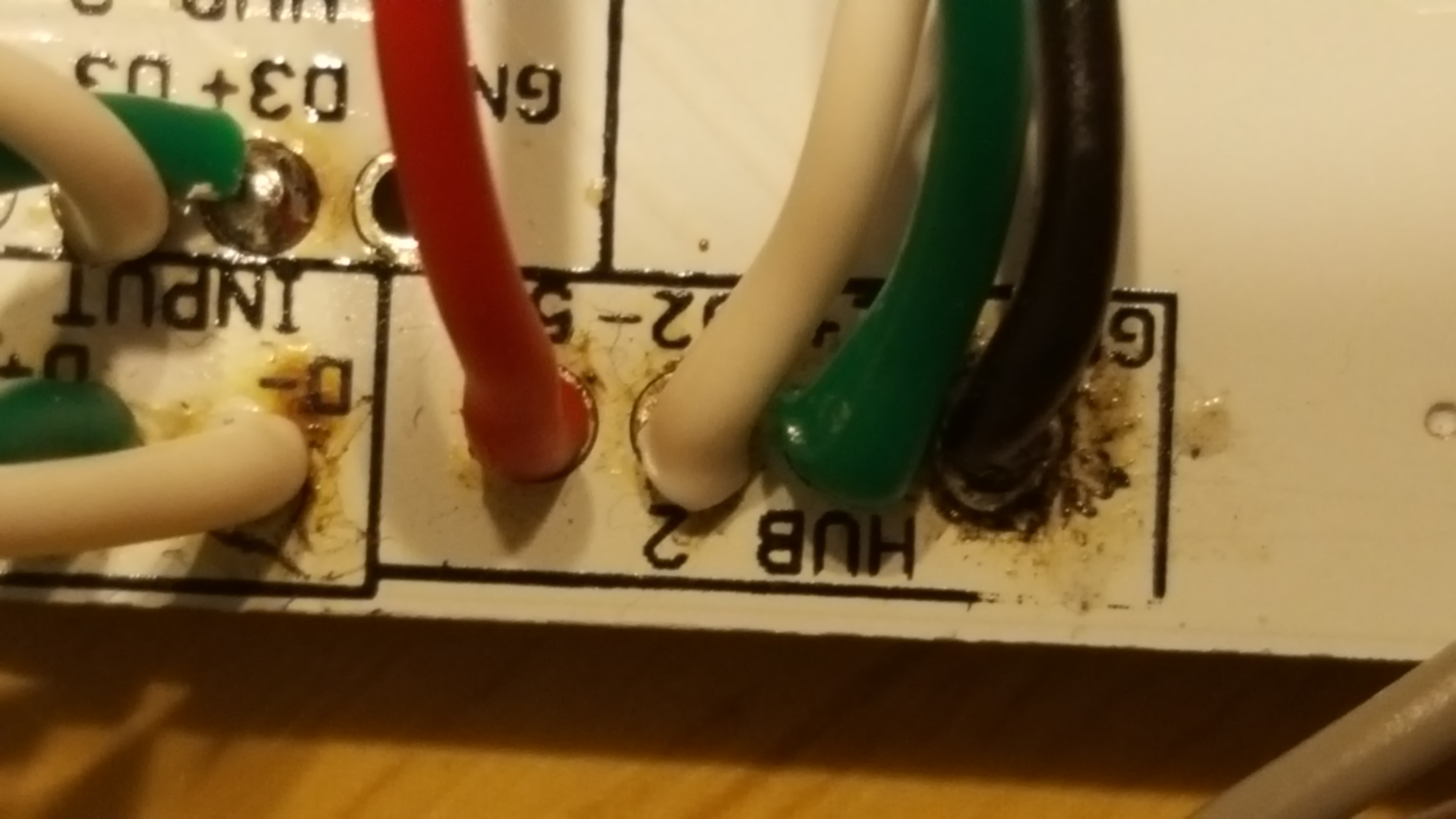

Post by Zacarycaine » Tue Jan 24, 2017 11:38 am

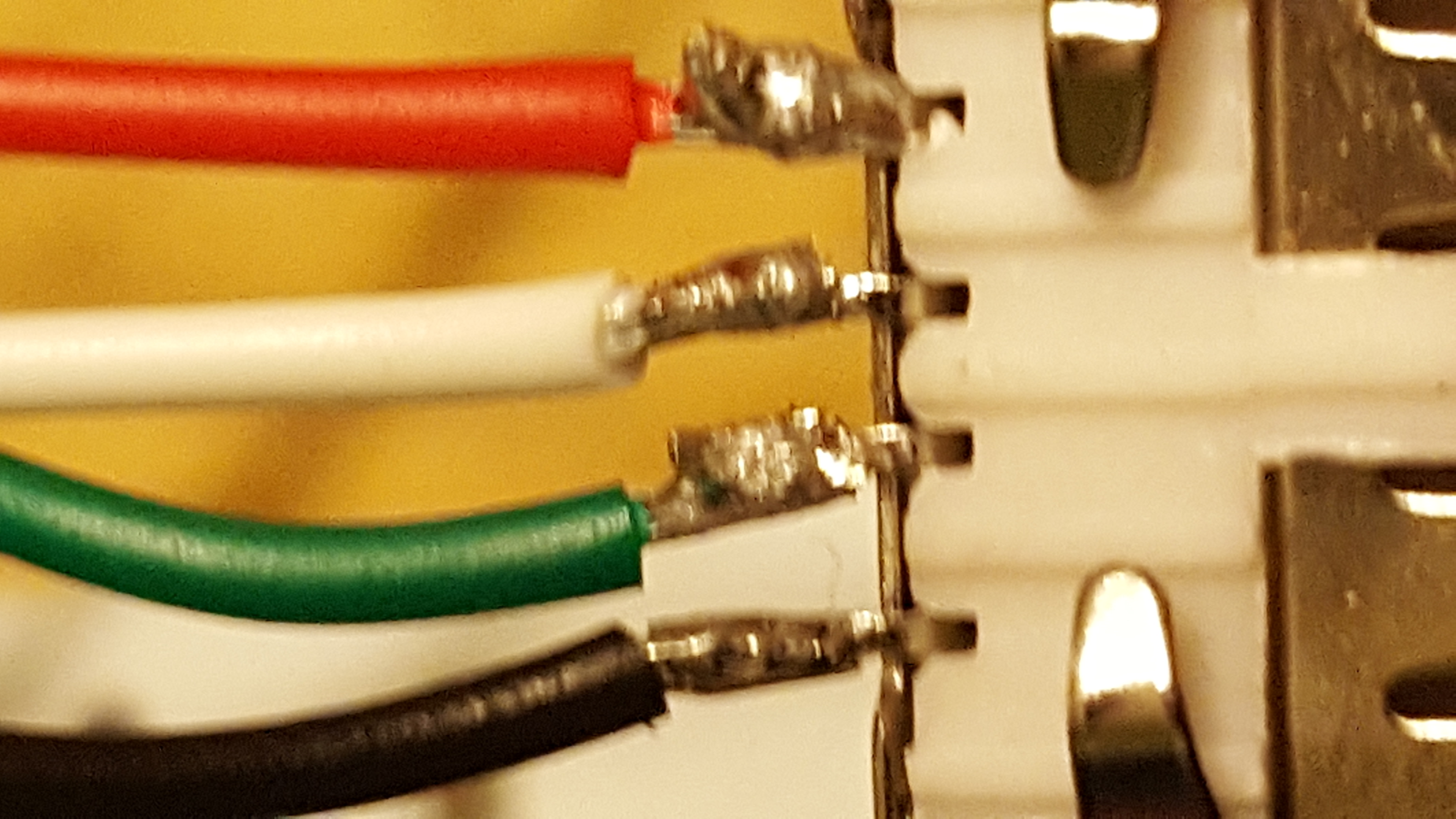

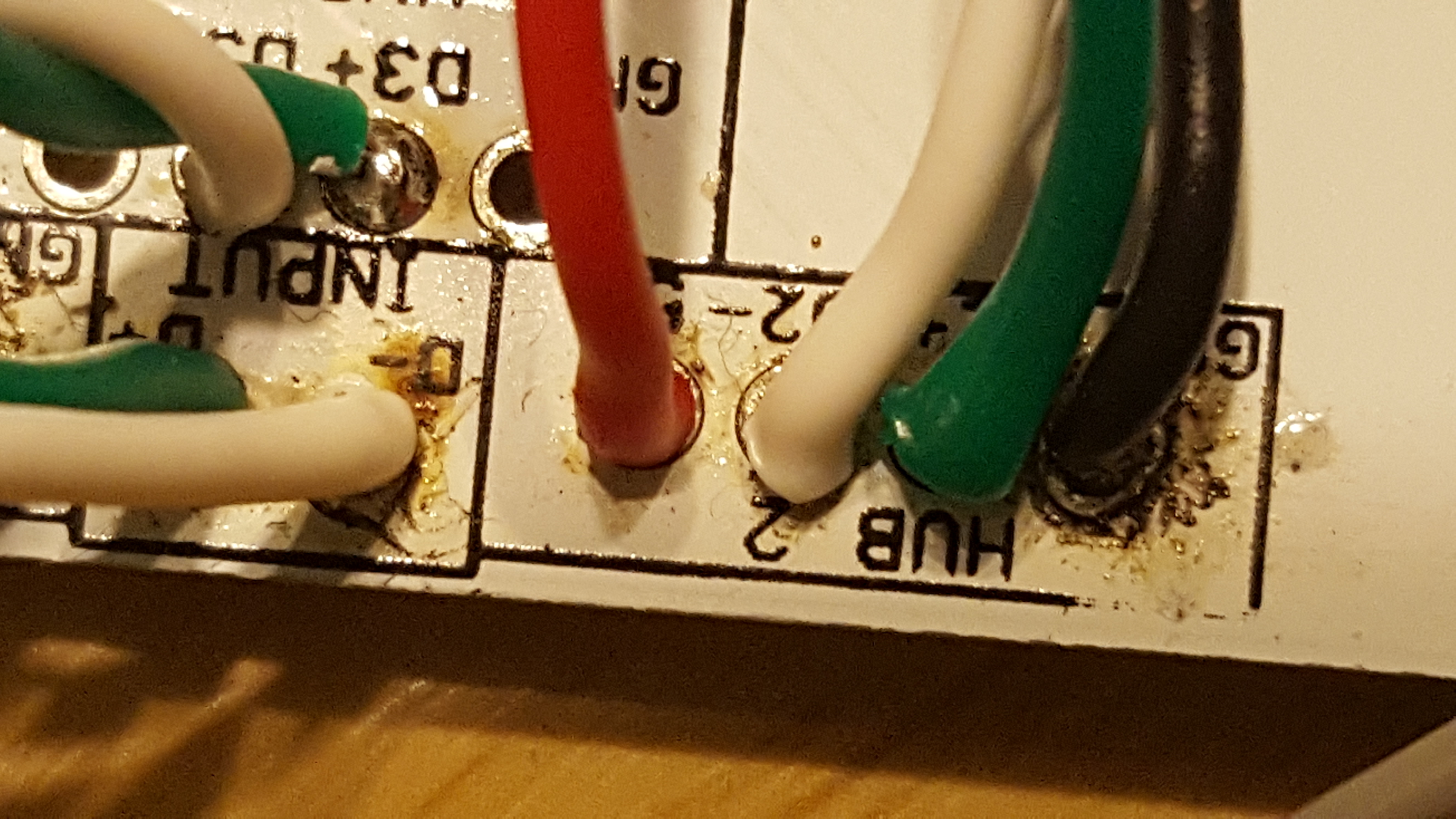

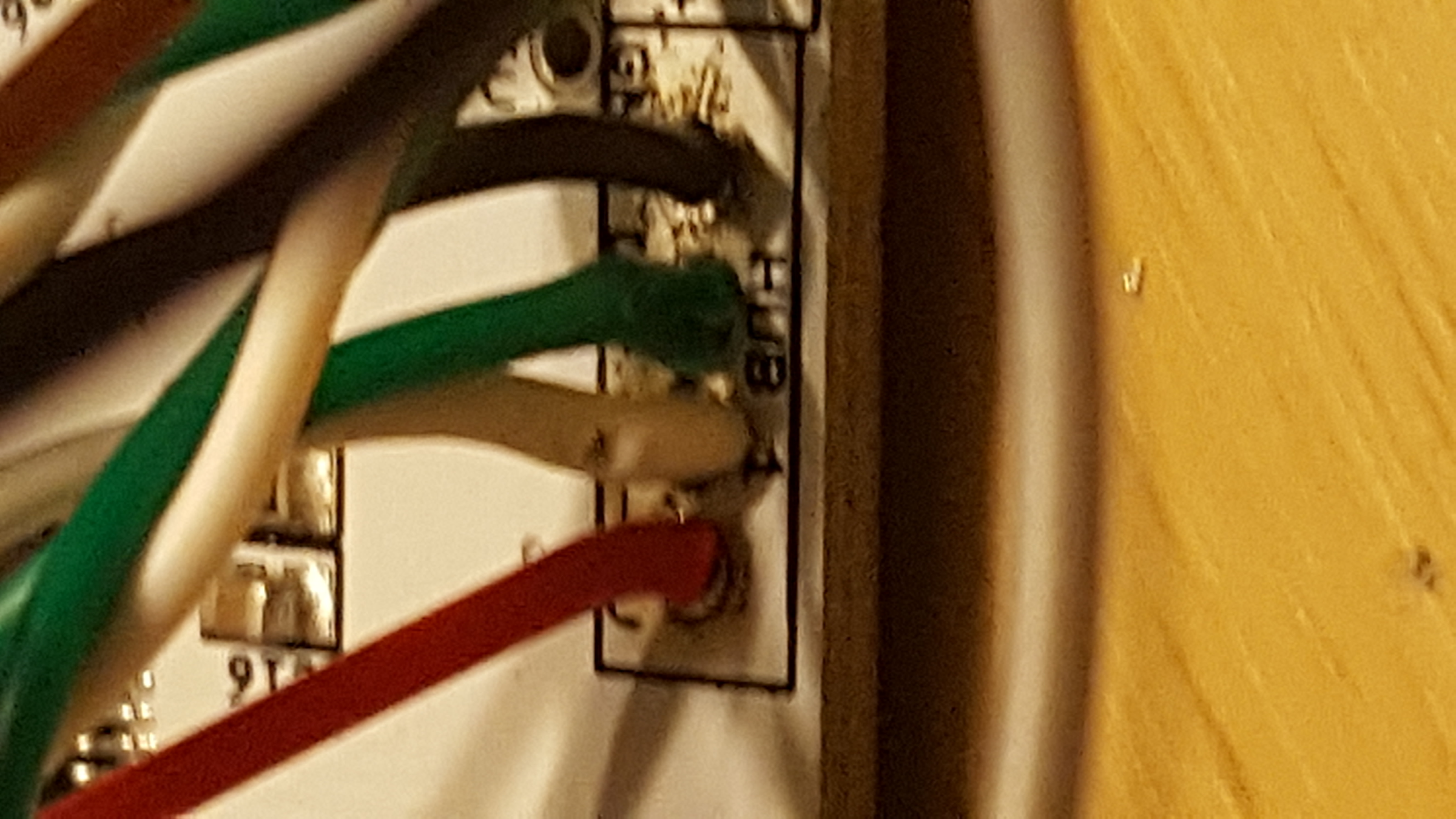

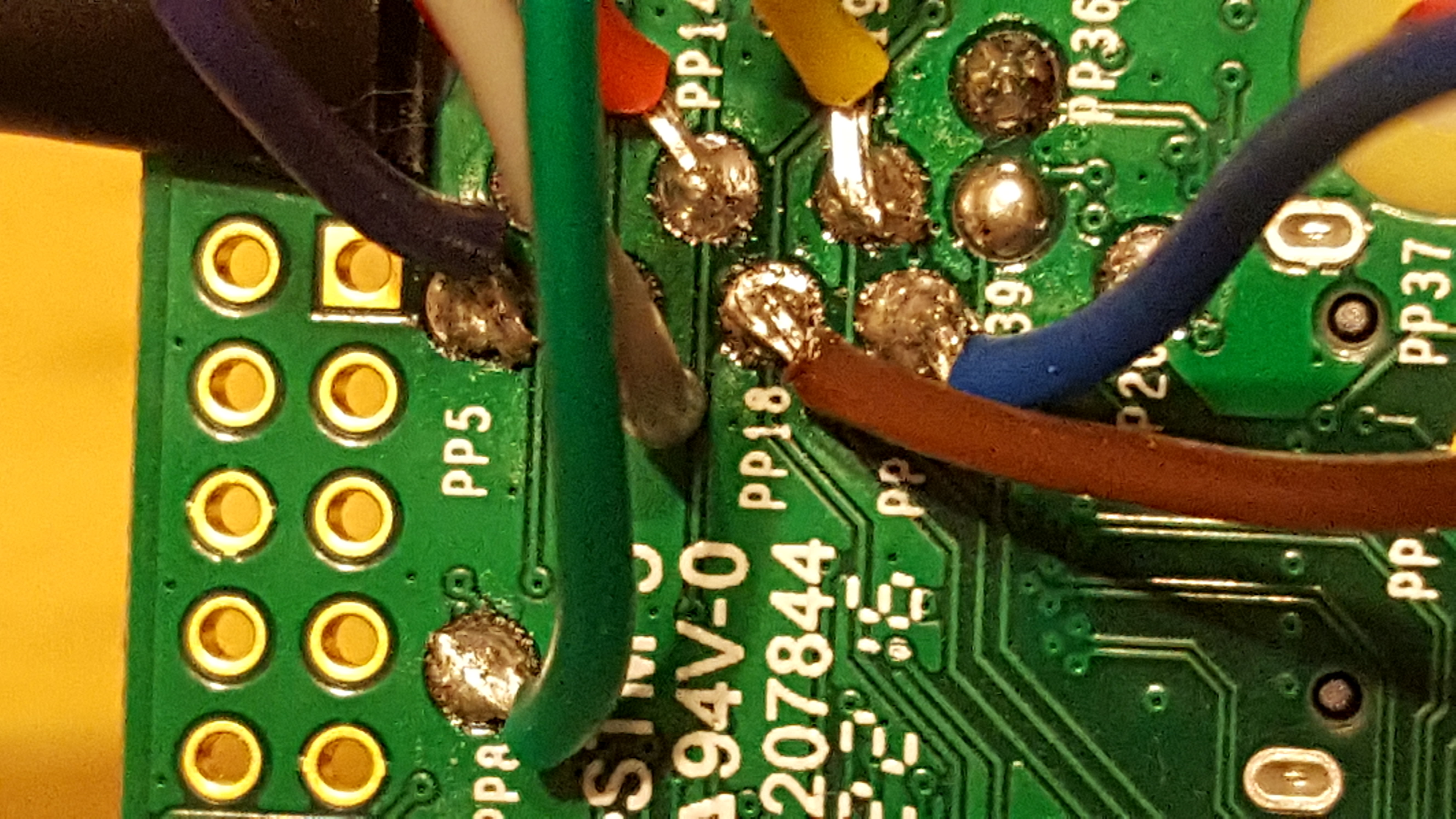

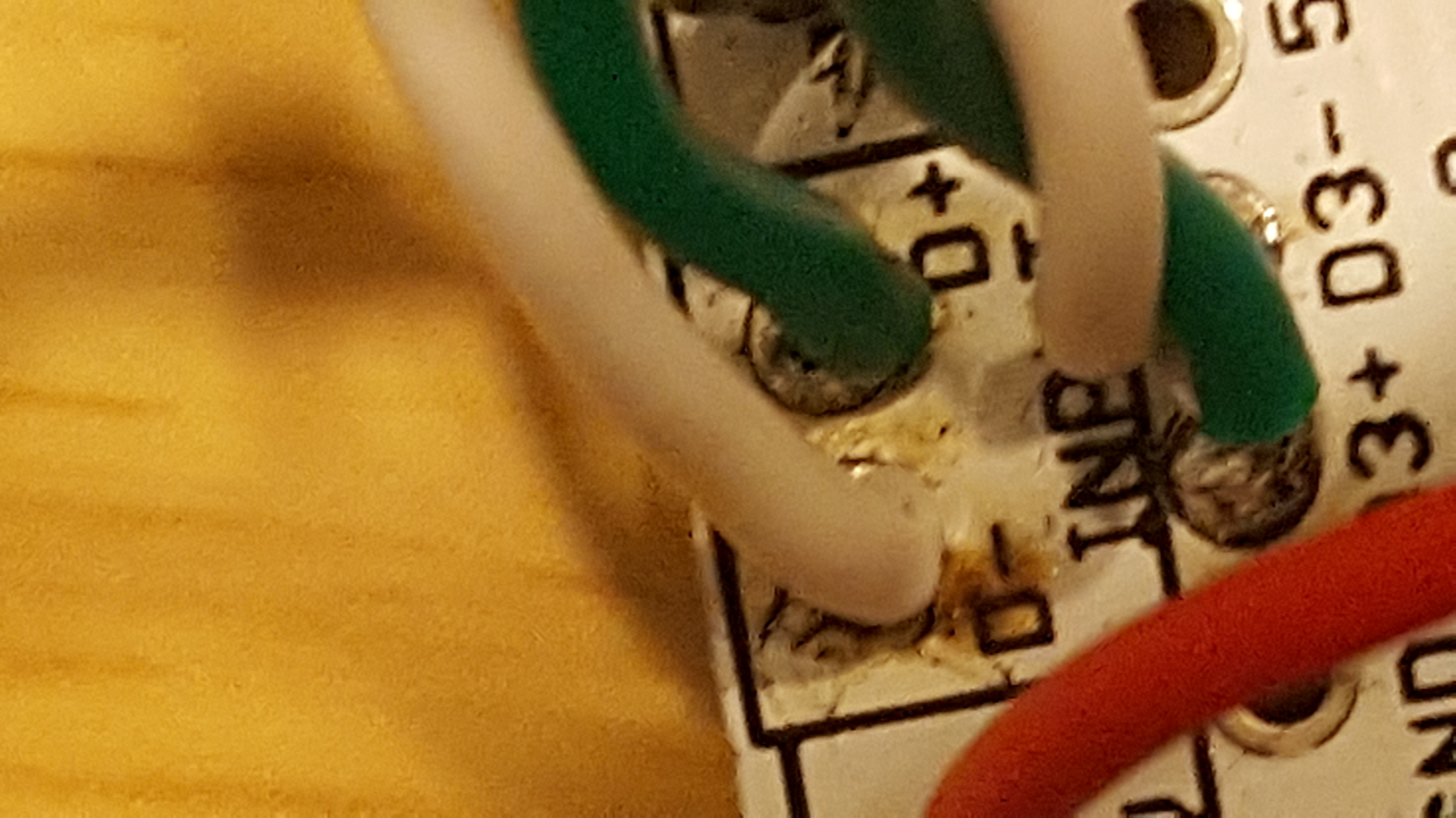

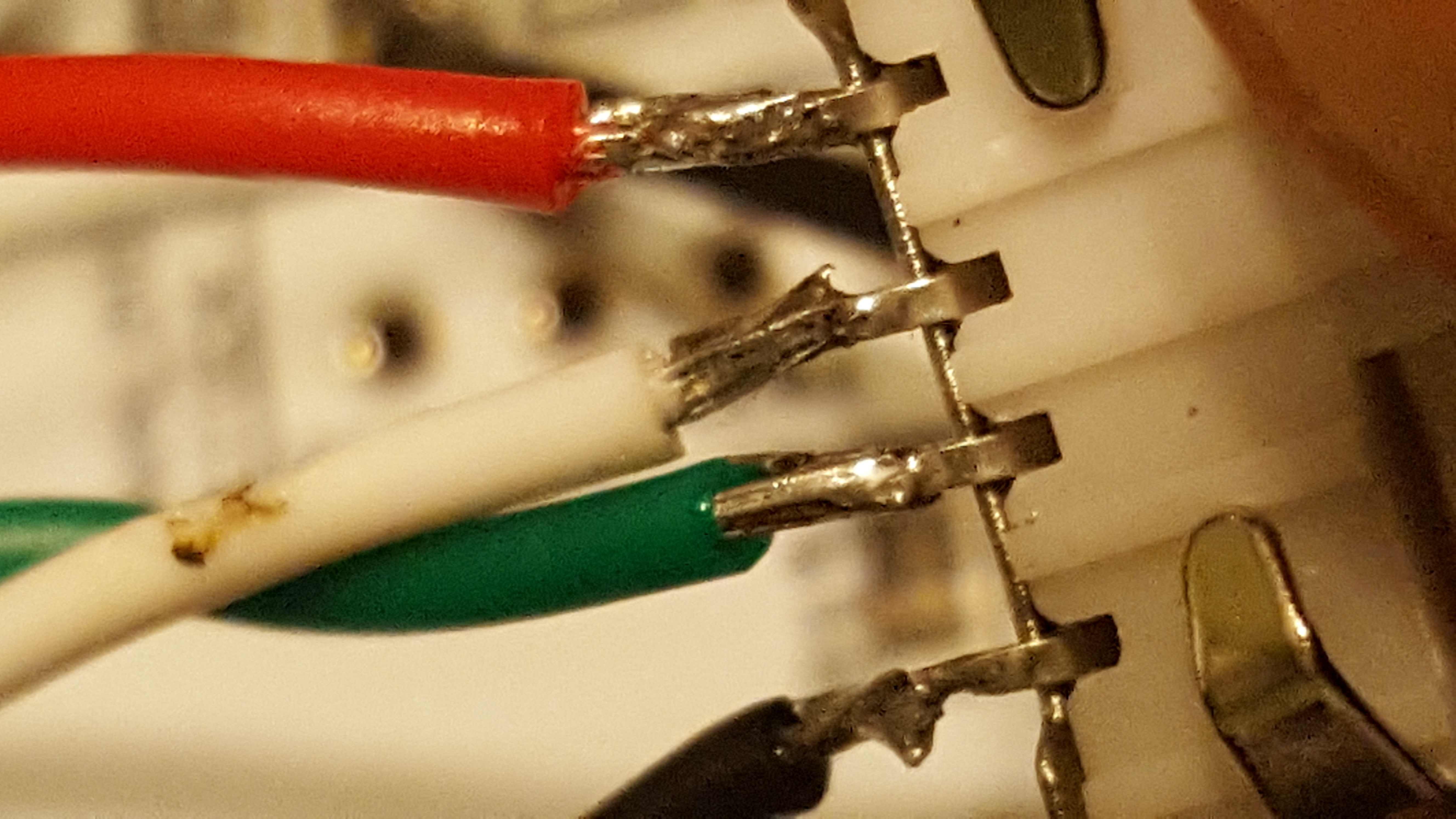

More pictures.
It's also worth mentioning that I used the exact wiring guide that you posted up.

Post by HoolyHoo » Tue Jan 24, 2017 12:48 pm
Make sure the 4 pins on the USB plug that you have bent at 90 degrees are not touching the USB casing. That could be the short that may be causing your problem.
