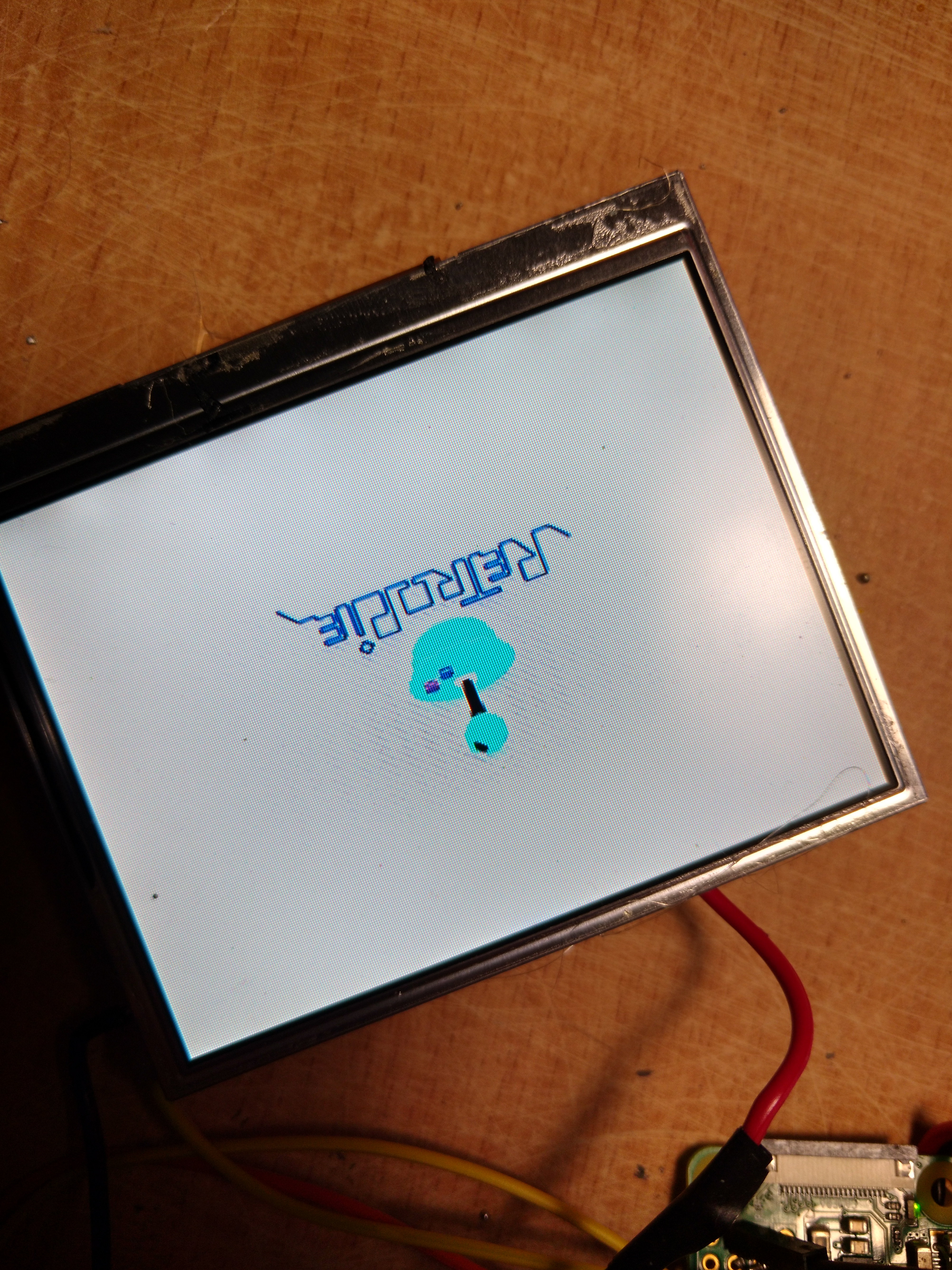

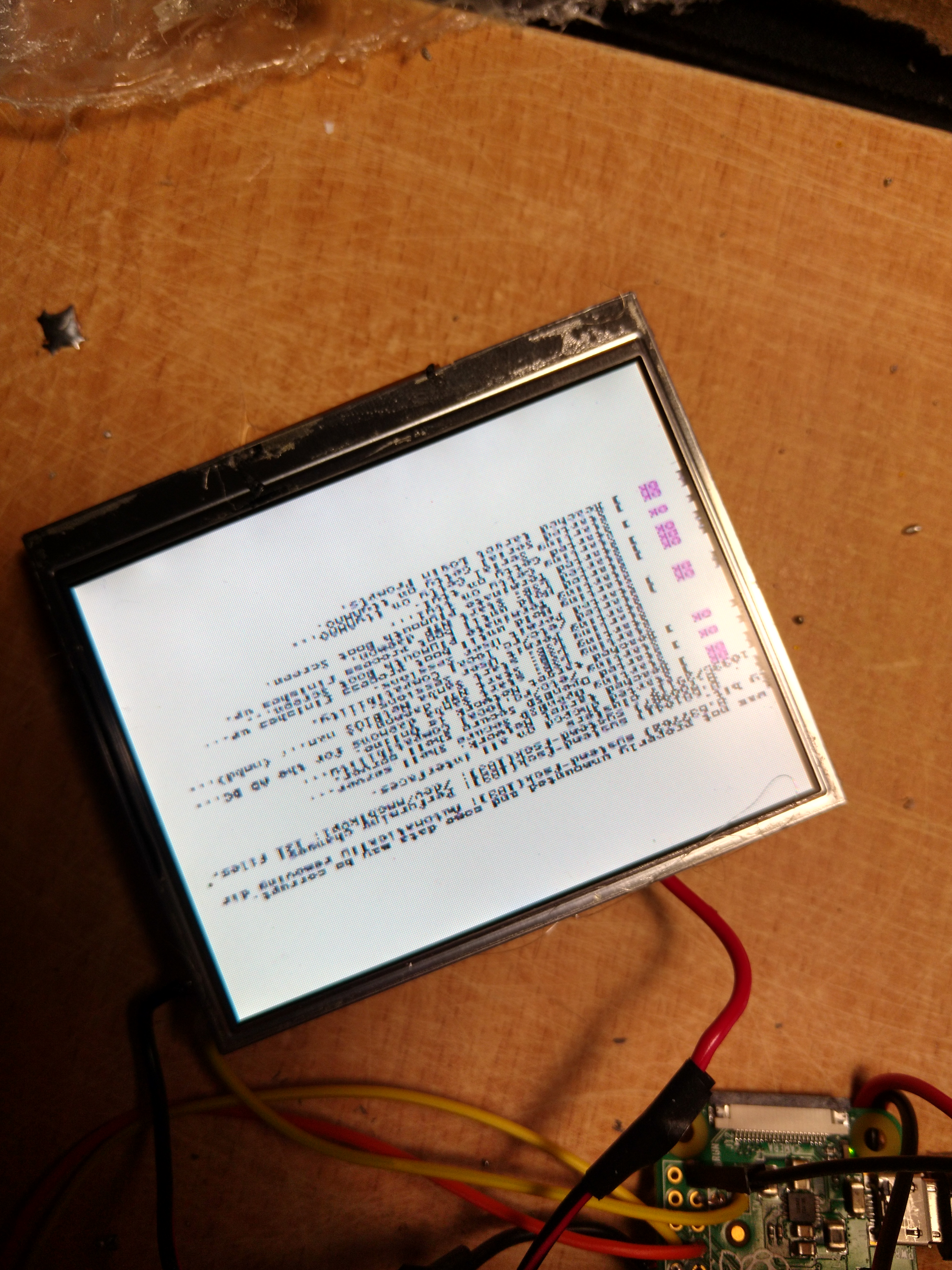

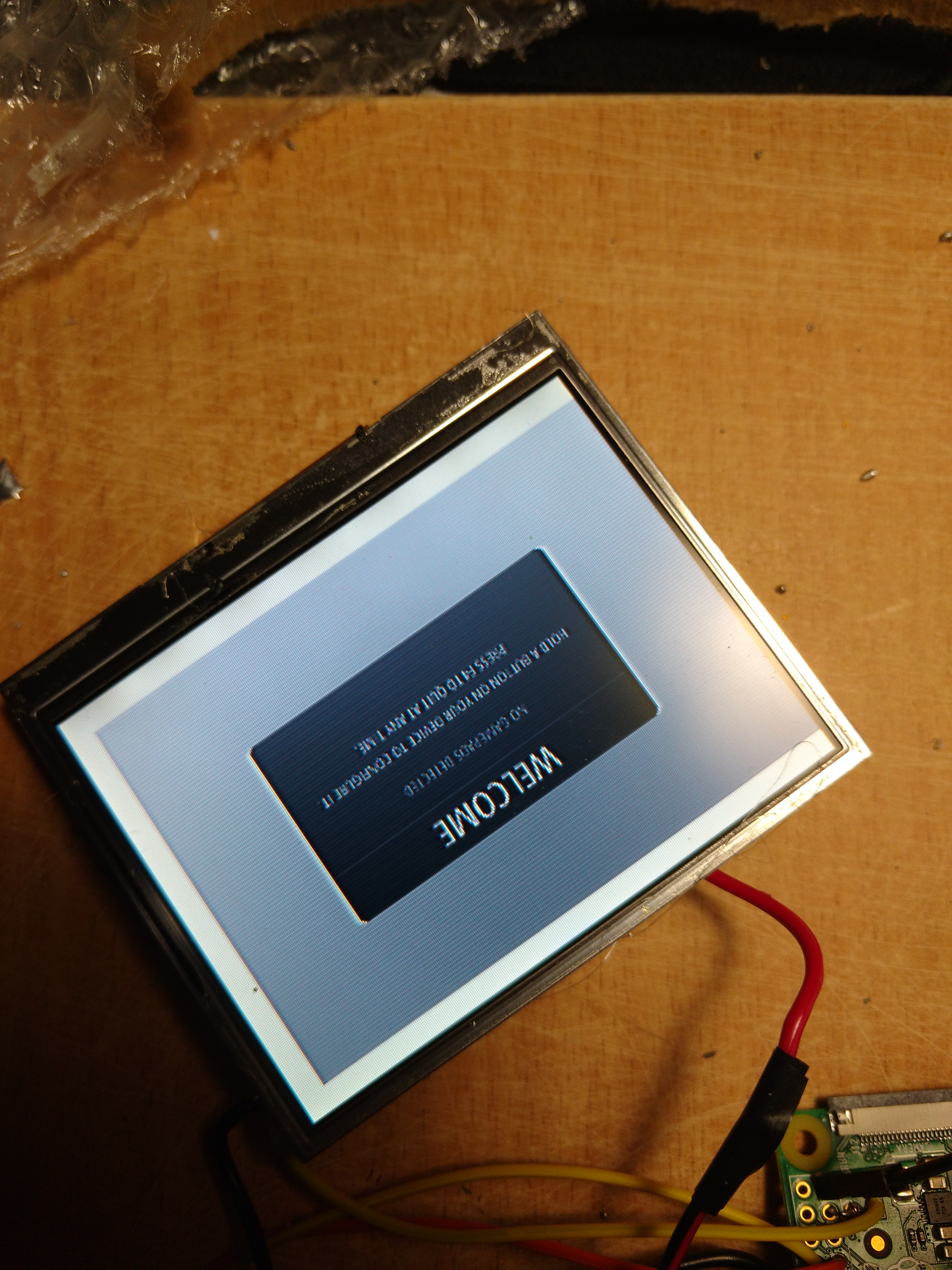

Picture speak for themselves. That's not how the Retropi load up screen should look like.
Any ideas what's going on?

i had the same but it turn out to be a tiny bit of loose solder/wire trim had bridge the tabs on the ribbon cable connector
have a close look at that

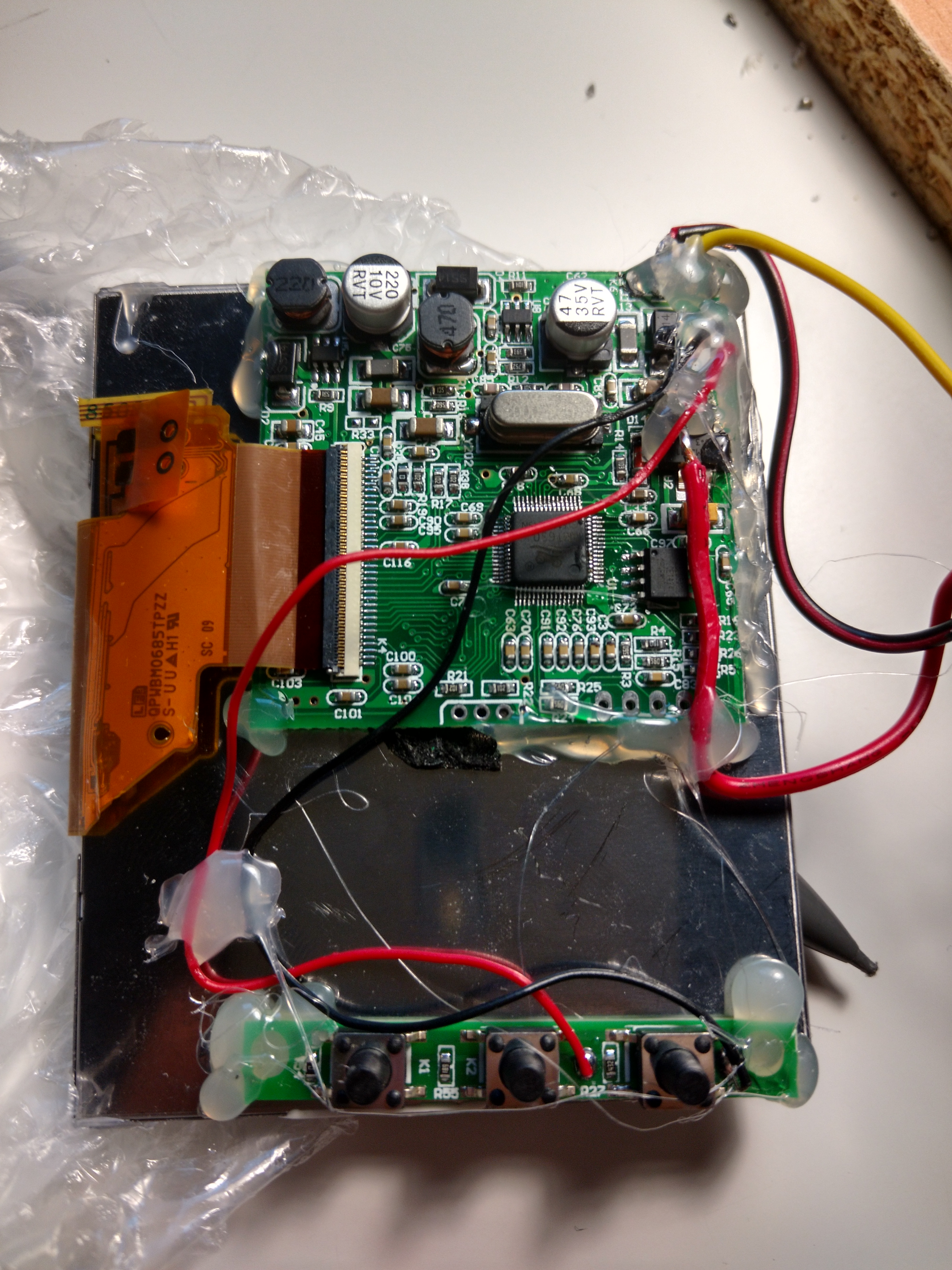

Should I rip off the hot glue and resolder the wires? I don't see anything wrong with my ribbon cable

Did you solve this? How? I have the same issue
MMunera
Posts: 10
Joined: Sun Apr 16, 2017 4:52 pm
Re: Inverted Colored Screen or Broken Screen??
Post by MMunera » Mon May 15, 2017 5:45 pm
I finally solved it. Indeed, it was the ribbon. I discover that if is not completely tensed up when you boot it up the pi the colors starts being inverted and is not possible to put them right when is already on.
So in order to solve it i put some glue tensing the ribbon up always so i can start the system properly :)

Was wondering if you could help me? I have the same screen and looked like I wired everything the same as you did. When I turn it in I only get a white screen. I am lost. Could you please help? Thank you

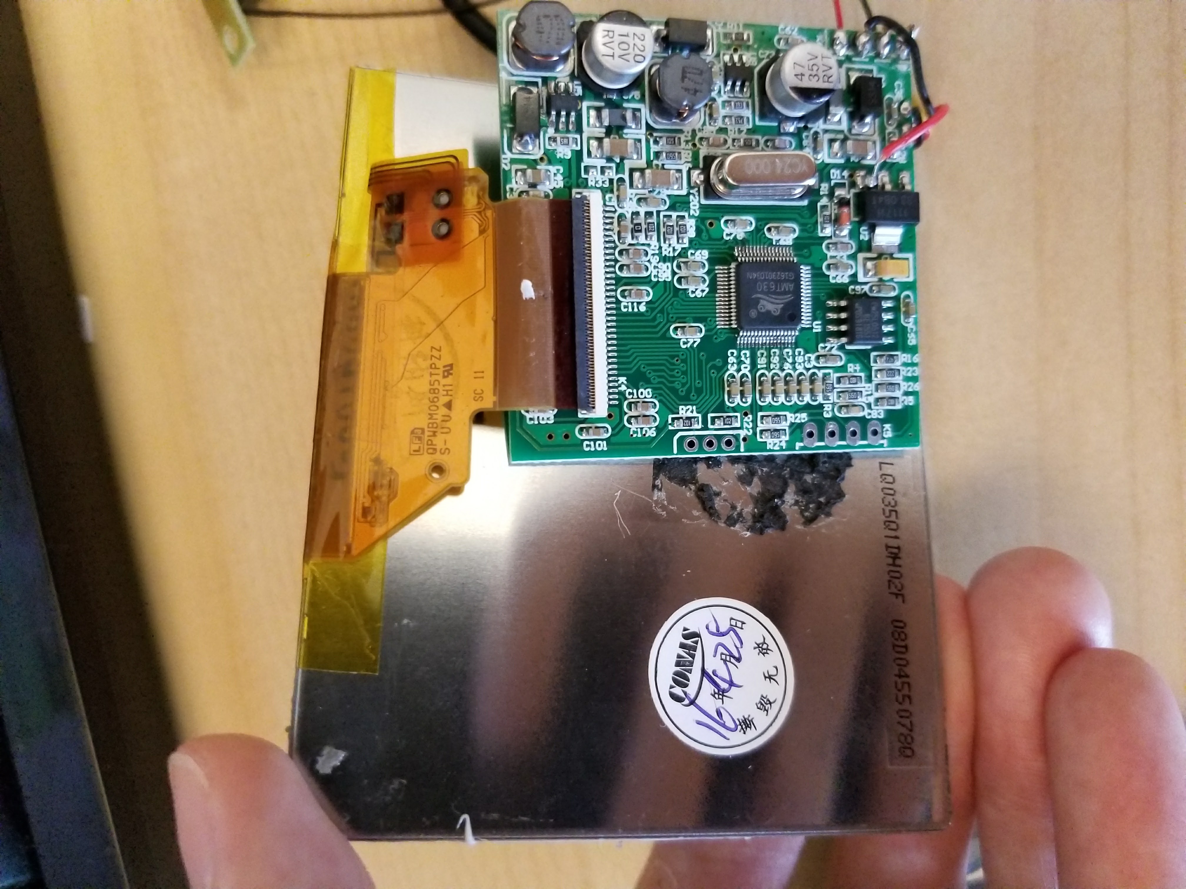

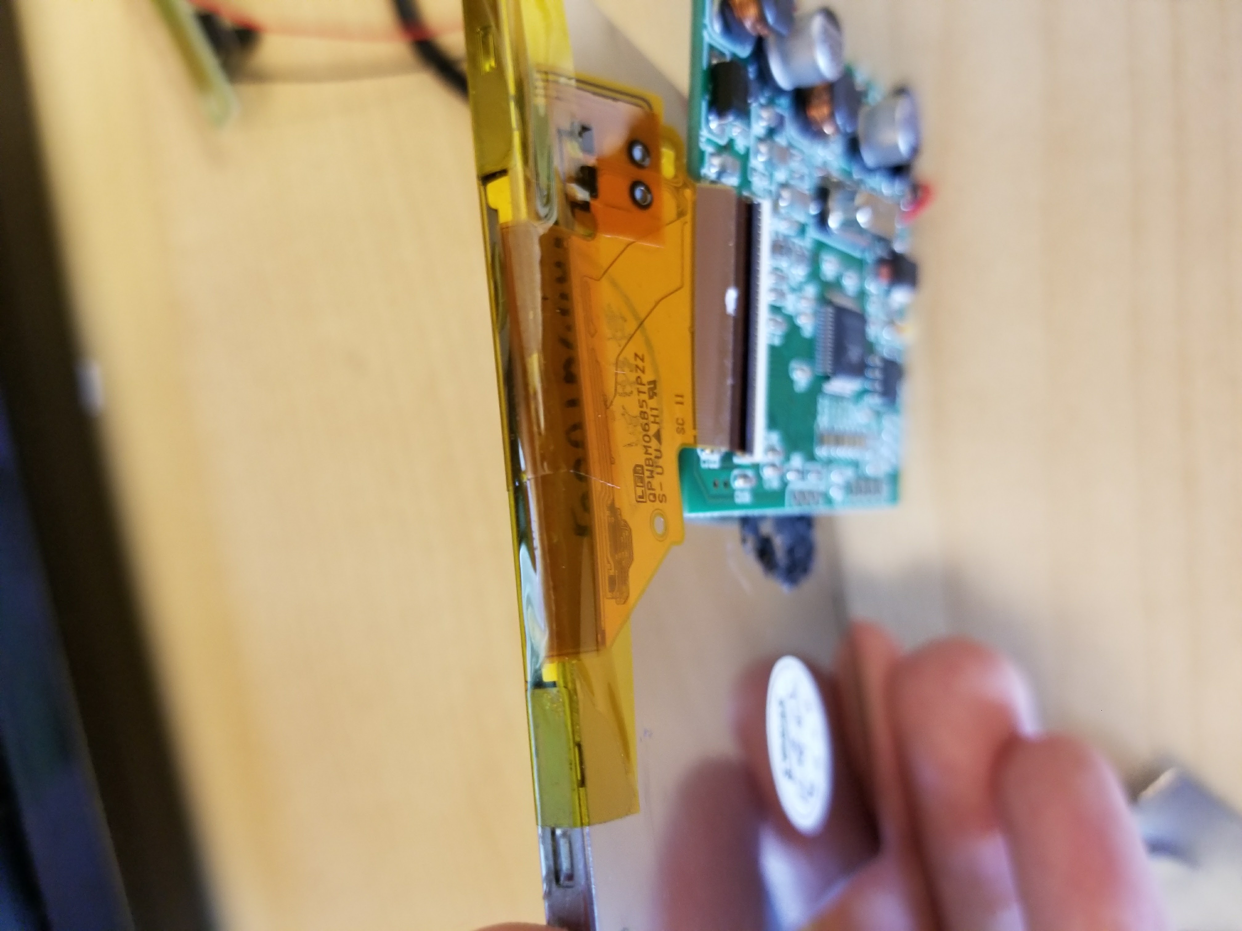

I was having the same issue with this screen, but fixed it by bending the ribbon cable backwards. Try holding the ribbon cable against the metal casing where it meets the screen. Also, the ribbon cable must be held before the Raspberry Pi gets power, or else the colours will be inverted. Here are some pictures of how I taped it so you get the idea.
