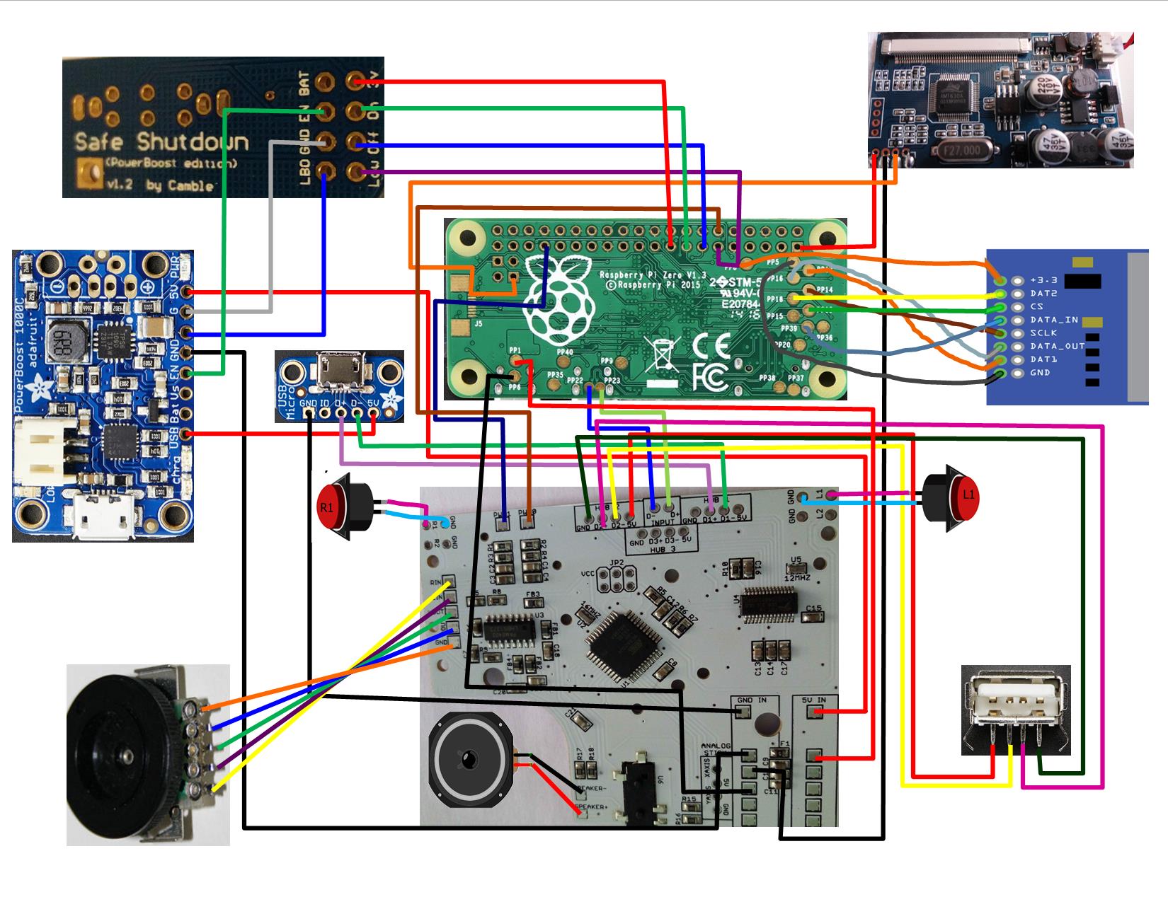

I created this new diagram for Helder's new board and Camble's new Safe Shutdown. Just wondering if this will work before I try it. I am completely new to this, so I am asking for any feedback before I begin my project soon.

I haven't studied your diagram very thoroughly but I did notice that you have data out from one of the usb hub ports going to the micro usb breakout. This is typically used as just a charging port so only needs 5v and gnd to go to the powerboost charging input.

Thanks good to know...Like I said I wasn't sure on everything but now that I look at it more I see that there is no need for the data part.

If you have this all in one board then you don't need the 5v power strip converter ?

Not sure if you went with this in the end, but noticed the screen is connected to the Pi for power. Might be worth using the powerstrip for that instead.

I've just been made aware of this thread. You will need the Bat pin wired up to the PowerBoost for the keep alive to work properly. Other than that, the Safe Shutdown looks fine.
