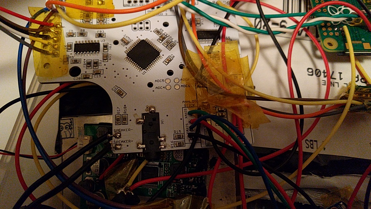

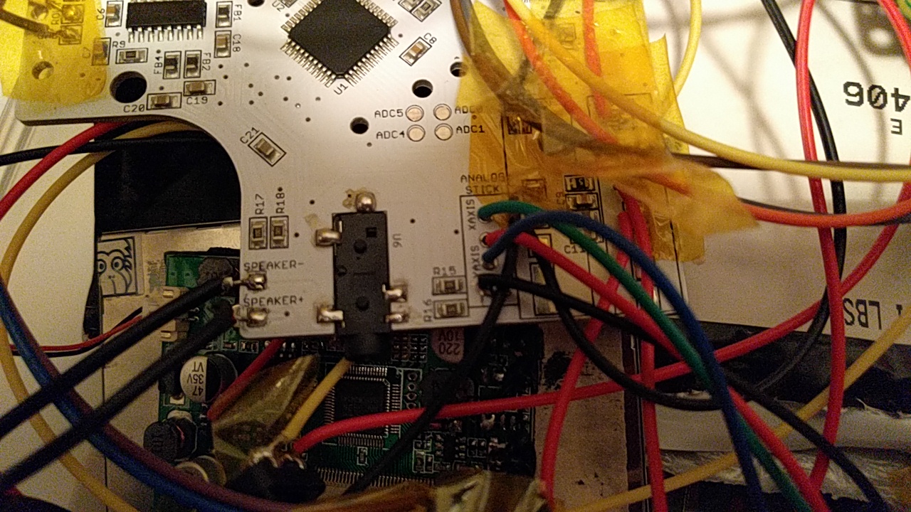

I am almost done with project and i hit the big roadblock. I have audio coming from headphone. I can also use volume wheel to lower it. But speaker doesn't work. It just make tic tic tic noise. I tried 3 different speakers and all volume settings but no luck. I am willing to giveup head phone jack on helder 2.2a board as long as speaker work. Please help.

Go to the support thread in my signature, the answers are there and be sure your headphone socket has 5 pins and not 6 pins. I sent some wrong sockets out and if it's 6pins that could be the issue. Also post pictures of the headphone socket area.

All looks good. I even reflow speaker and headphone connection
